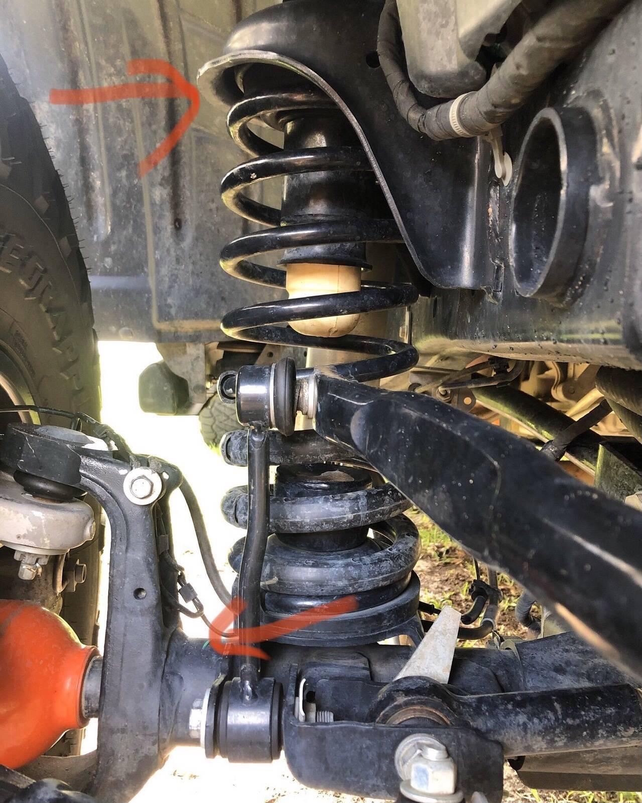

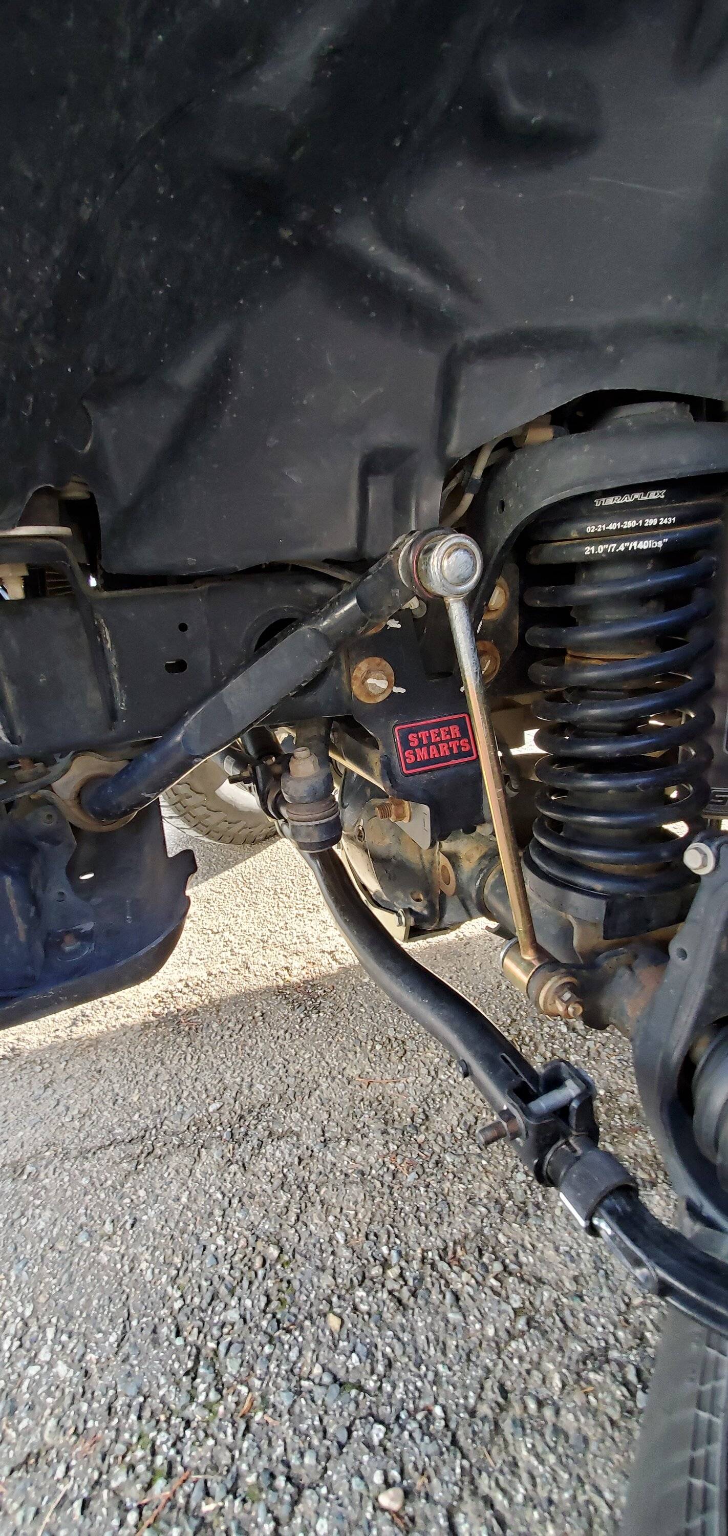

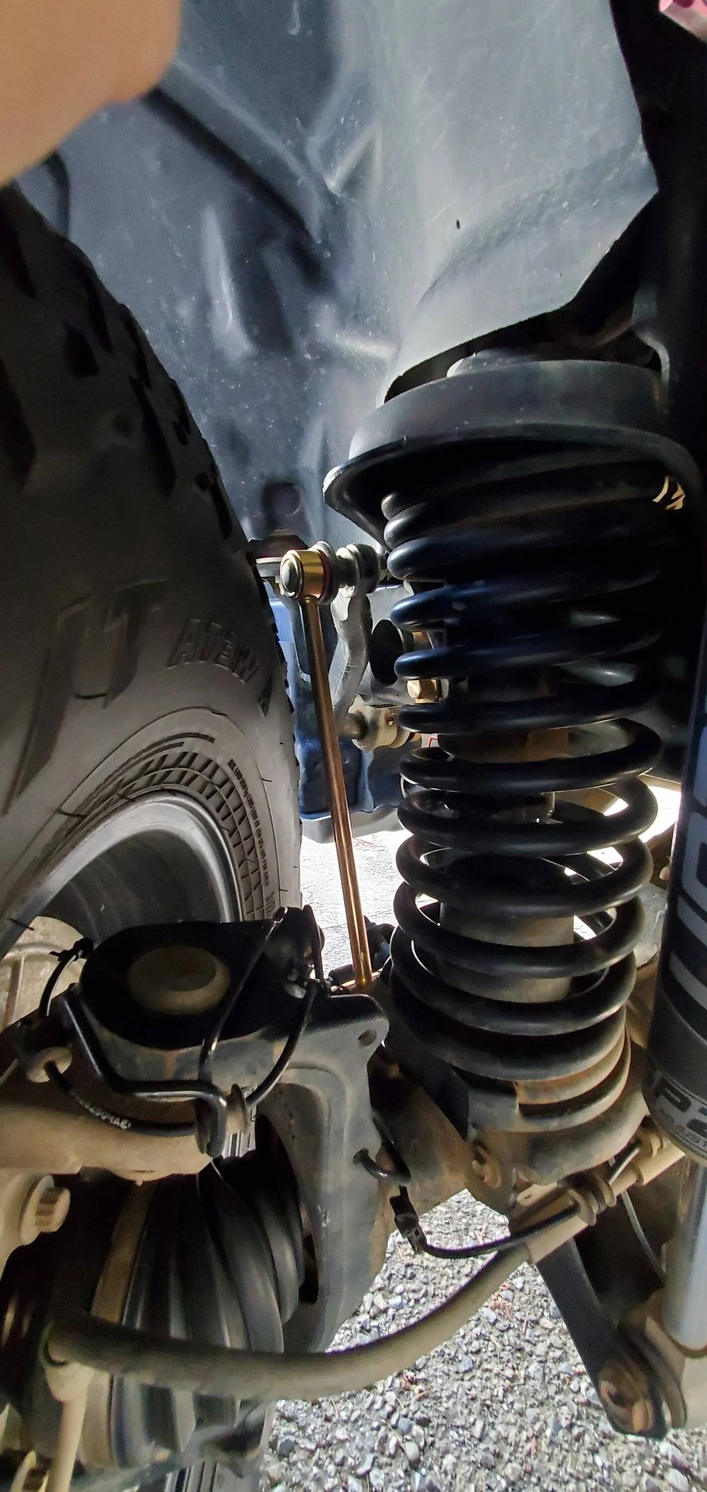

When my lift was done by a shop they didn't install the extension anti sway bar links.
I did this the other day but the bar seems to be riding high.
Is this normal?
Also I get a bit of rub from the tires when aired down and flexing, should this be?

It looks like you don’t have very much lift especially in the second to last picture ? The MC links do run a bit high, but those look excessive…..
MC gamechanger 3.5in

The Metalcloak sway bar links for the 3.5” lift are about 12” long. I have run them on two of my own jeeps and I have several friends that I installed them on and none of us have rubbing issues. They look like they are in the proper position. As far as the rubbing, I would look at a few things. First, Metalcloak recommends a minimum back spacing of 4.5”. What is the back spacing of your current wheels. Next, your springs look a bit bowed to me. Have you confirmed that the axle is properly centered. I am running 38” tires with the same lift and no rubbing.

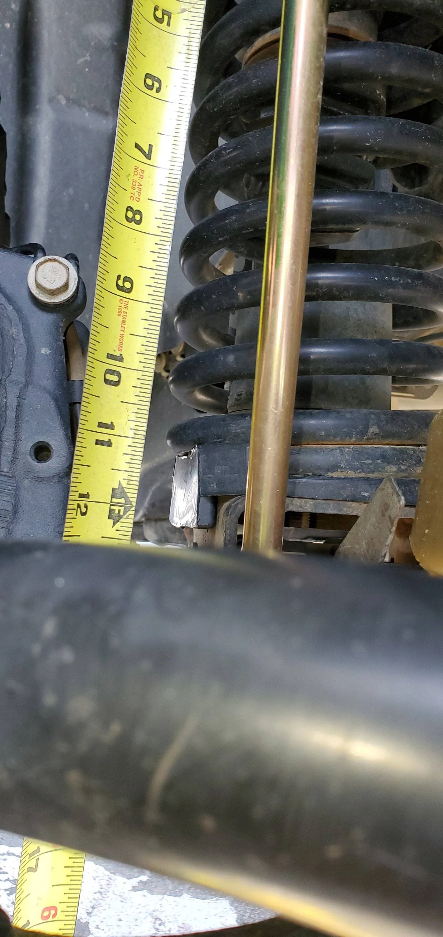

When you get a chance measure from top of axle tube to bottom lip of upper coil bucket like in pic……
Jeep Wrangler JL MC AntiSway Bar extension links IMG_3861

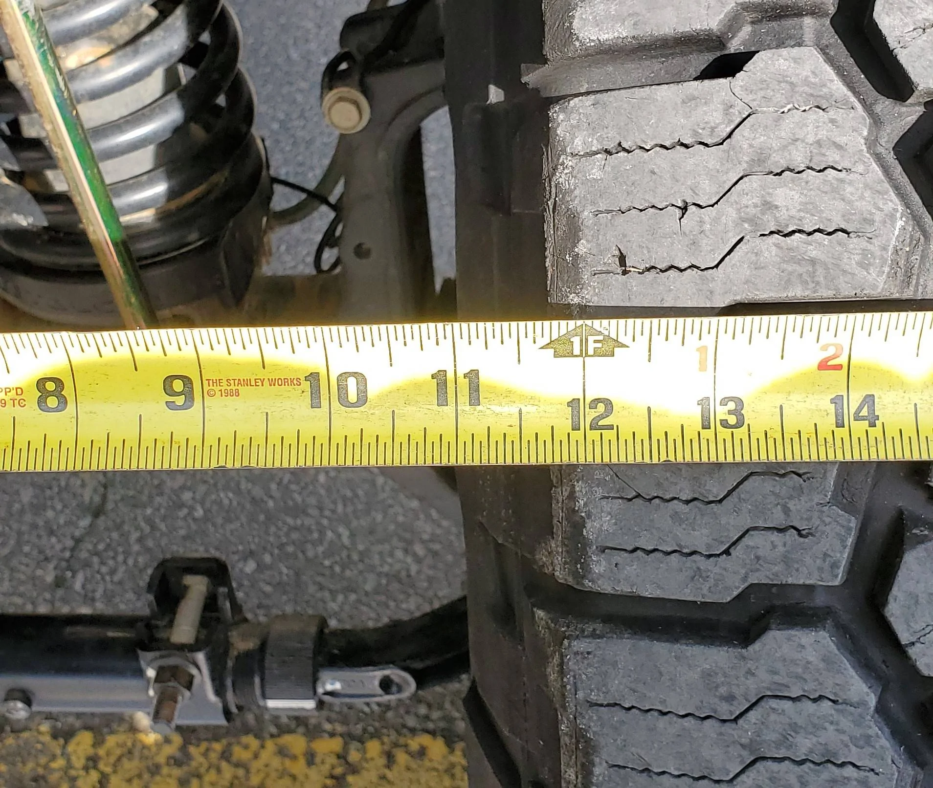

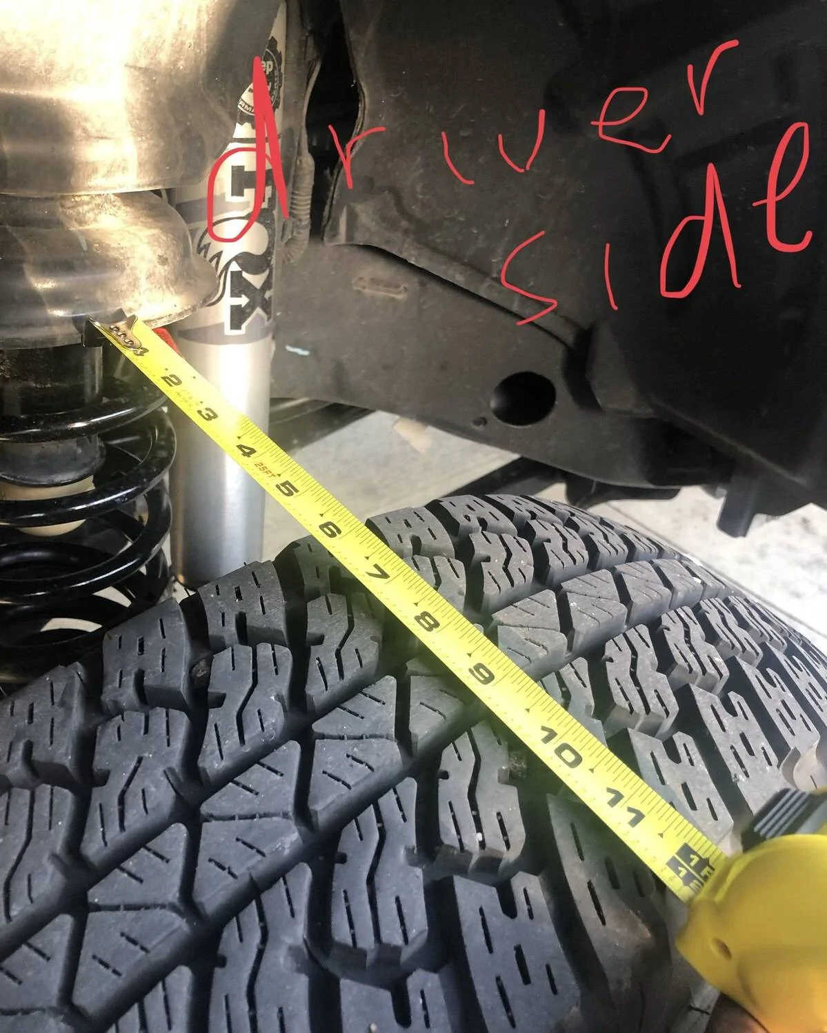

And measure like in pics ( coil bucket to outside lug on tire ), to see if axle is centered…..
Jeep Wrangler JL MC AntiSway Bar extension links IMG_1433
Jeep Wrangler JL MC AntiSway Bar extension links IMG_1434

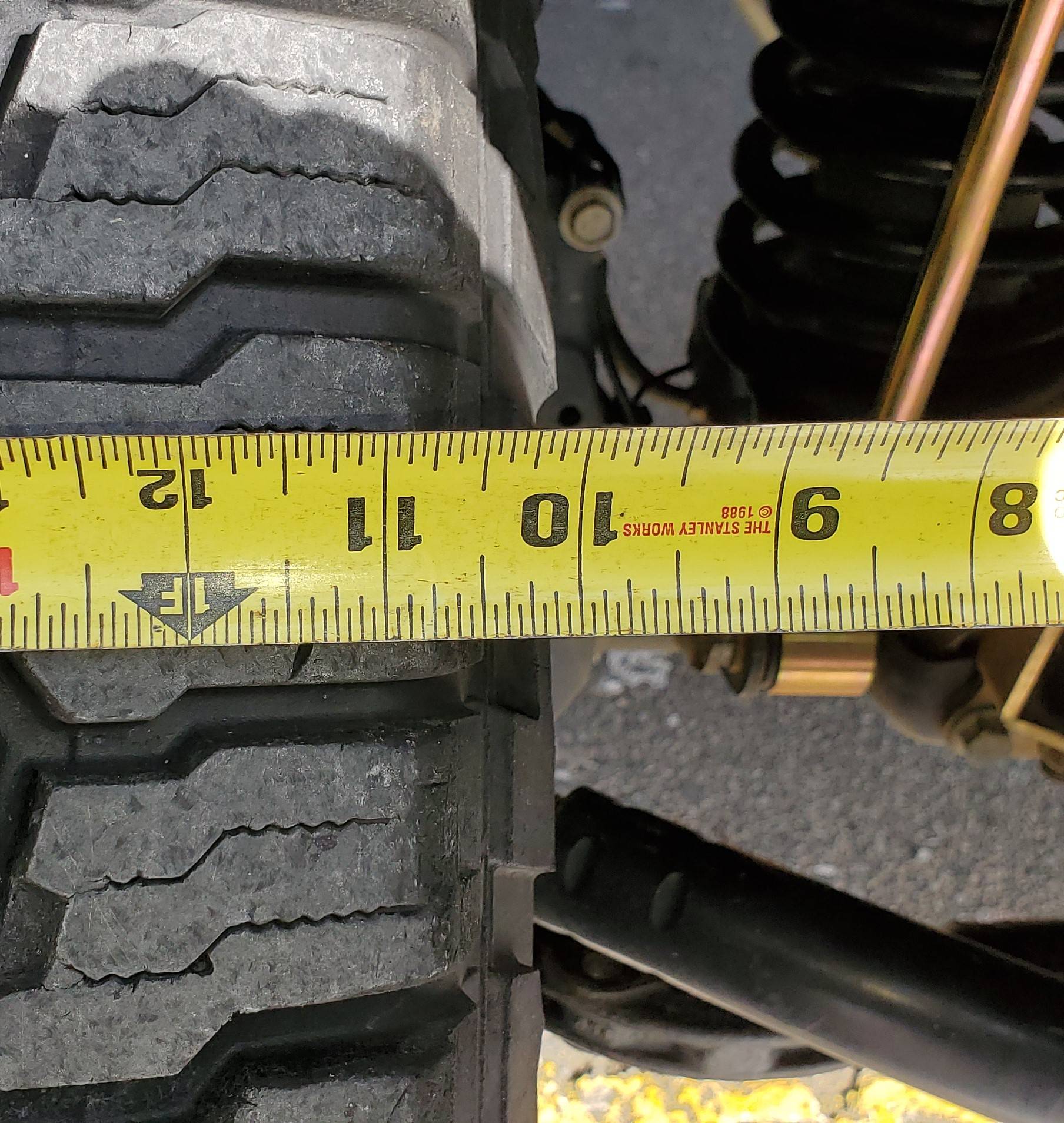

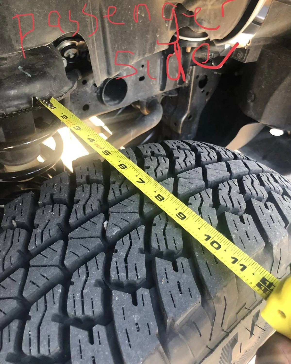

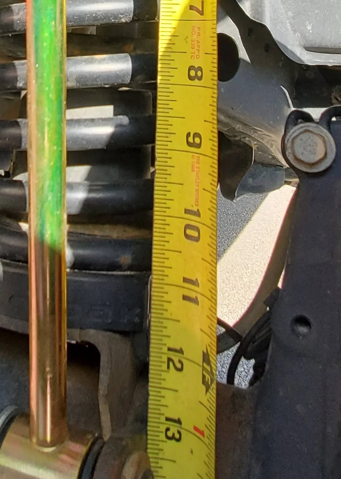

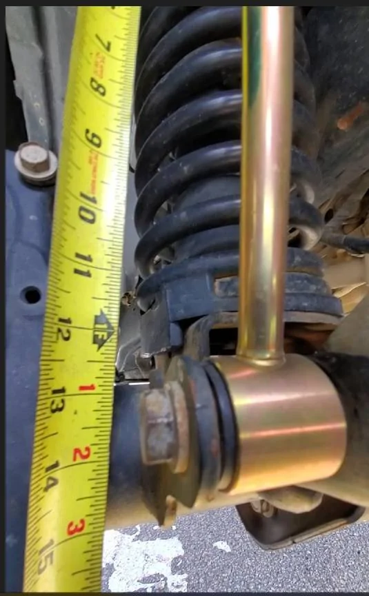

I measured from the upper spring perch to the axle tube both sides, see pic.
Also measured from the frame to the tire lug see pic, tire sit to high to get proper measurement from spring perch.

I'm thinking the axle isn't centred, see pic. unless I'm doing something wrong.
Jeep Wrangler JL MC AntiSway Bar extension links Frame to tire driver
Jeep Wrangler JL MC AntiSway Bar extension links Frame to tire passanger

There’s a couple answers in those pics….MC end links are to long because you got around 2” of lift, not 3.5” and your axle looks to be shifted to driver……

Is there a better way that I can measure axle centred?
I'm thinking the antisway bar end links are rubbing the same on each side. If the axle wasn't centred wouldn't they rub more on one side?
