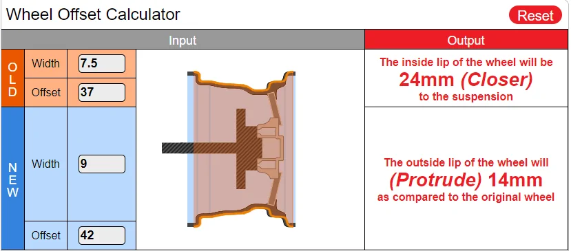

So if I have a 286/70R17 (33" tire) with a 17x7.5" rim with 37 Offset.
And I go with a 35/12.5R17 (35" tire) with a 17x9" I would have to go with a 42 Offset to keep my scrub radius?
Is this correct ?

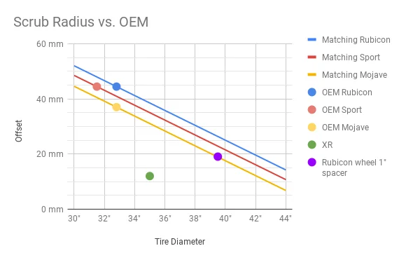

You're going the wrong direction to maintain scrub radius.
Increasing tire radius moves the intersection of the steering axis and the ground outward. Increasing positive offset moves the center of the tire inward.
Stock offset is ~44.5mm
Assuming 12 degree steering axis, adding 1" (25.4 mm) of tire radius, you would need to reduce offset by Tan(12)*25.4=5.4mm. So around a 39mm offset.
Or you can use @AnnDee4444 's spreadsheet here, he's got it calc'd out in one of the tabs:
https://www.jlwranglerforums.com/fo...gs-suspension-information-chart-matrix.66591/

Sorry about that, you would need to subtract 5 to maintain stock scrub radius. @GATORB8 nailed it in his post.
But @Discount Tire is pointing out the tire you've picked is physically an inch or more wider. Let's call it 1.5 inches. Half goes inward and half goes outward, so call it .75 inch. Moving the tire out 5mm (by subtracting from stock offset) is less than a quarter inch. So the edge of the tire will move up an inch and also inward .5 inch. Do you have that much clearance?

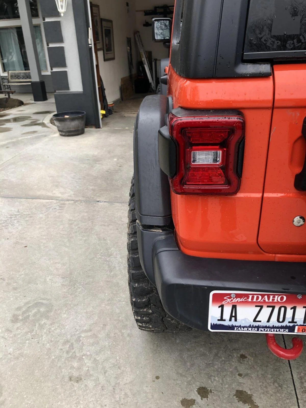

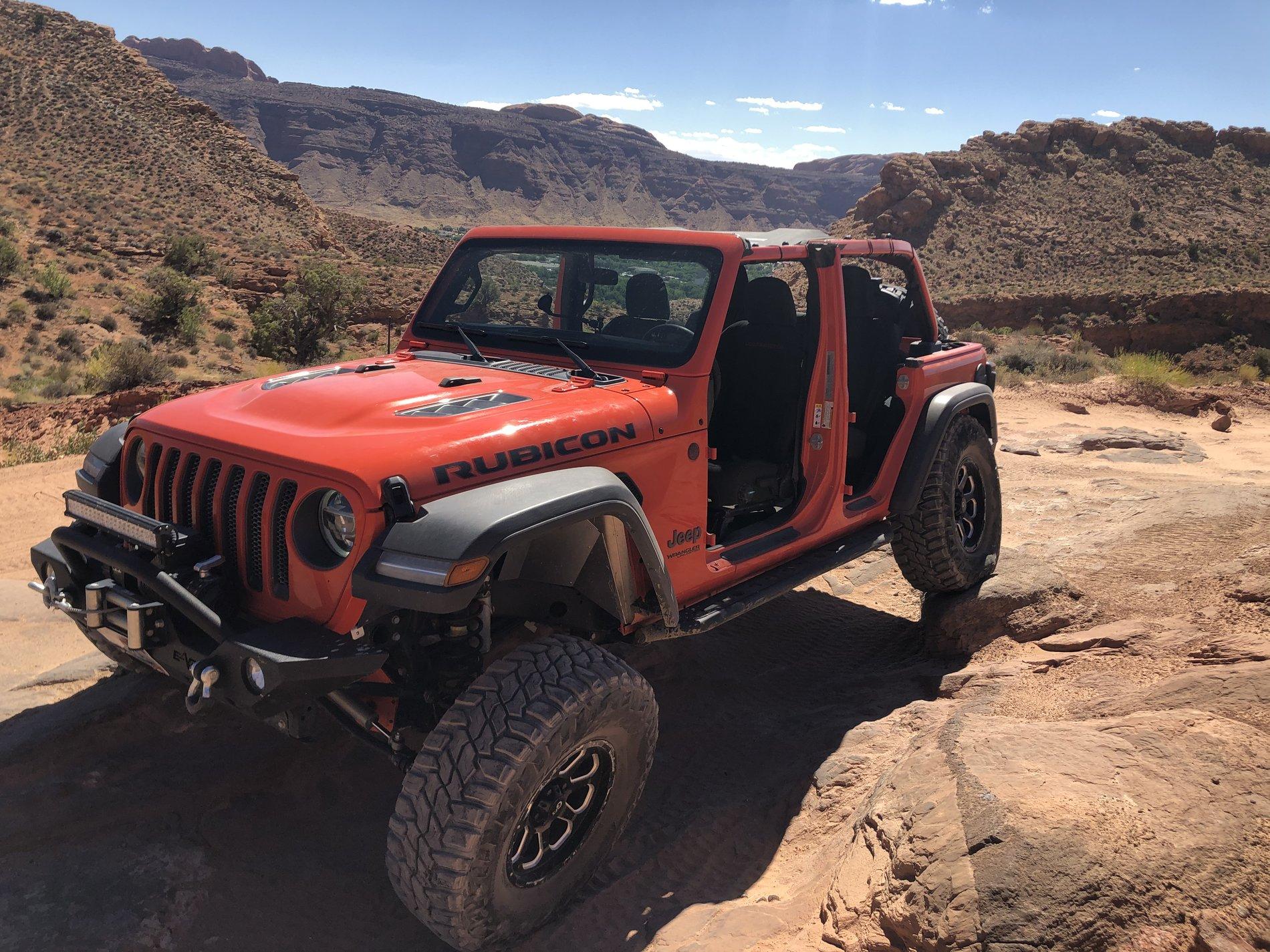

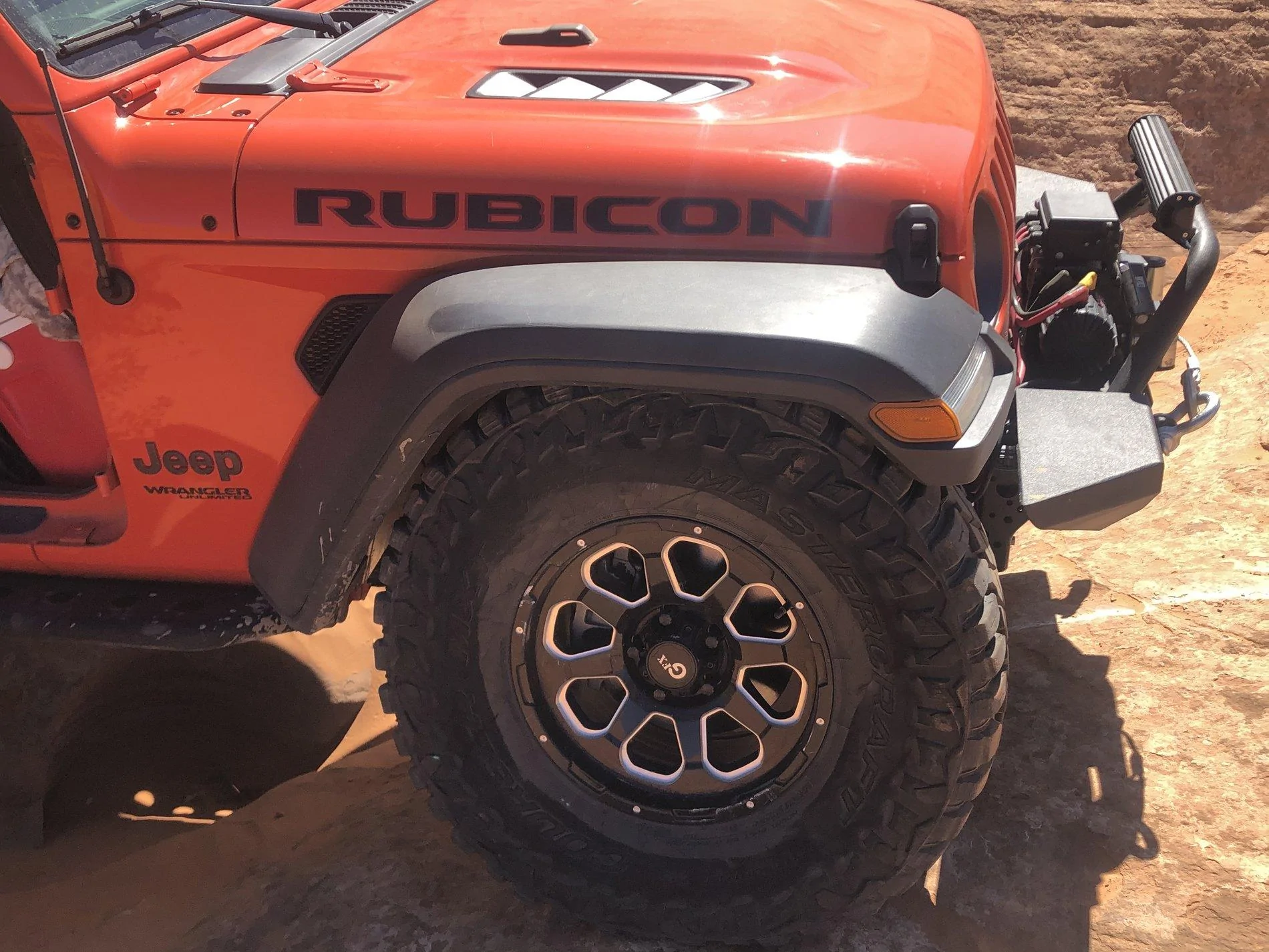

[*]JL Model: JLUR
[*]Wheel: gfx tr 10
[*]Offset: +12
[*]Backspacing: ~5.5
[*]Tire Make: mastercraft courser mxt
[*]Tire Size: 37 12.5 17
[*]Lift: mopar 2.5-3
[*]Rubbing: super mild on inner fenders when off roading. Not enough to be bothersome
[*]Pictures:

Jerrybizzle
Jerry
Aug 28, 2018
330
291
Idaho
2019 JLUR
Tech
@Jerrybizzle - I love this setup and I was looking to get either the AEV JL spec wheels or an aftermarket 17x9 +12 wheel for 37s KO2 C-rated (on my 24 JLUR 4xe)
Did you have any suspension component (LCA, sway bar) rub off-road on 37s on these wheels? The AEV JL spec wheels are 5.7 backspace and there is mixed opinions on it rubbing on some tires and not on others. Wondering what your experience was and if you had to adjust steering stops to prevent rub on the control arms at full turn when sway bar disconnected?
On my second set of +12 9 wide wheels (rocktrix) now and still have no issues. Running a different lift that is more flexy (rk springs and shocks) than the mopar and I do rub the front inner fender wells at times, but nothing bad enough to be concerning. I need to change my front bump stops, as when fully stuffed I hit my fenders, but the offset is not the issue there. Good luck with your decision.
