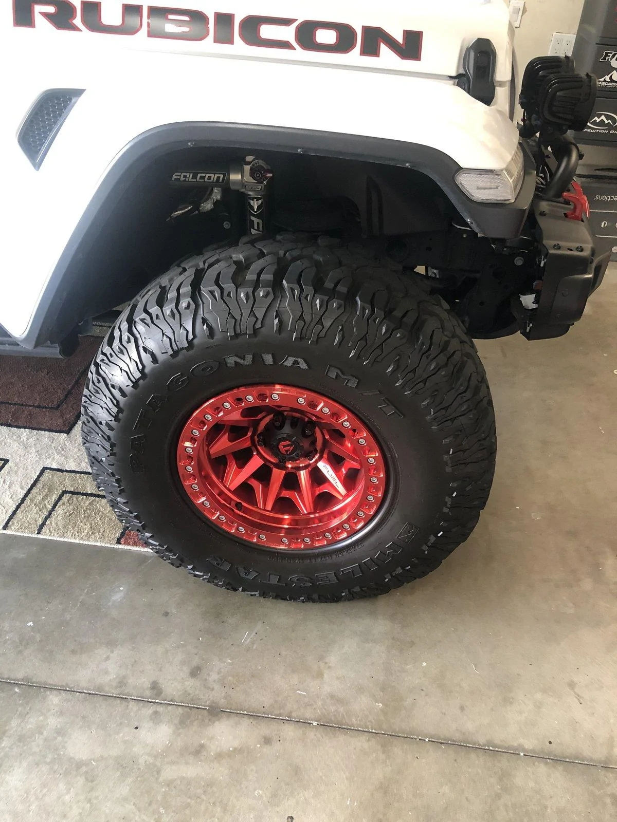

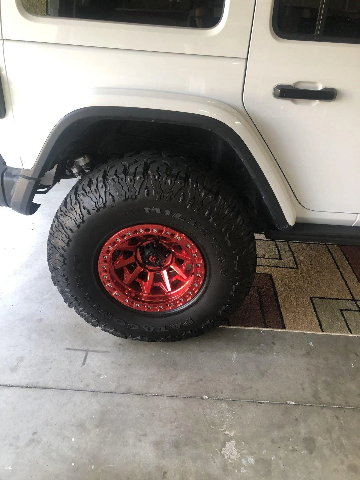

Clear fine now that I have the lift on

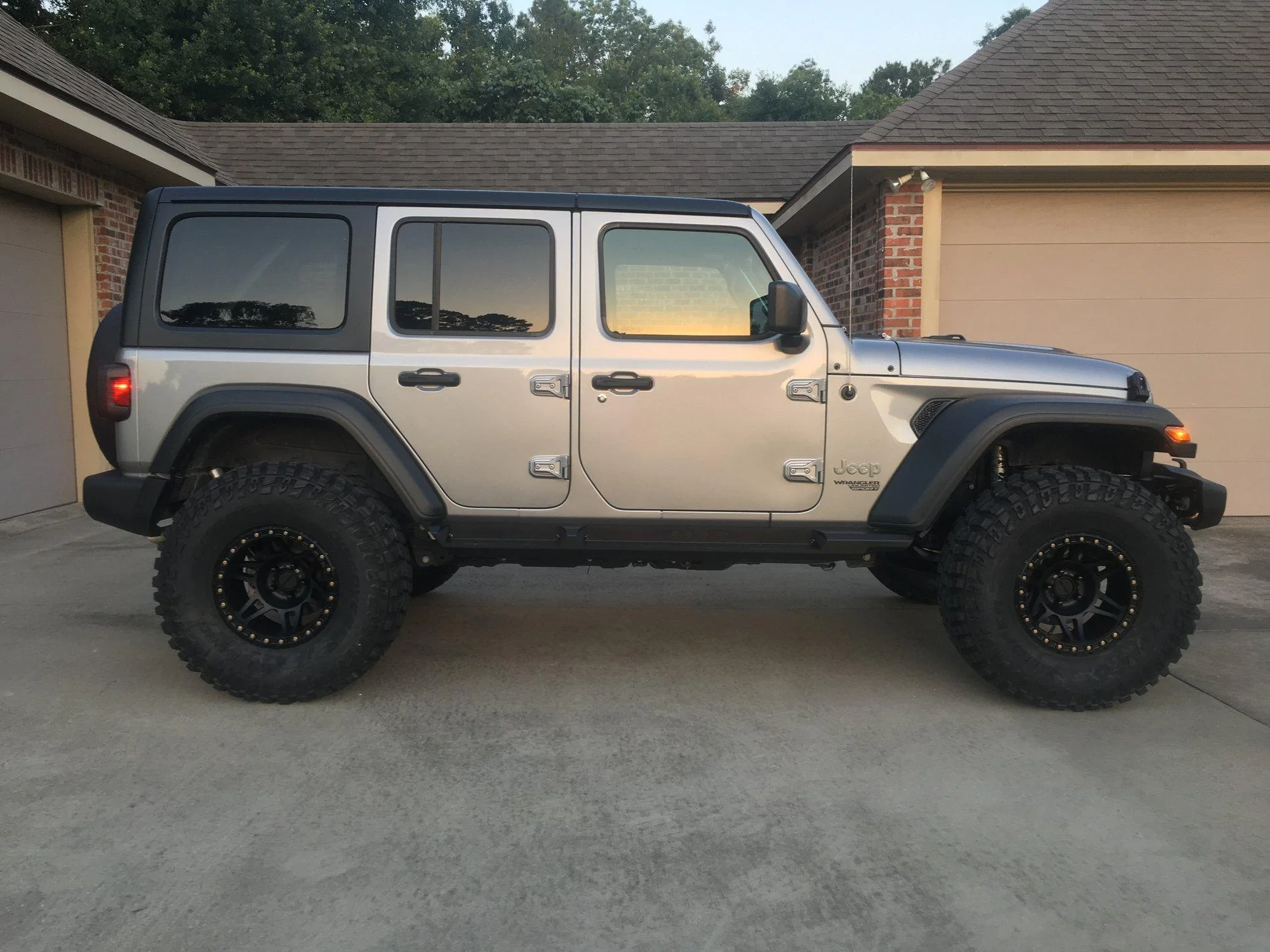

Nice wheels I'm looking for -44 offset for my Wrangler but are concerned about sticking out too much, what's the offset on yours, -18 or -44?

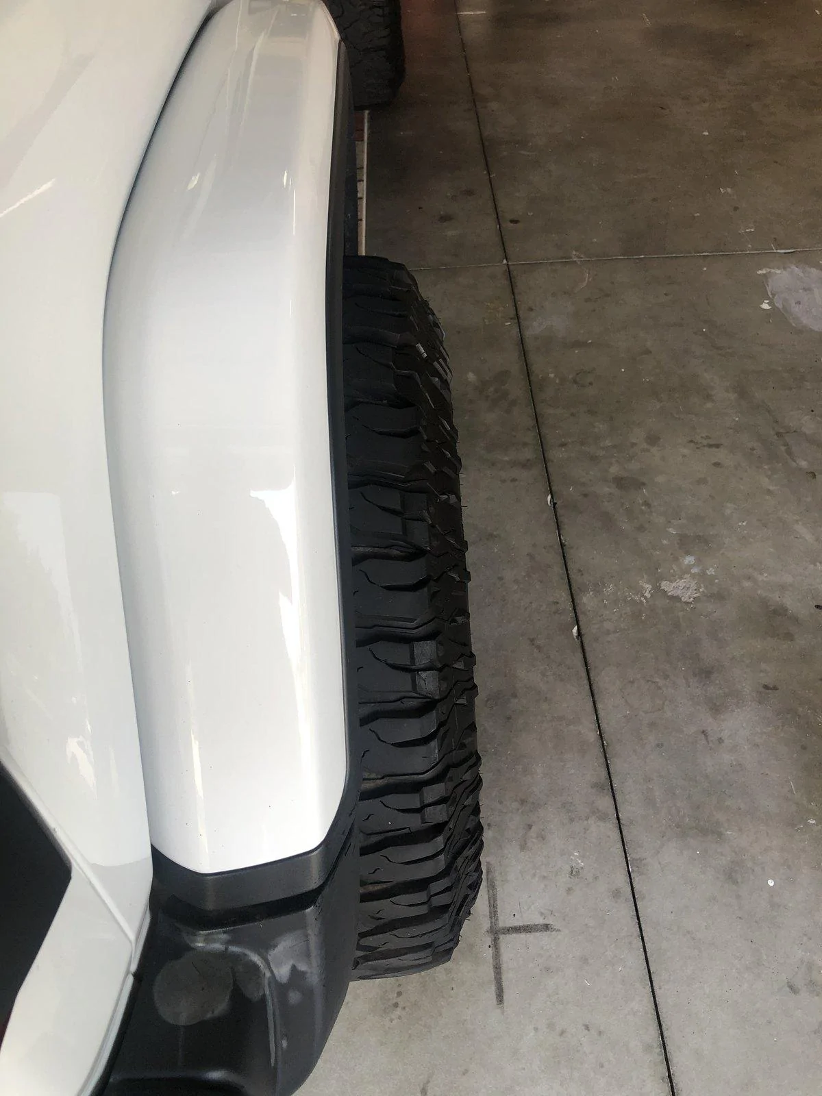

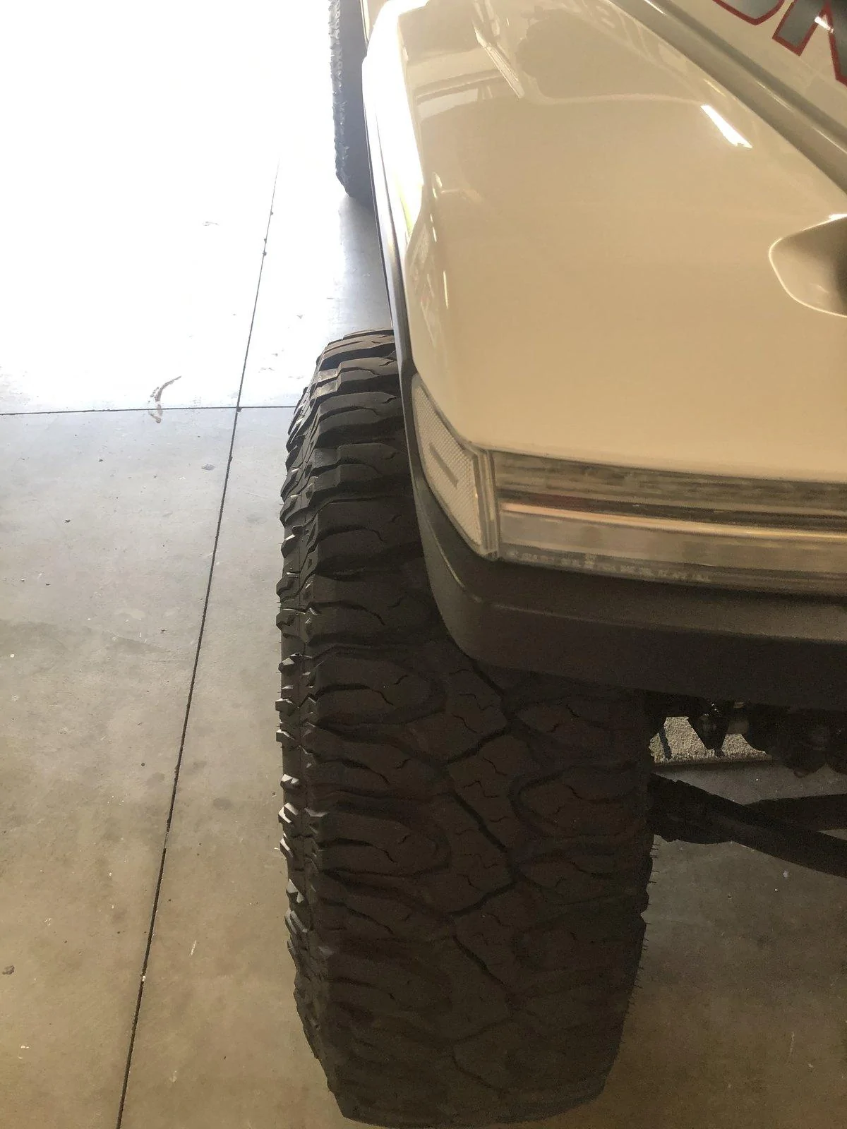

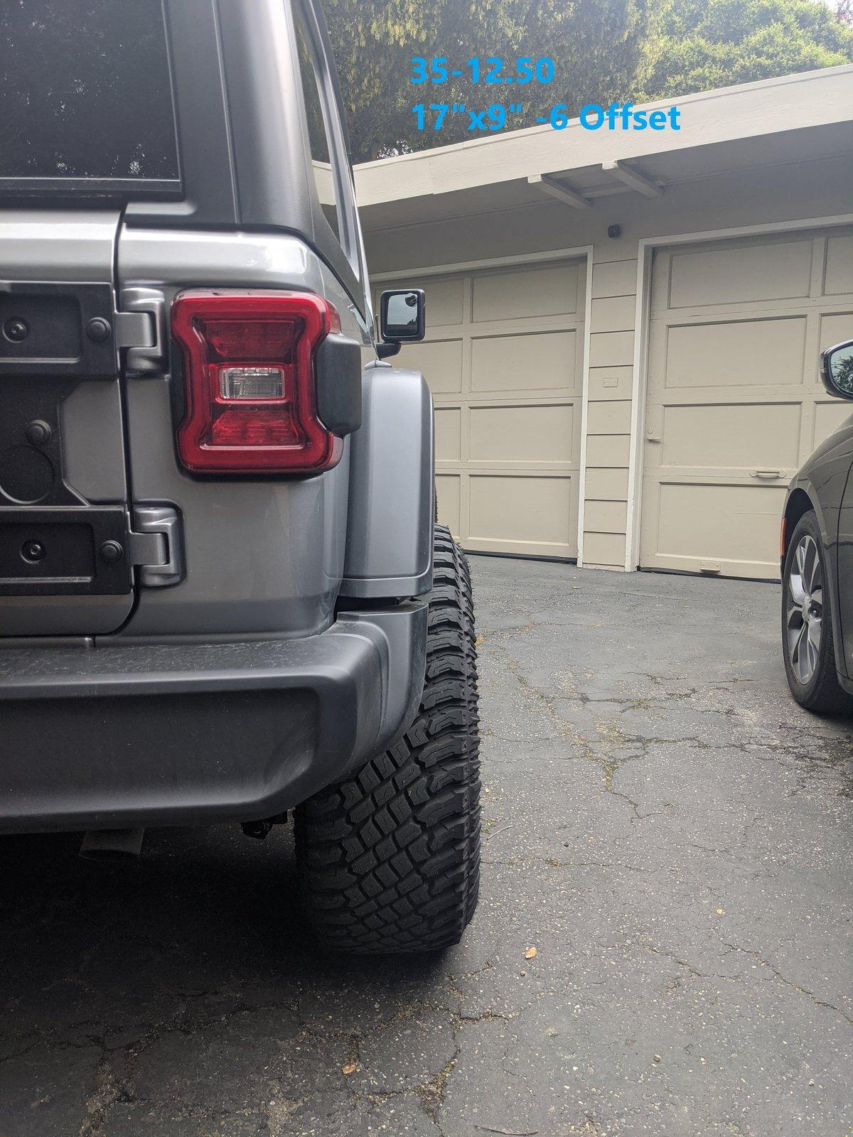

I have -6 offset on 9" rims with 35/12.50s and although I like the look of my rims, I really don't like how the tires stick out. Also, I went through a little mud puddle the other day (not fast) and the whole side of the Jeep was sprayed. I couldn't take it anymore so last night I ordered some AEV +25 offset wheels. I don't love the way they look, but from the pictures I have seen on this forum, they seem to do a good job of bringing the tires back in. From the calculator that I found online (https://tiresize.com/wheel-offset-calculator/), it seems like they will bring the inner wall of the tire to almost exactly where the stock tire would be. Also, they use the stock lug nuts and were designed with our back-up camera in mind. My current wheels get in the way of the camera a bit, not too bad though. AEV is having a sale, buy 4 get one free, I think it is only good until the 9th. Northridge Offroad is where I ordered them from. Good Luck

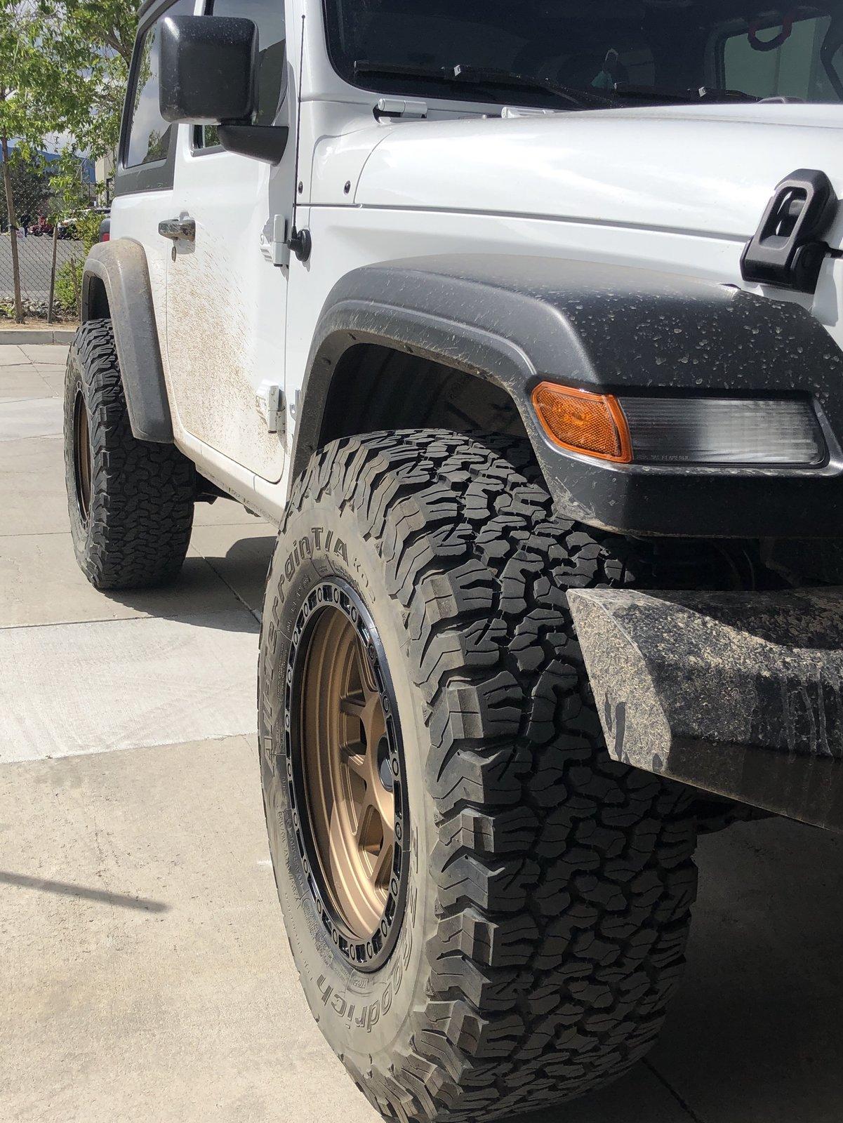

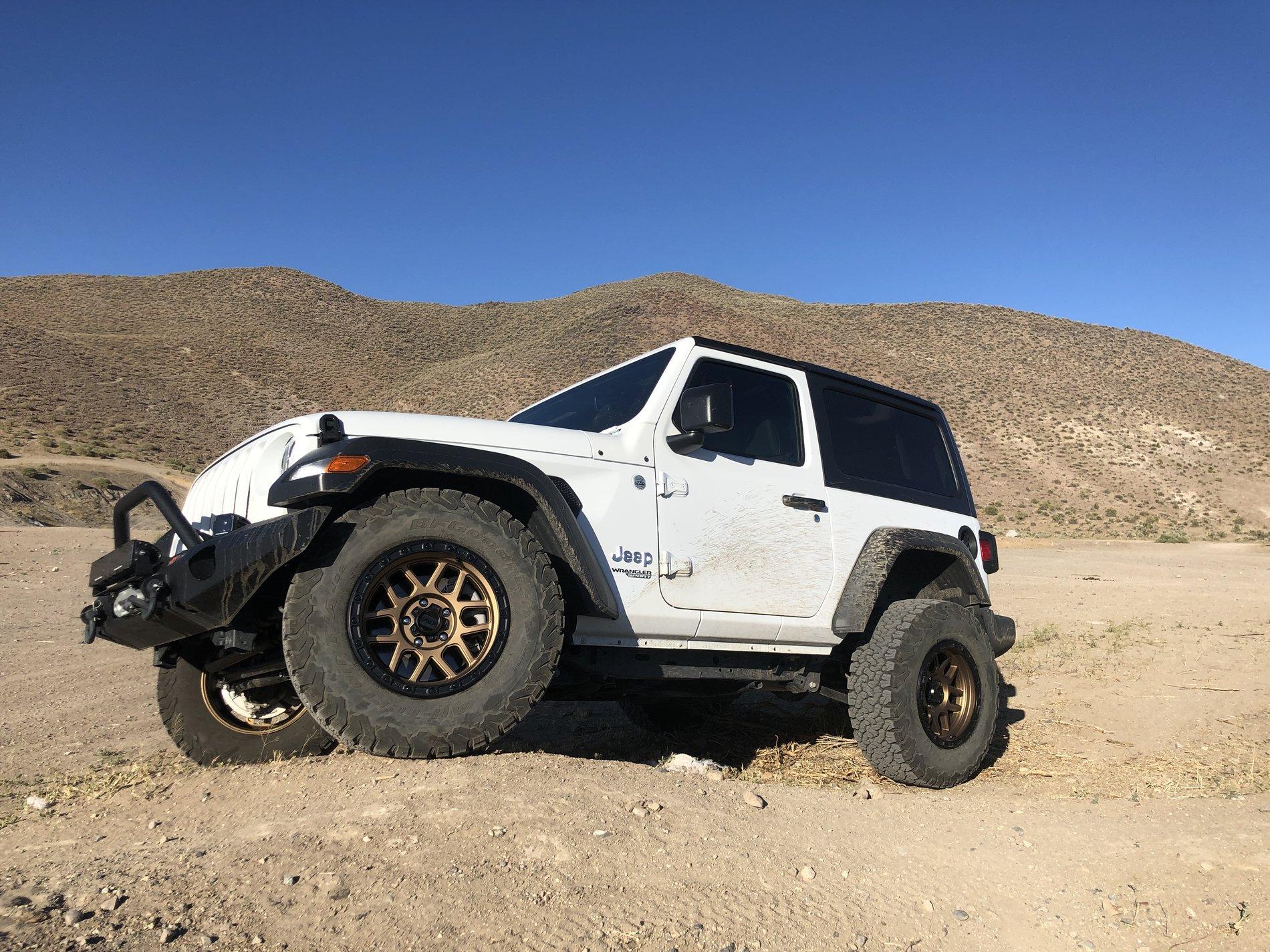

Been looking at all the posts for best offset, I eventually went with -12offset. Got them from tire rack KMC KM544 Mesa 17x9 -12mm offset. All stock no lift (yet). But some major rubbing on the rear when you flex it out, but it's all clear in the front lock to lock; but forgot to check when it's full flexed.
