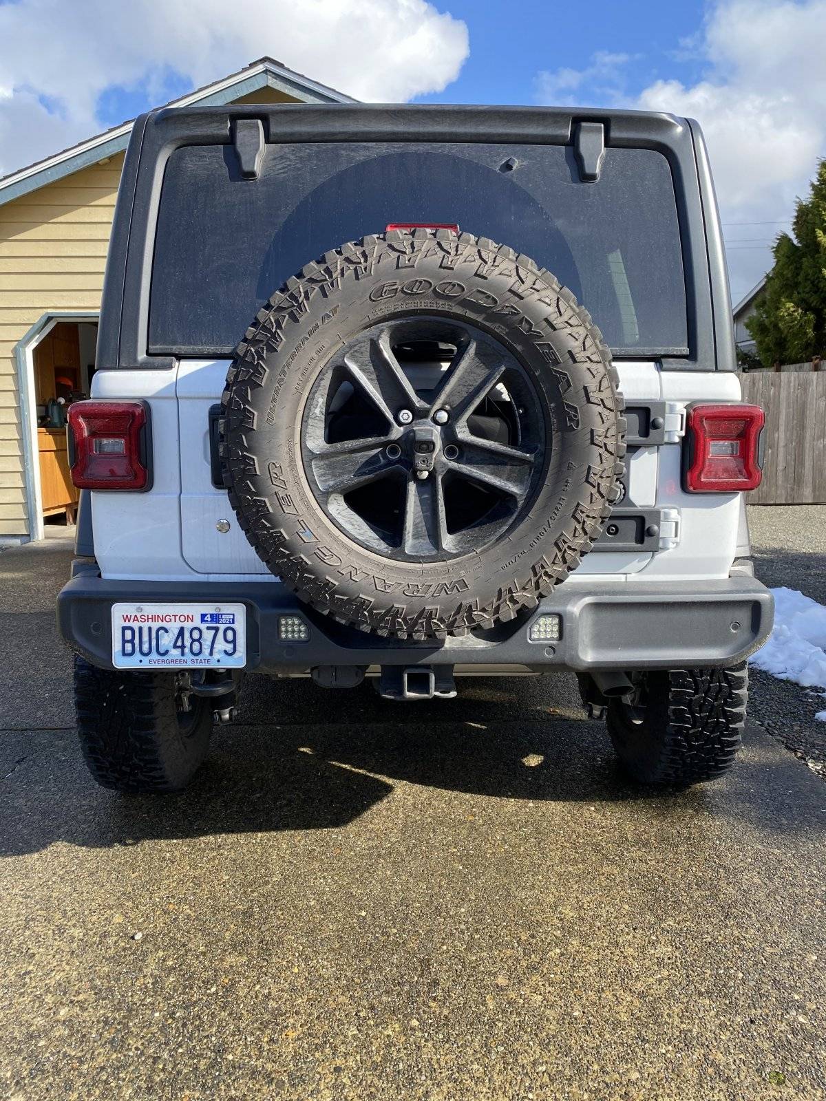

I’
Tdkrum5
Ted
Mar 5, 2020
363
358
WA/AZ
20 White JLU Altitude

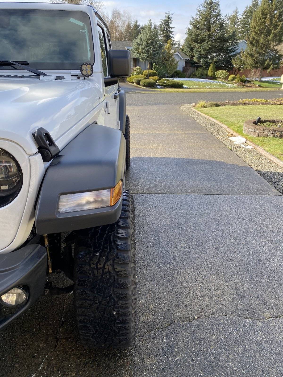

20 Unlimited Altitude, still have stock wheels and1.5 inch spacers till wheels and tire arrive. Problem is not sure about the wheels yet. Tires will be 37.
JL Model: Sport Altitude
Wheel: Stock 18” Altitude wheel
Offset: +44.5
Backspacing: 6”
Tire Make: Goodyear Wrangler Ultra Terrain AT
Tire Size: 275/70R 18
Lift: Clayton off-road 2.5+ overland
Rubbing: Yes with the lift this is why the 1.5" spacers. Clayton says 4.75 backspacing for their lifts.
Pictures:
Jeep Wrangler JL JL Offset & Backspacing Finally Answered! IMG_4110
Jeep Wrangler JL JL Offset & Backspacing Finally Answered! IMG_4111
Jeep Wrangler JL JL Offset & Backspacing Finally Answered! IMG_4112
Jeep Wrangler JL JL Offset & Backspacing Finally Answered! IMG_4113
Jeep Wrangler JL JL Offset & Backspacing Finally Answered! IMG_4117
Jeep Wrangler JL JL Offset & Backspacing Finally Answered! IMG_4116

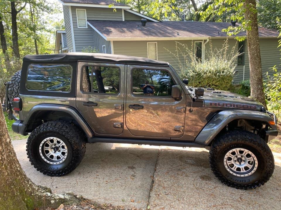

JL2021guy
JL2021guy
Apr 25, 2021
93
Daly City
2021 Jeep Wrangler rubicon 3.6
Jeep fun

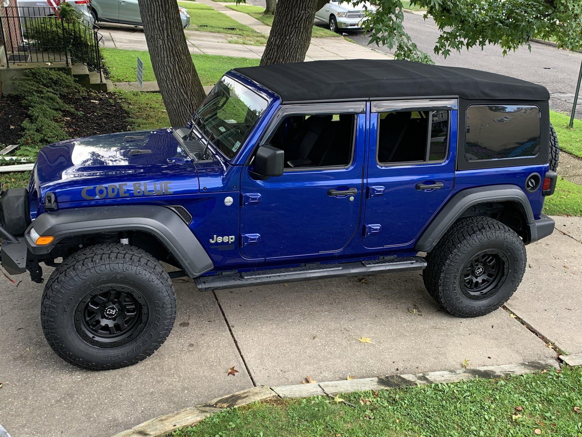

[*]JL Model: JLUR
[*]Wheel: gfx tr 10
[*]Offset: +12
[*]Backspacing: ~5.5
[*]Tire Make: mastercraft courser mxt
[*]Tire Size: 37 12.5 17
[*]Lift: mopar 2.5-3
[*]Rubbing: super mild on inner fenders when off roading. Not enough to be bothersome
[*]Pictures:

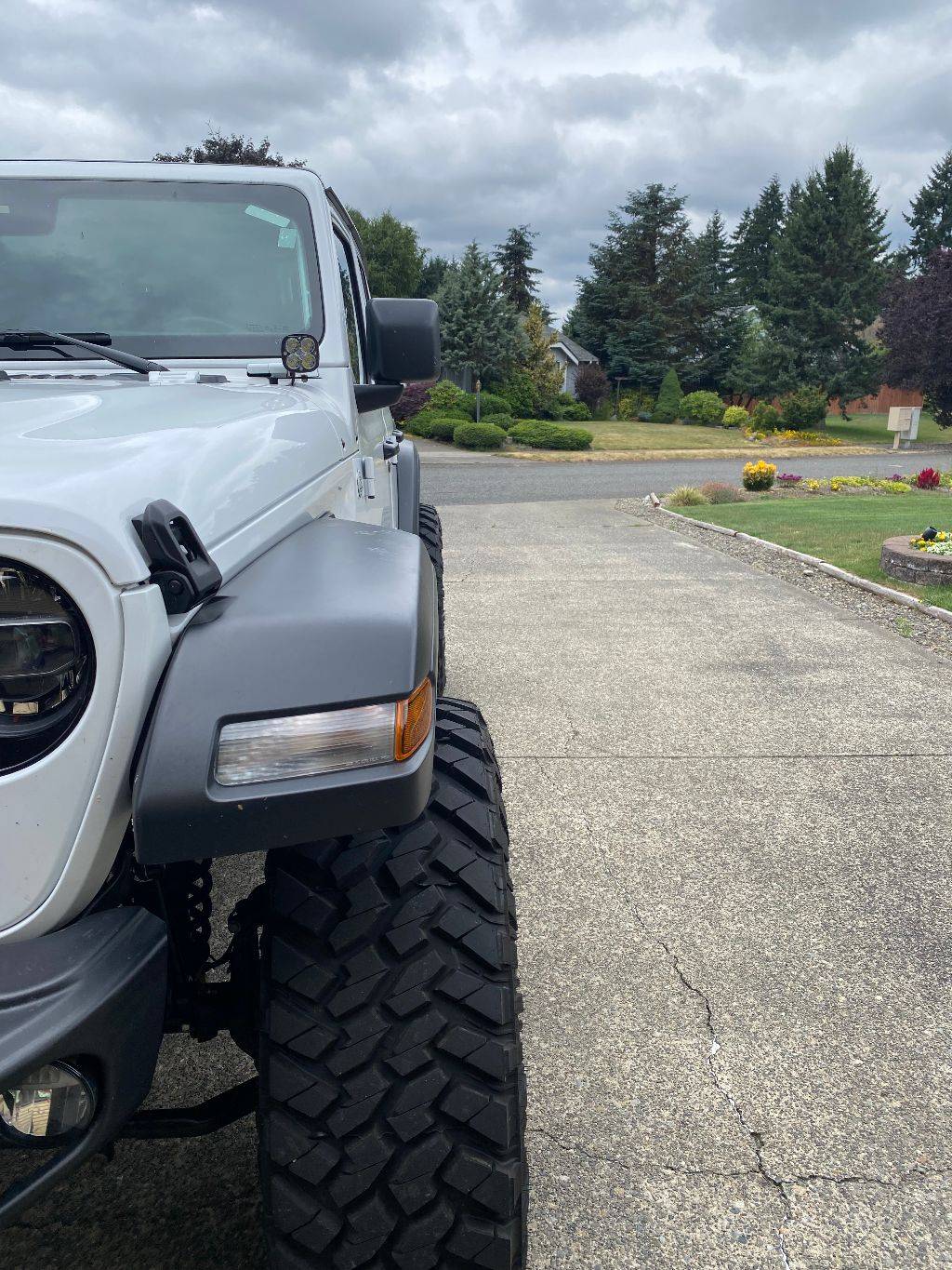

Tdkrum5
Ted
Mar 5, 2020
363
358
WA/AZ
JL Model: 20 JLU Altitude with Rubicon D44 axles
Wheel: Teraflex Nomad
Offset: 0
Backspacing: 4.75
Tire Make: Nitto Trail Grappler
Lift: Clayton Off-road 2.5 plus overland lift. I got around 3"
Rubbing: None at this time with minor flexing . Sport fenders are a little narrower cause of smaller axles. Waiting on the Rubicon High line fenders before I really test it out. Also have the Terafles front sway quick disconnects.
Pictures: From the driveway

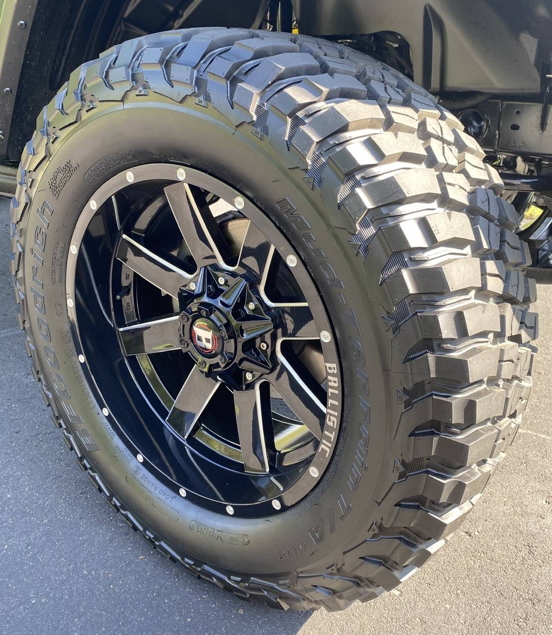

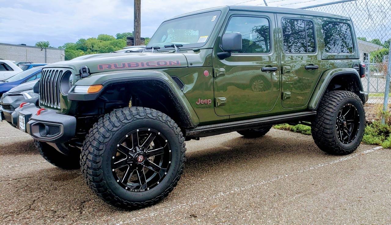

JasonInDLH
Jason
Jan 4, 2021
82
1,123
1,111
MN
21 JLUR, 15 Yukon Denali
I’d Rather Talk Jeep’s!
I wish I had found this thread when I was shopping for wheels and tires!

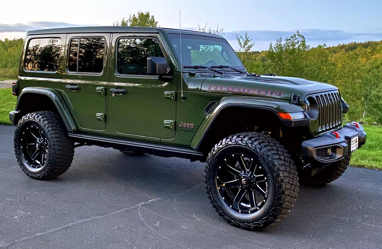

  • JL Model: Rubicon
  • Wheel: Ballistic Rage
  • Offset: -19mm
  • Backspacing: 4.75
  • Tire Make: BFGoodrich Mud Terrain KM3
  • Tire Size: 325/60R20
  • Lift: AEV DualSport 2.5”
  • Rubbing: None
  • Pictures:
  • Jeep Wrangler JL JL Offset & Backspacing Finally Answered! 9943A5F4-17CE-49CD-839F-0397FE5EAB14
    Jeep Wrangler JL JL Offset & Backspacing Finally Answered! 108D44B3-0DCB-40DA-96AD-9D71BCC8F48E
    Jeep Wrangler JL JL Offset & Backspacing Finally Answered! E40899BB-C13D-4E18-9777-9D62ABE20864
    Jeep Wrangler JL JL Offset & Backspacing Finally Answered! 4440079B-2FAF-40B2-B6FF-FA4E78FA5748
    Jeep Wrangler JL JL Offset & Backspacing Finally Answered! D0798741-DC3B-4510-8CC8-18B5FC80E778

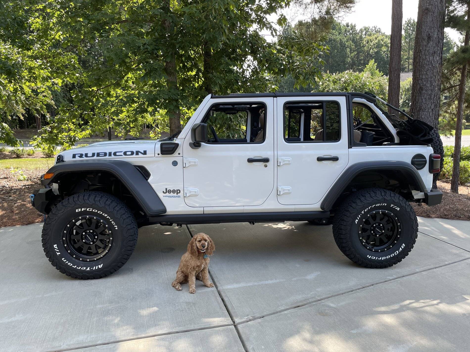

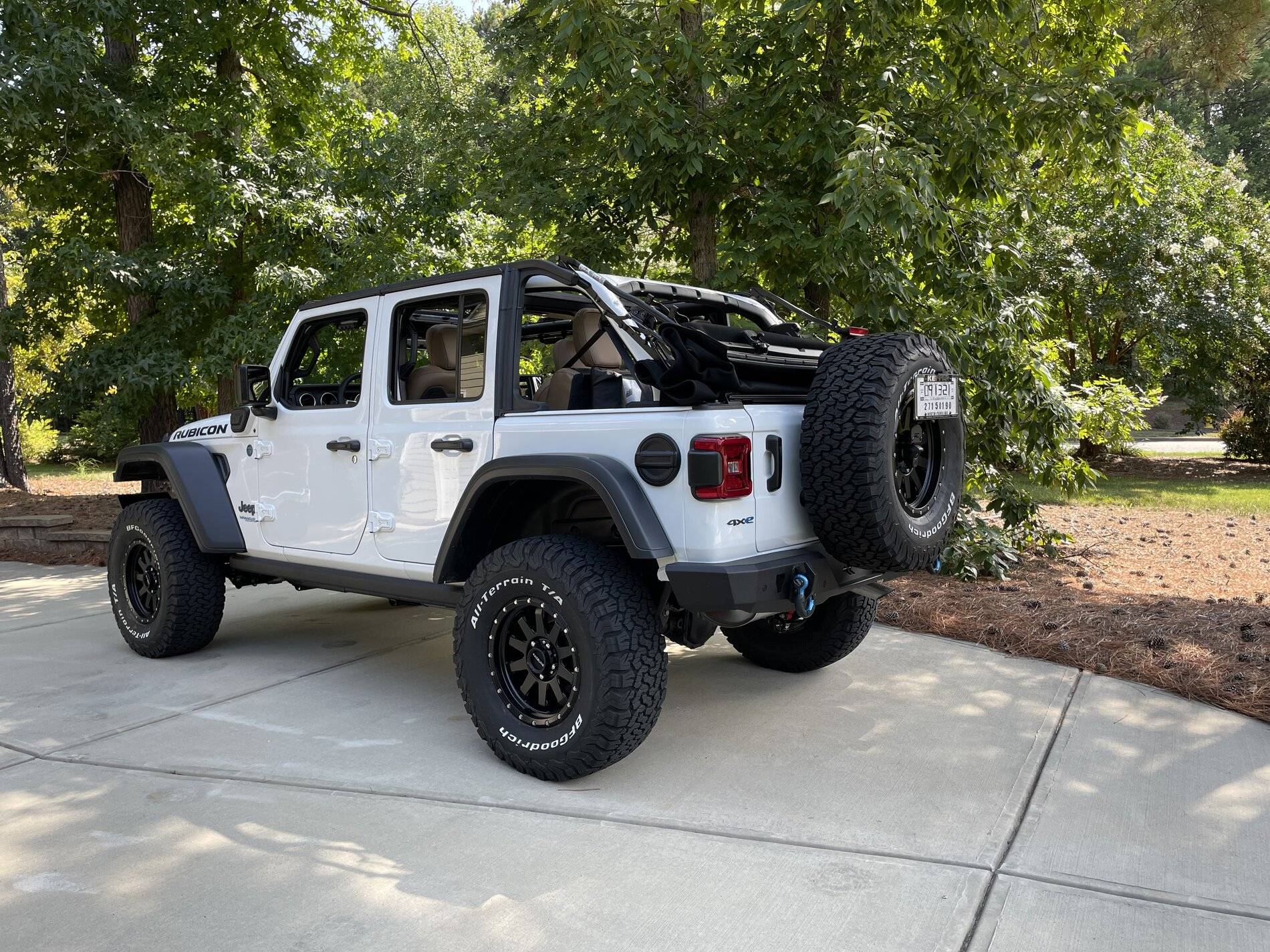

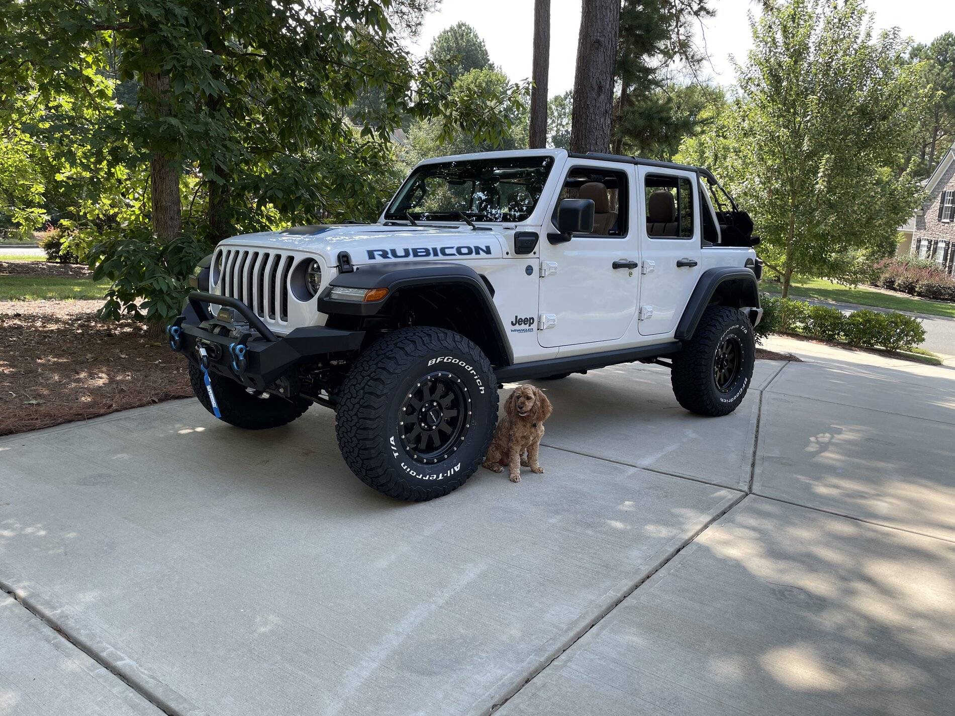

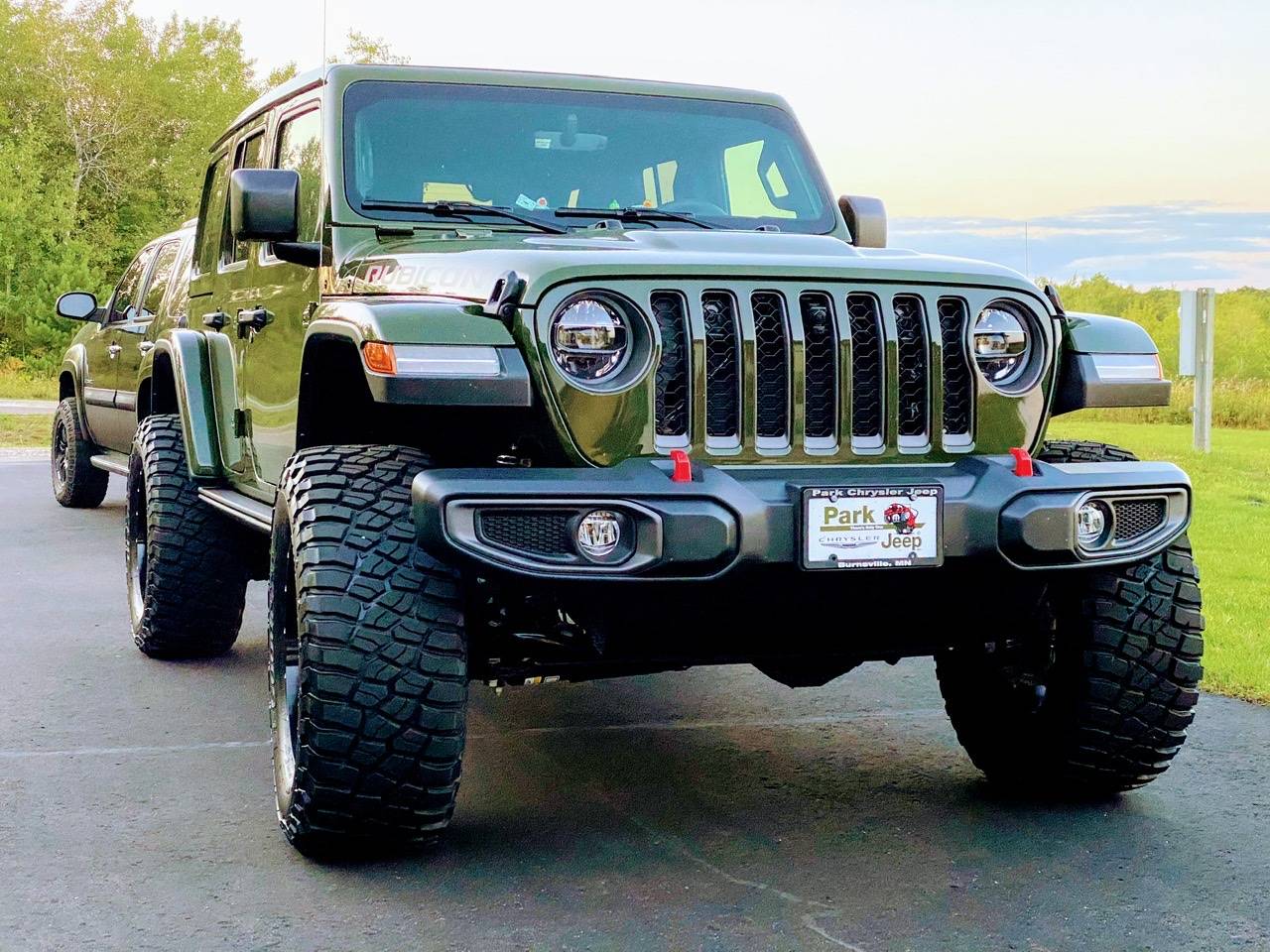

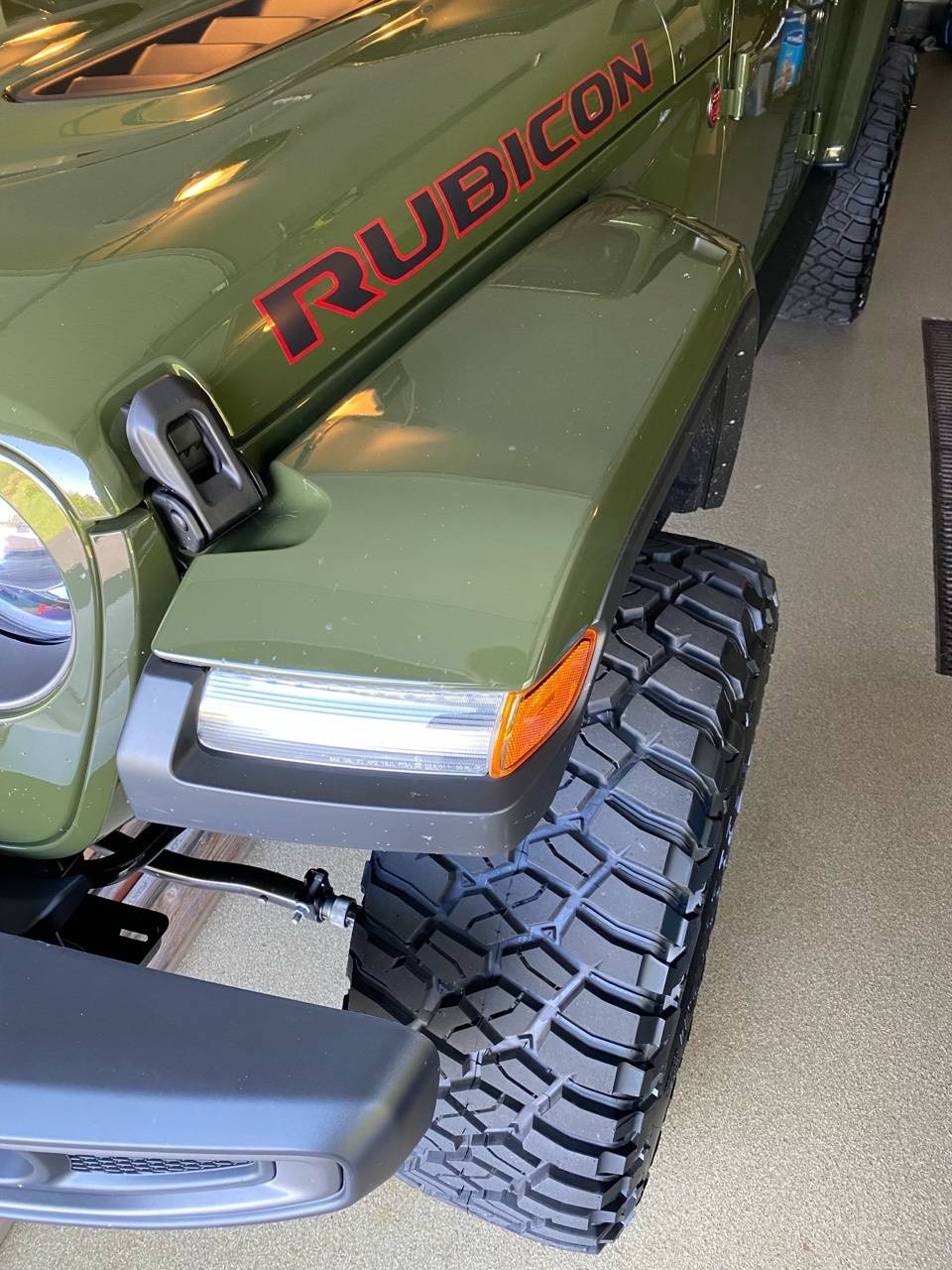

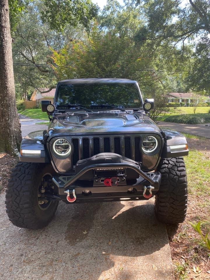

Guess I may as well post our setup while I'm here.
  • JL Model: JLUR 4xe
  • Wheel: Raceline Clutch 17x8.5 (934B)
  • Offset: +18 mm
  • Backspacing: 5.46
  • Tire Make: BFG AT KO2
  • Tire Size: 35x12.50R17
  • Lift: 2" F, 1.5" R, 2" Bumpstops
  • Rubbing: Front: full lock full stuff minor on aftermarket front bumper
  • Pictures:
Jeep Wrangler JL JL Offset & Backspacing Finally Answered! 30C6C7EB-1935-47EA-86E9-760E6BF95CFC
Jeep Wrangler JL JL Offset & Backspacing Finally Answered! 076E0653-228A-4120-BBF8-51DA57EF6D70
Jeep Wrangler JL JL Offset & Backspacing Finally Answered! C3AD0709-B0C8-4136-8A58-0CB65F8A98D7
