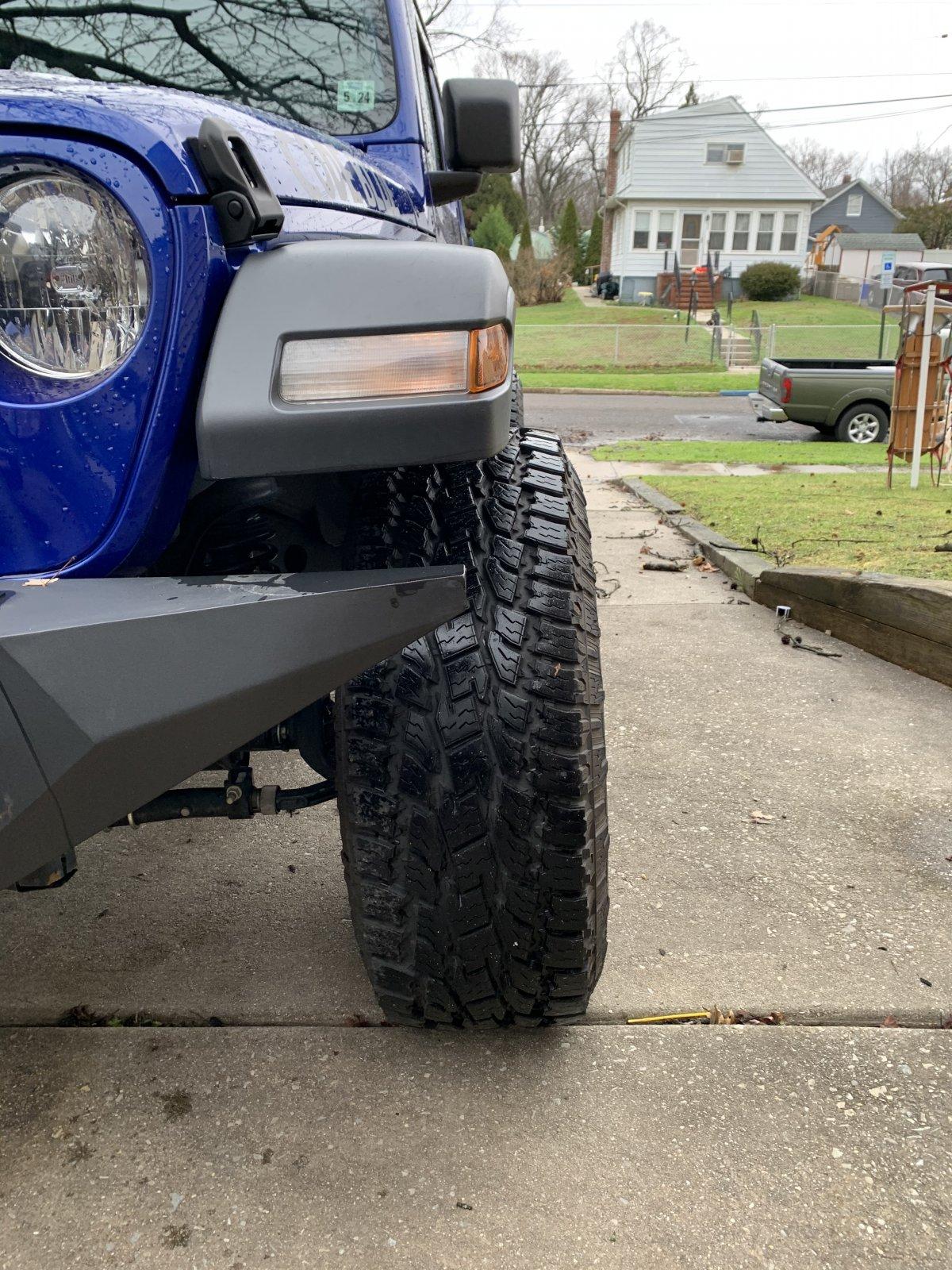

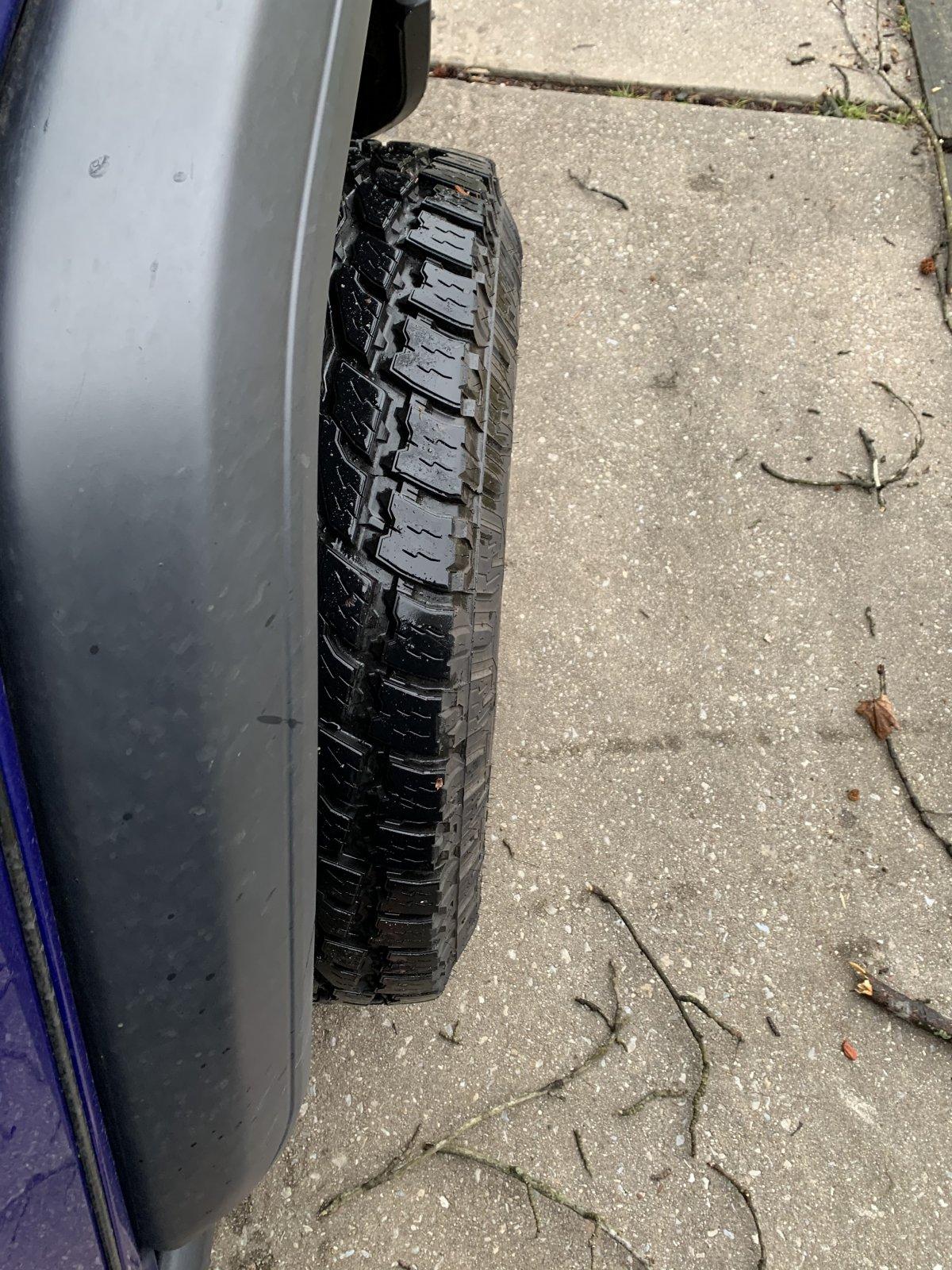

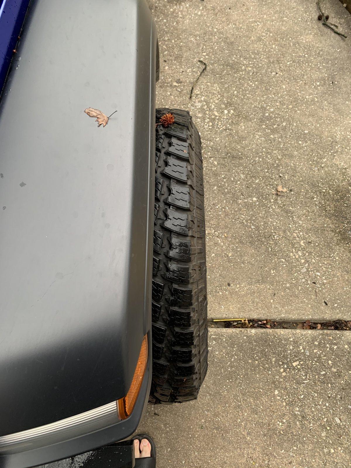

Rubicon doesn’t help me that much since my axles aren’t as wide. I think I am in the 0 to +10 range. Seems to put me about 1.5-2” outside stock. Front tires have about 3/4 inside fender now, so may be about what I need to stay legal here

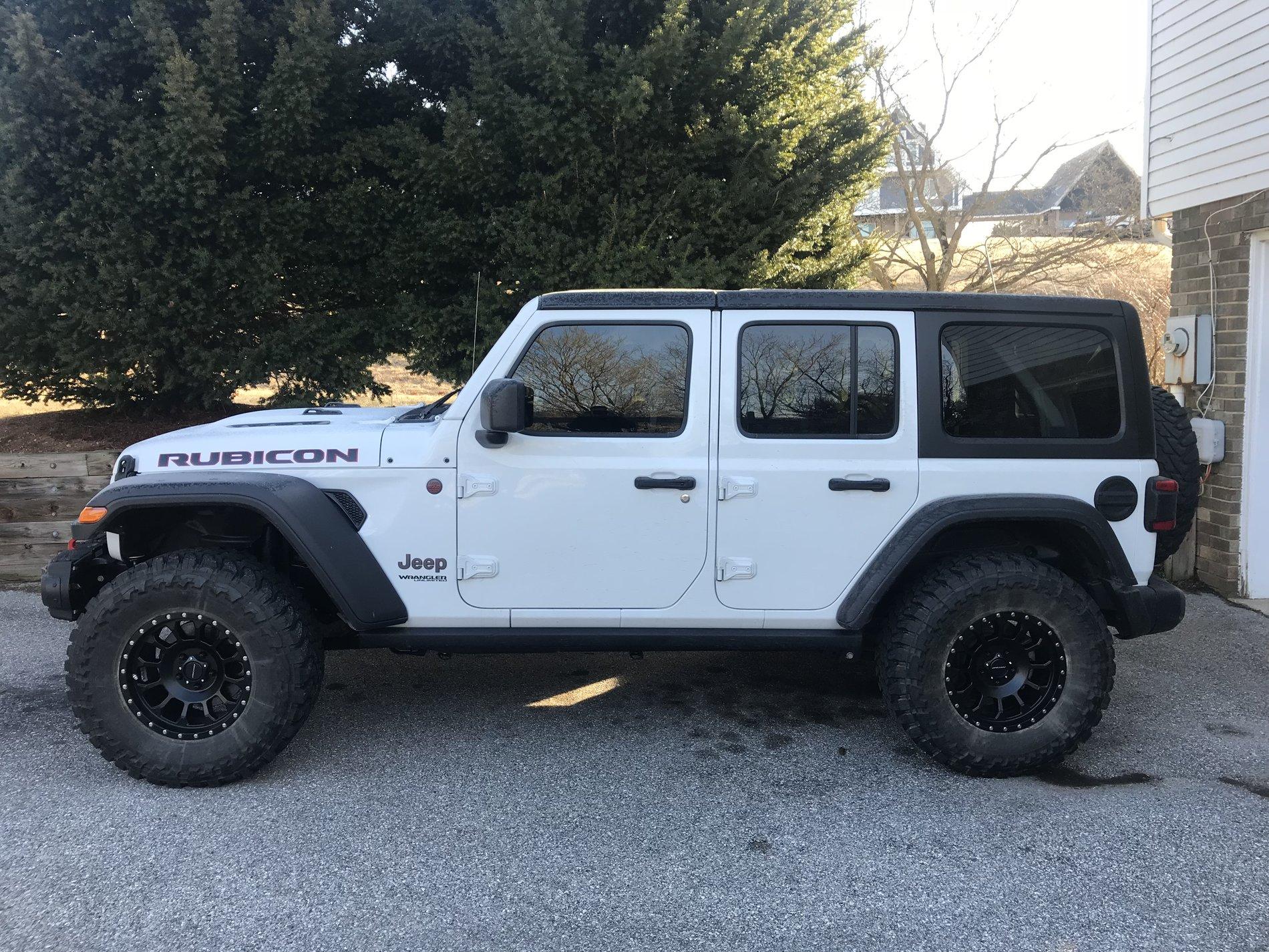

You want a 0 offset at most if you want to stay close to inside fenders. I run a 9.5” and -18 offset.
yeah, they are sticklers here at inspection time. Maybe 1.5” outside fender I can pull off. If I calculate right, 0 on a 9” wheel is 5.25” backspacing. Pushes my wheel out .75”. Then another 1” or so for the 11.2” tire and I am probably 1-1.5” outside fender.

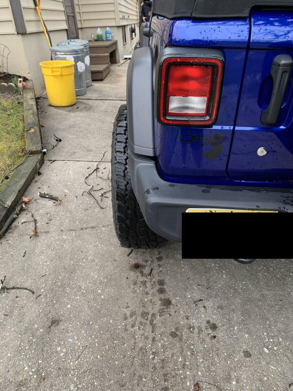

Do they actually pull people over for the tires sticking out in Delaware? NJ has the same law but most of the Jeeps and off-road rigs all run wider tires that are past the fenders. Hell I even see some people with no fenders. So far I haven’t gotten pulled over(as I knock on wood) and I run a -18 on a sport.

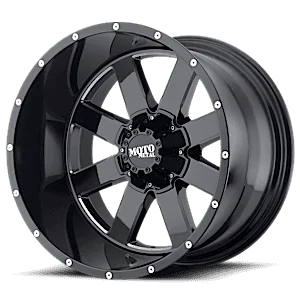

Heyyy guys & Gals! I have a 2021 Rubicon that I'm looking to mount a set of 37-13.5-18 Toyo m/t on these rims,(18"×10" with a -24 offset) does anyone know how far the tire tread would stick out pass the stock fenders?? Thanks in advance ????
Jeep Wrangler JL Ideal offset/backspacing JL MO_962_Gloss_Black_Milled_Accents-300-Cloned412405685764-Cloned412405686343
Living Good 357
Big D
Mar 30, 2021
52
Pa
C7 Z06, C6 Z06, 07 Dodge Cummins, 900 HP 72 Nova
These are the MO 962
