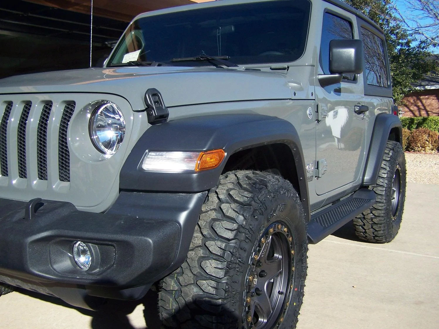

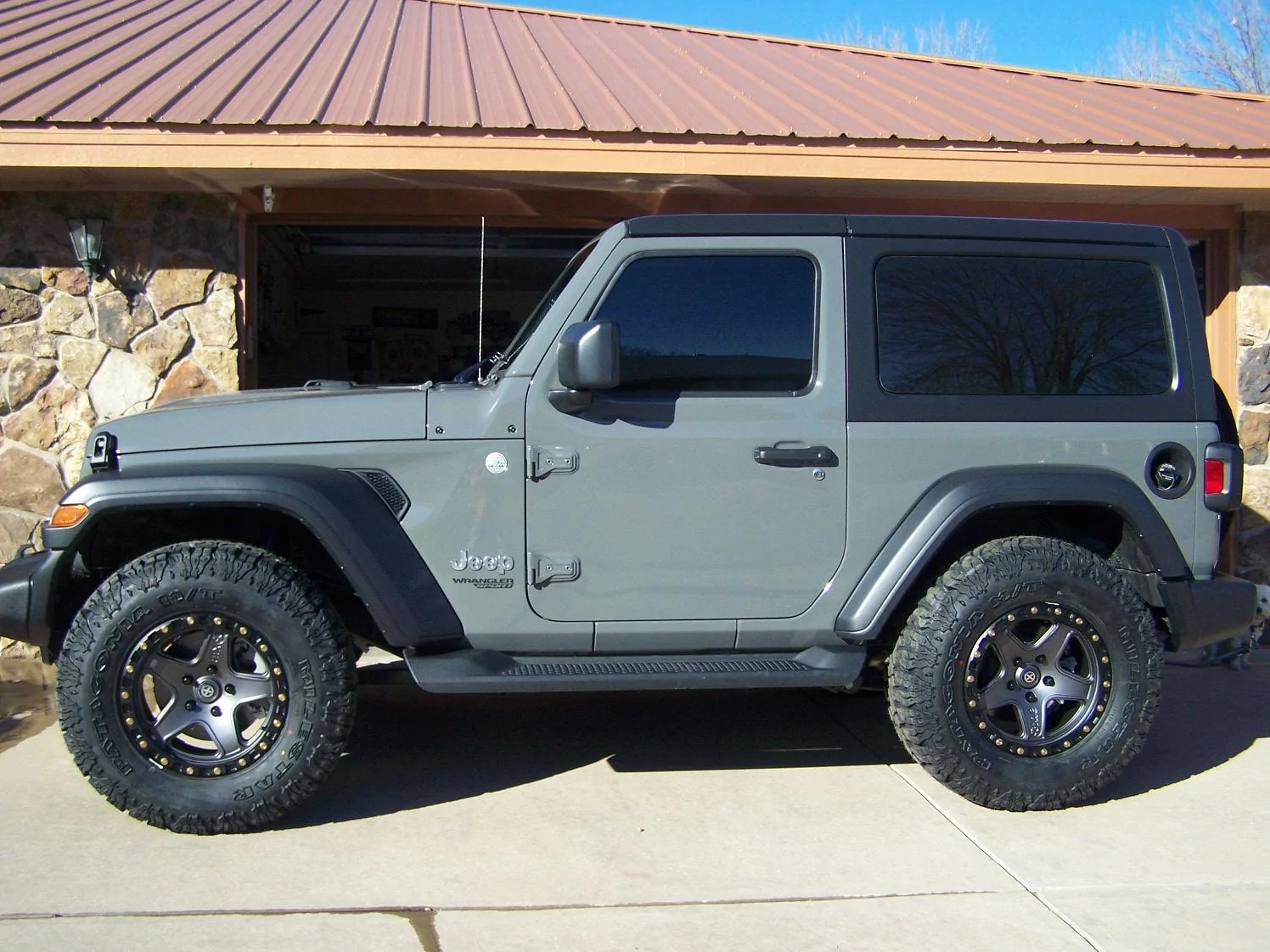

Here's 8.5+10 on 295/70/17s, not much outside the fender and no rubbing issues on stock suspension

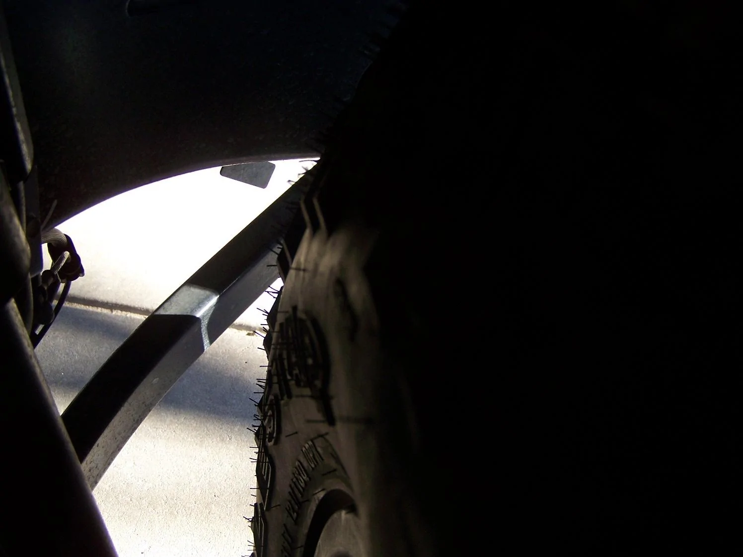

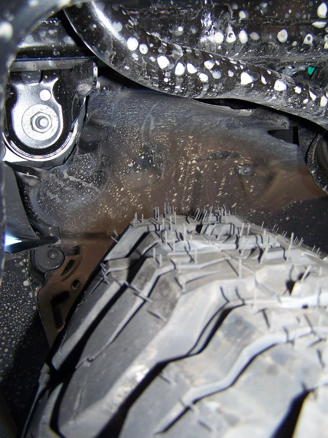

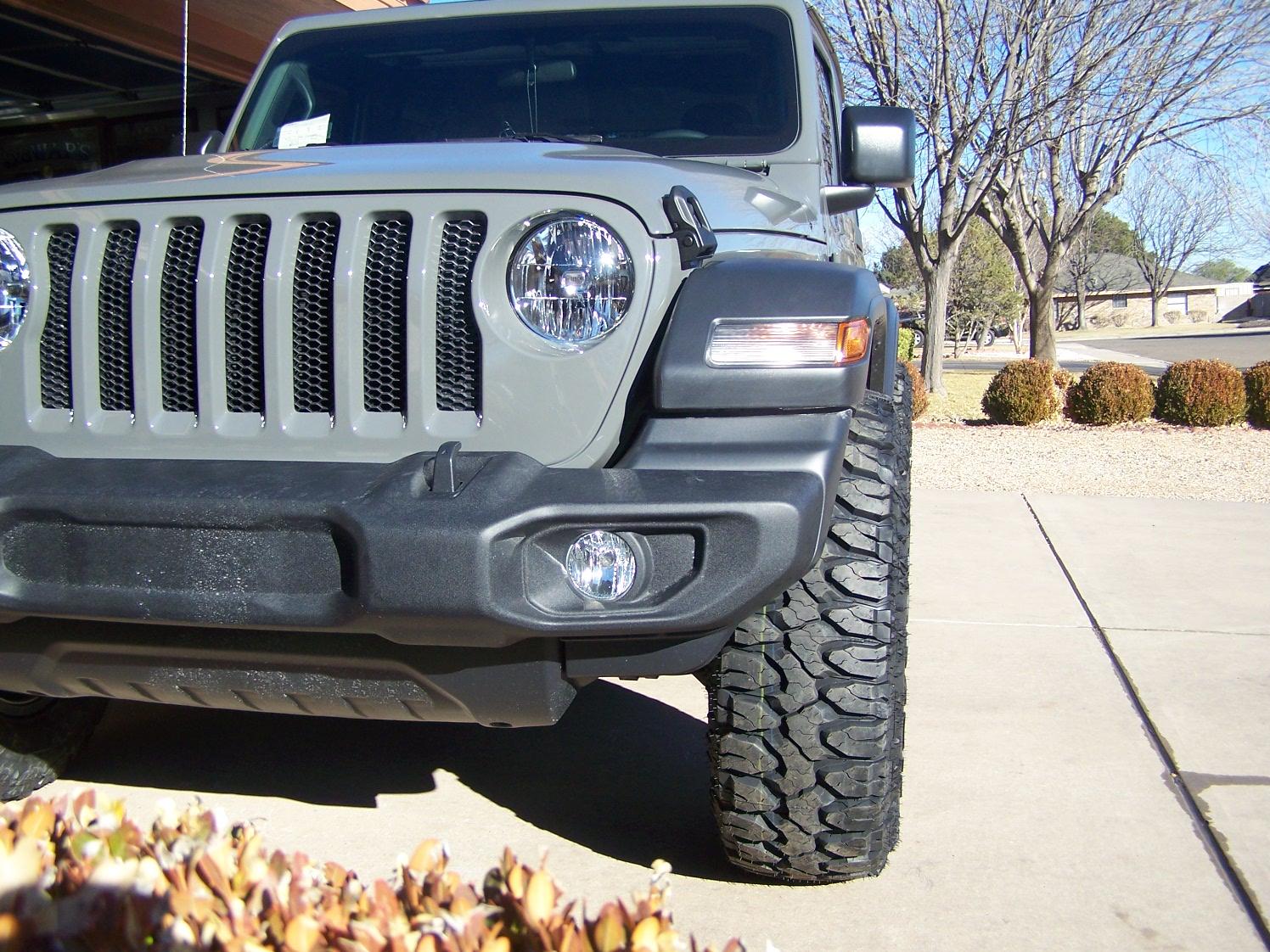

Any chance you can snap a picture of the insides at full lock? i just got the same tires and am about to pull the trigger on 8.5+18 but am still hesitant. Thanks.
Here you go, first shot is down the backside of drivers side full lock, nothing close.

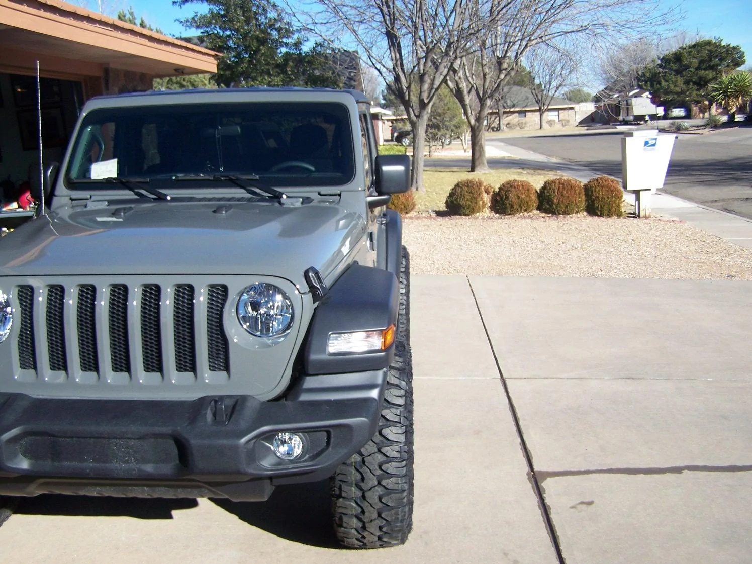

2nd shot inside of passenger side on the front, again, no problems

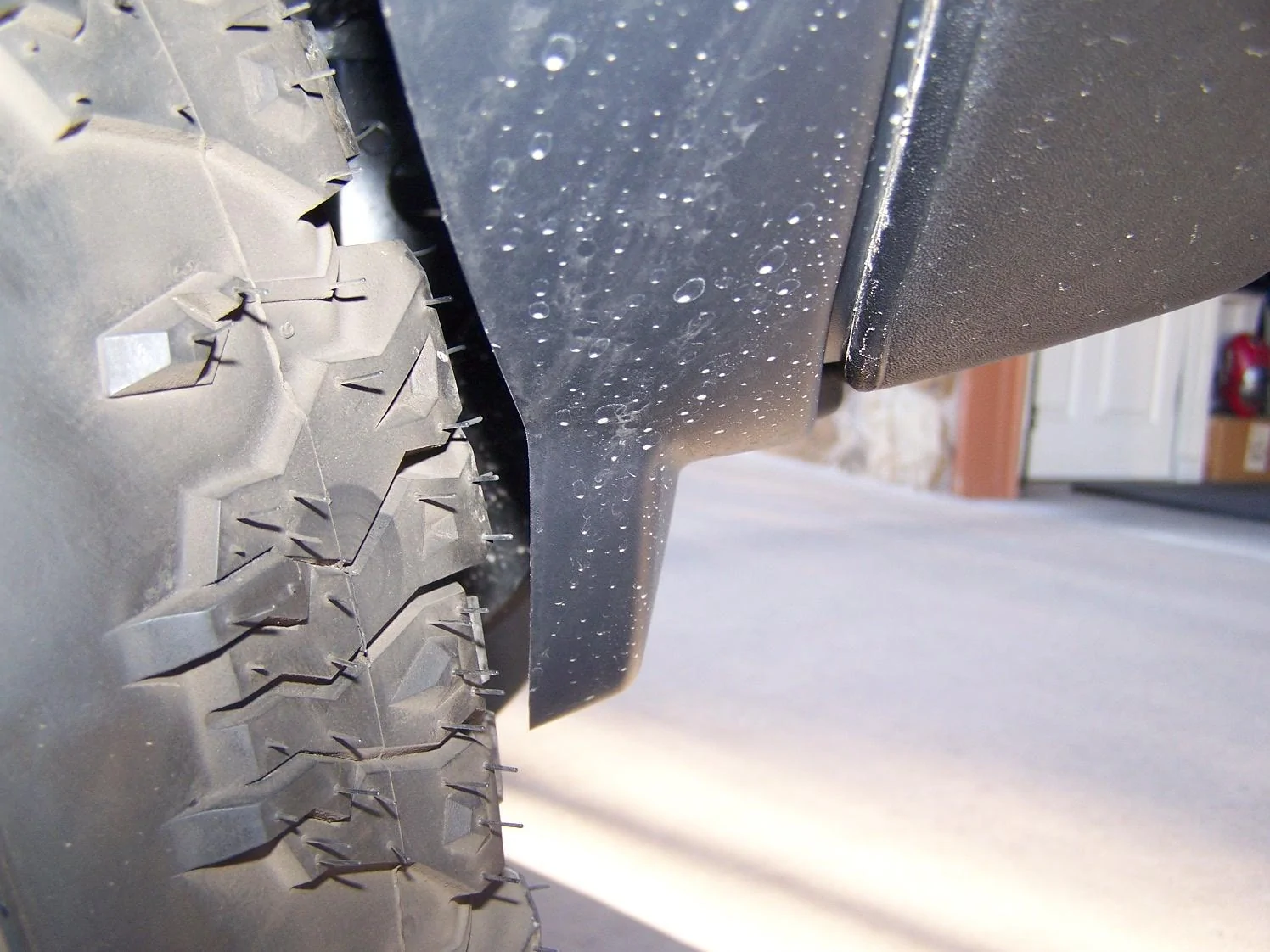

3rd shot real close at the lower edge of plastic bumper trim, about 1/4" or less, but no problems at that tire diameter, any taller and trimming would be needed at stock height. Your +18 will be fine in that regard, much more than 8mm clearance lock to lock.
Thank you!!

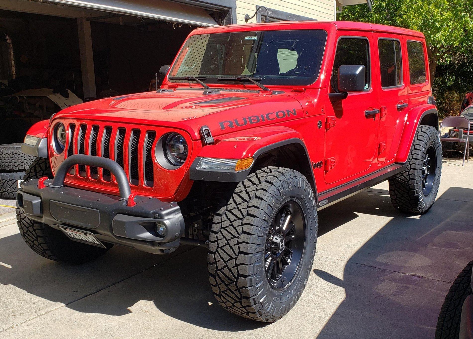

Hi Sarah - Mine have a -12mm offset which makes my tires stick apx. 2"
I hope this helps

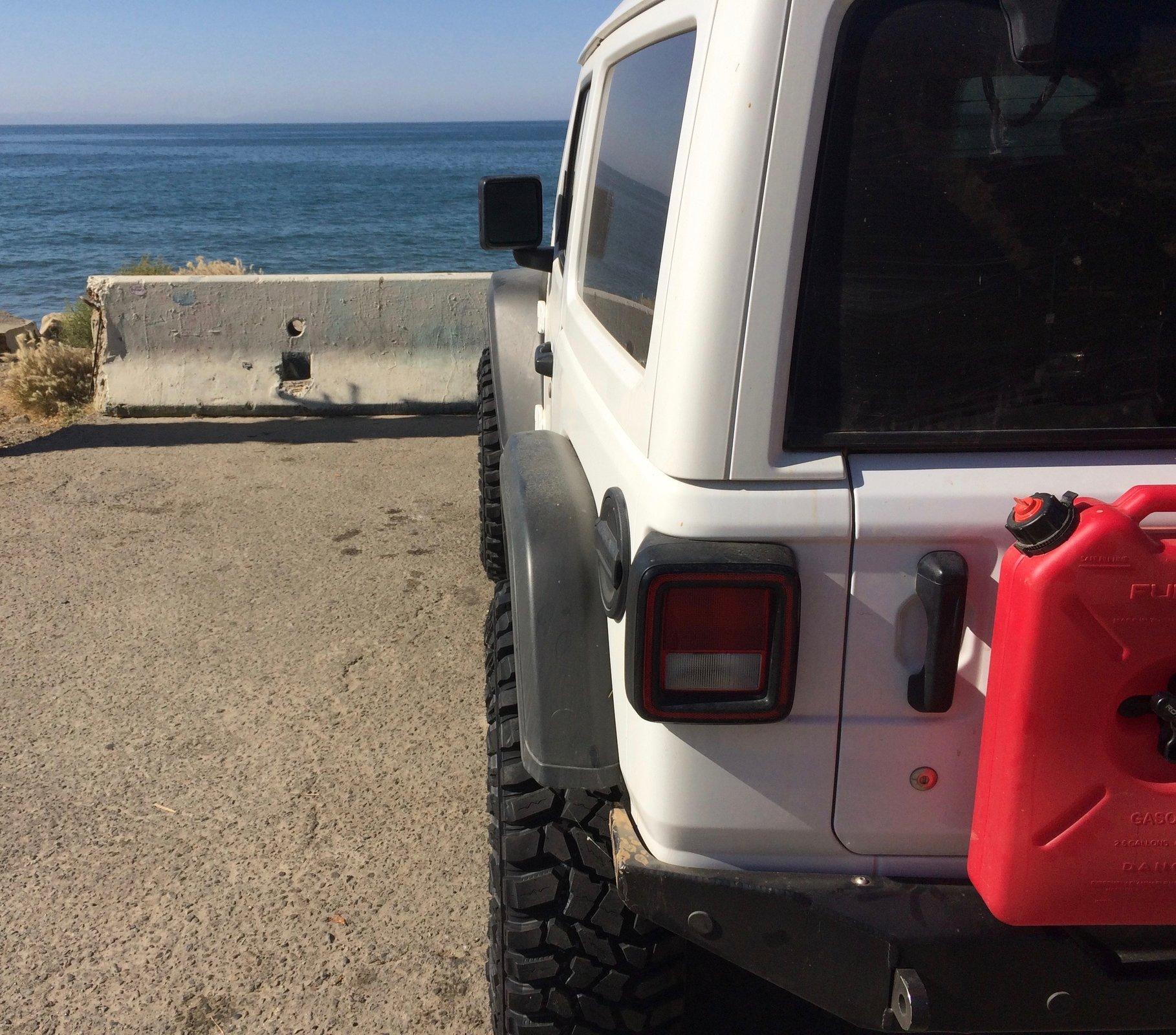

I am looking st the fuel shok 17x10 wheels, with 315x70r17 Toyo mt wheels.. the back spacing is 4.75 and off set is -18.. having trouble finding photos of a similar set up.. can anyone share photos of a 4.75 bs with -18 offset l, running 45ish tires..

Zero (0) offset, 4.5 in backspace. Hostile Predators.
Some mild sticking out, about what I wanted, and compatible with most lifts
