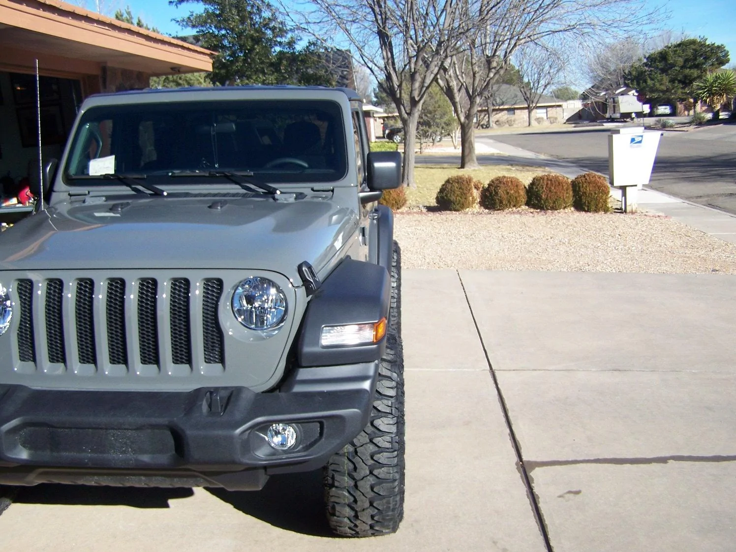

So i just purchsed some XD wheels 17x8.5 4.75 BS. Gonna put 315/70R17s on - can some one help me out on how much poke there will be? My other option is a 17x9 5.71 BS -
I'm running a 2" lift with 1.75" spaces on stock wheels...
blnewt
Brad
Oct 8, 2018
99
9,956
24,084
New Mexico
Just ask @cosine he knows!
Looks like that would be a 0 offset, here's my fit on a 8.5 +10 on 295s, your would be 10mm out for offset and 10 mm out for wider tire, so a net 20mm out from mine. That other option has too much backspacing, your current spacer would be too thick, but something like a 3/4" spacer would work.

Thanks. I’m ditching the spacer. I ordered the 0 offset which seems like it’s reasonable (I think). Part of the reason for jumping is to eliminate the spacers.
