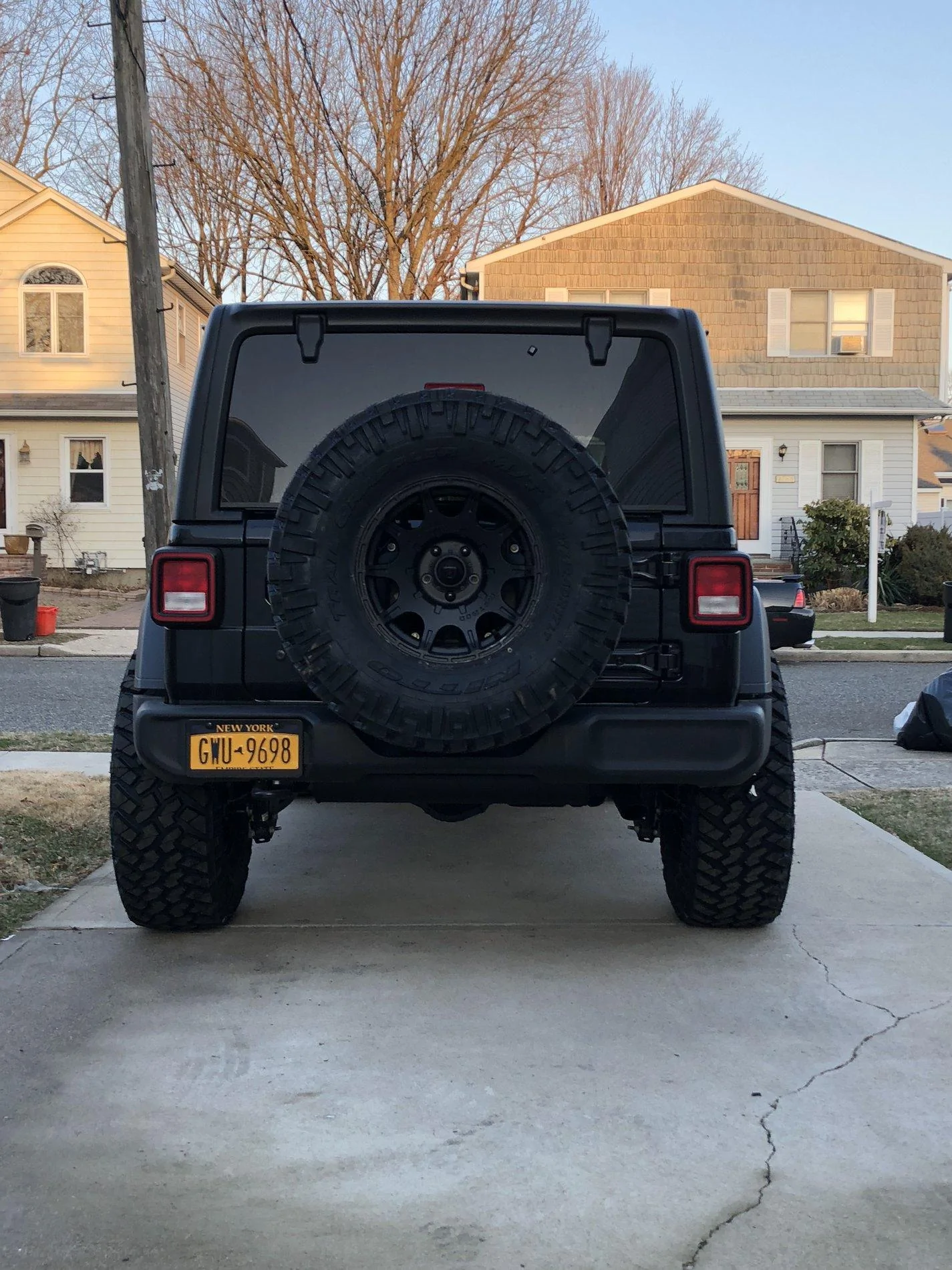

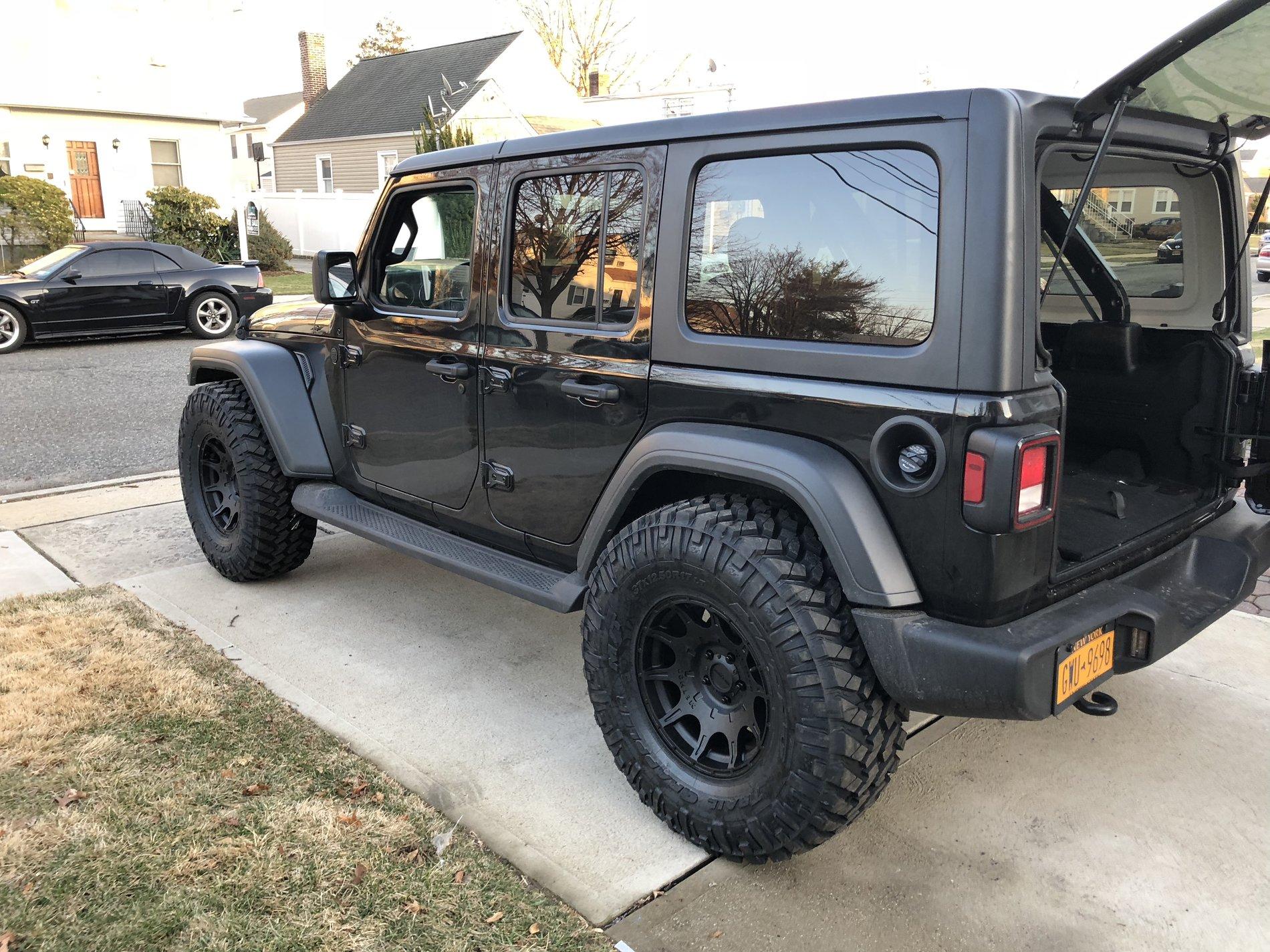

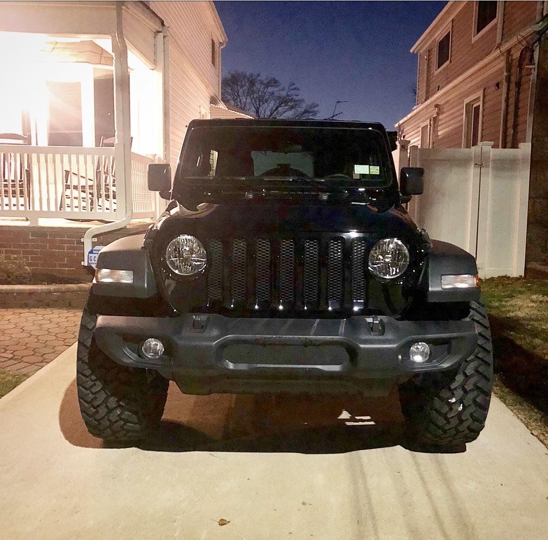

37s, 8.5 wheel width, 12.5 tire width , 0 offset, 4.5 back space. Sport S stock suspension. In my opinion I’d prefer them to stick out slightly more. 466659E9-1A75-470F-A1F1-1DB1BE266D00.webp 4D8F95A8-0093-41CB-BC2E-15CEC1394FAC.jpeg 373AE8F9-3453-4616-BB3C-3891B6C18555.jpeg
37s, 8.5 wheel width, 12.5 tire width , 0 offset, 4.5 back space. Sport S stock suspension. In my opinion I’d prefer them to stick out slightly more. Jeep Wrangler JL Ideal offset/backspacing JL 466659E9-1A75-470F-A1F1-1DB1BE266D00 Jeep Wrangler JL Ideal offset/backspacing JL 4D8F95A8-0093-41CB-BC2E-15CEC1394FAC Jeep Wrangler JL Ideal offset/backspacing JL 373AE8F9-3453-4616-BB3C-3891B6C18555

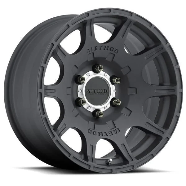

Hey those rims look GREAT - exactly what I’m looking for! Are they Method Roosts? (Pic attached) - if so how did you black out the silver hub rings on the side shots? Perfect rim :)

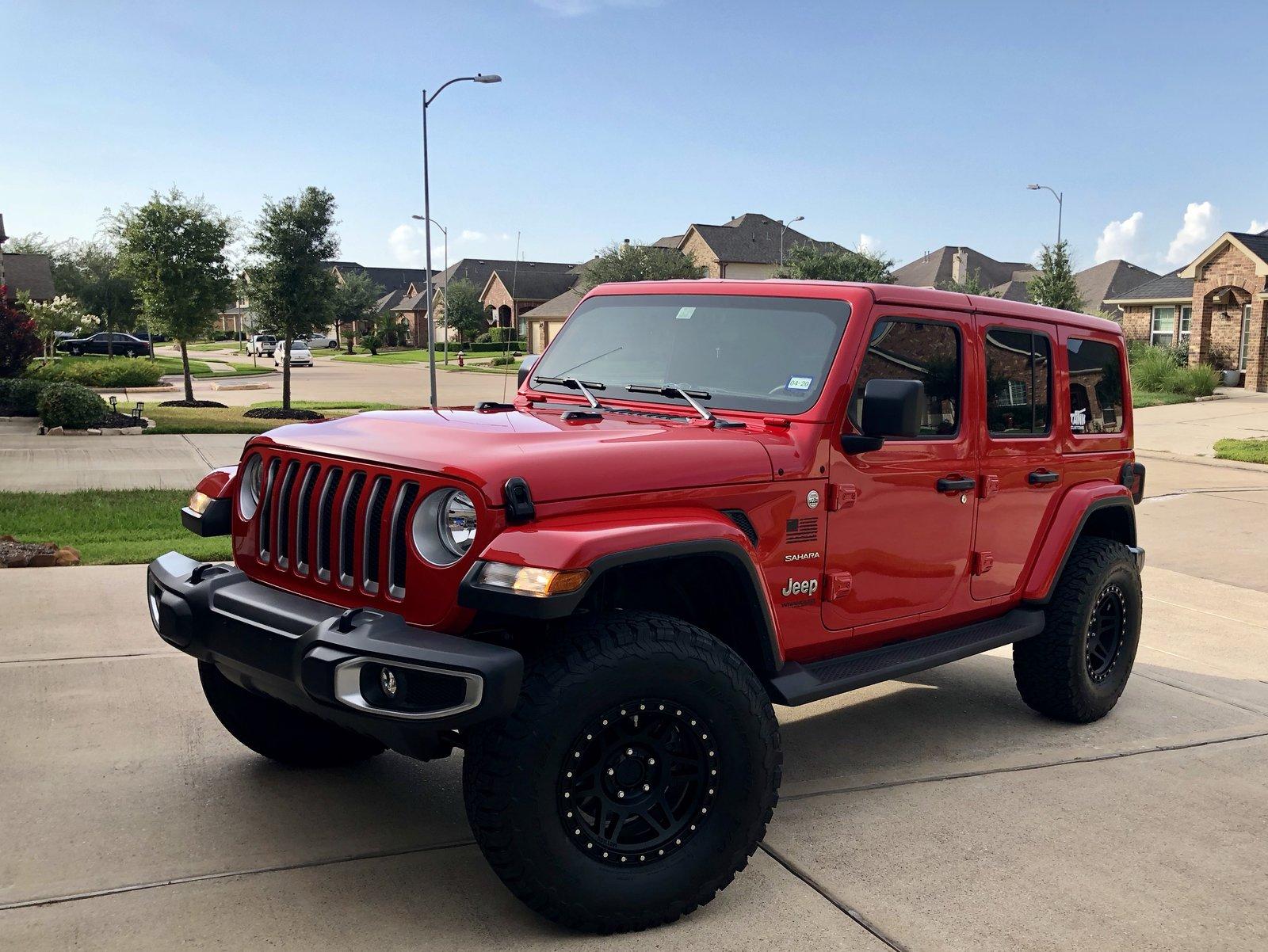

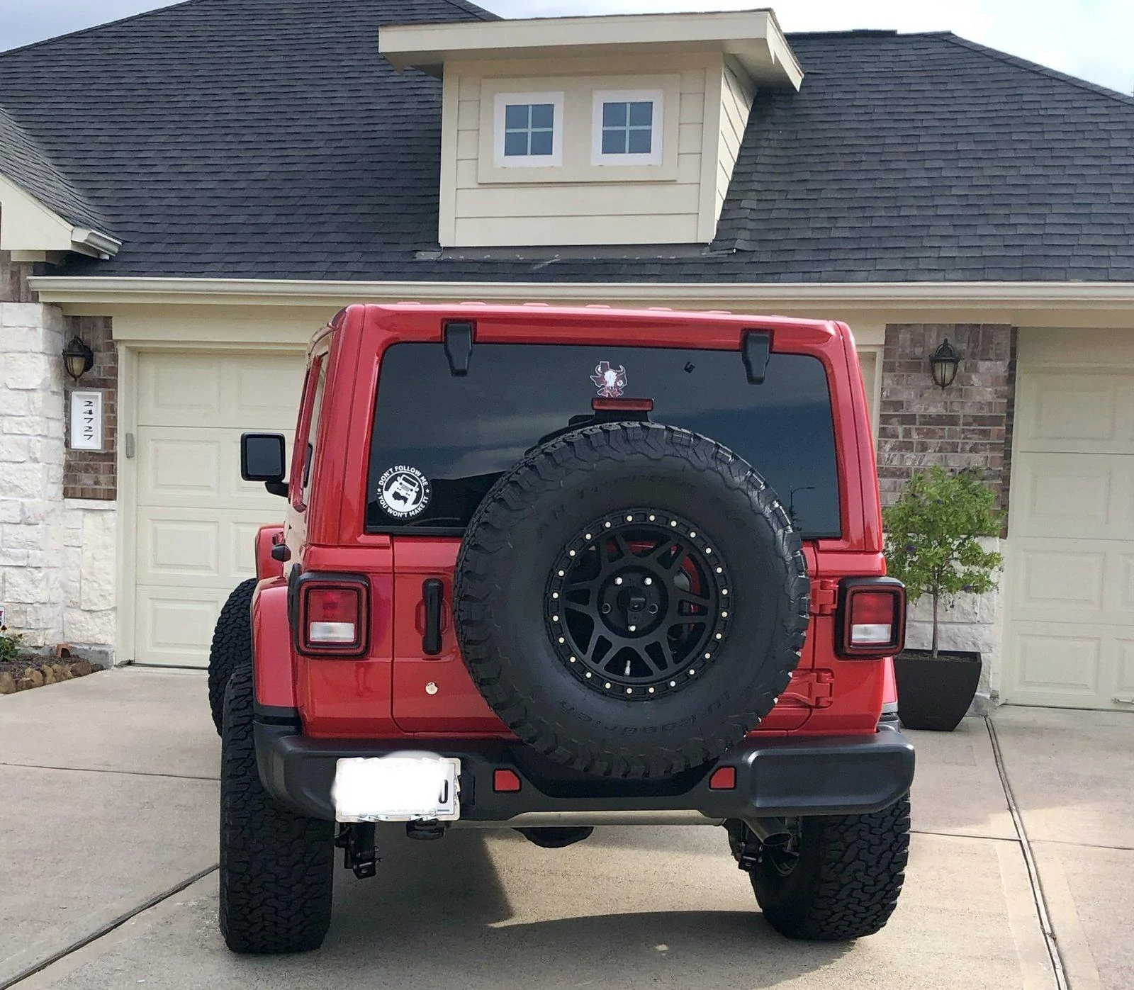

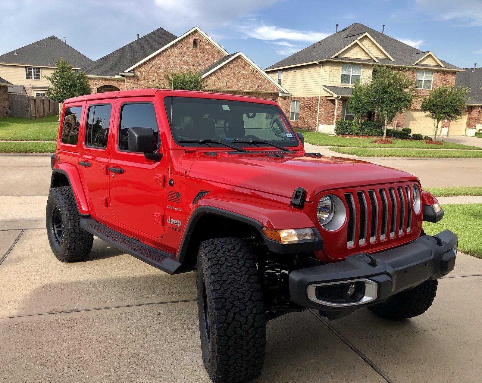

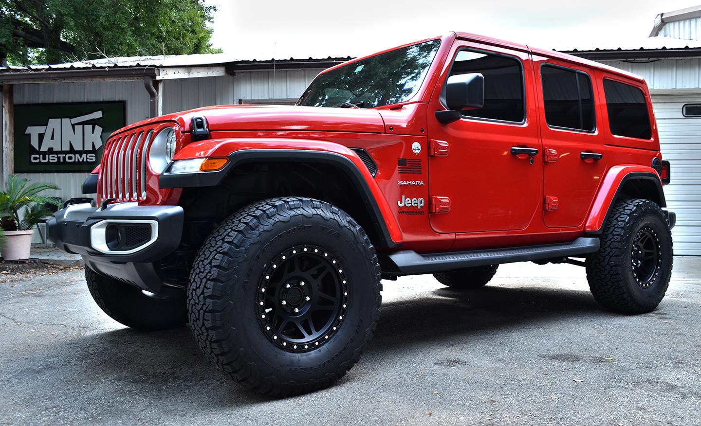

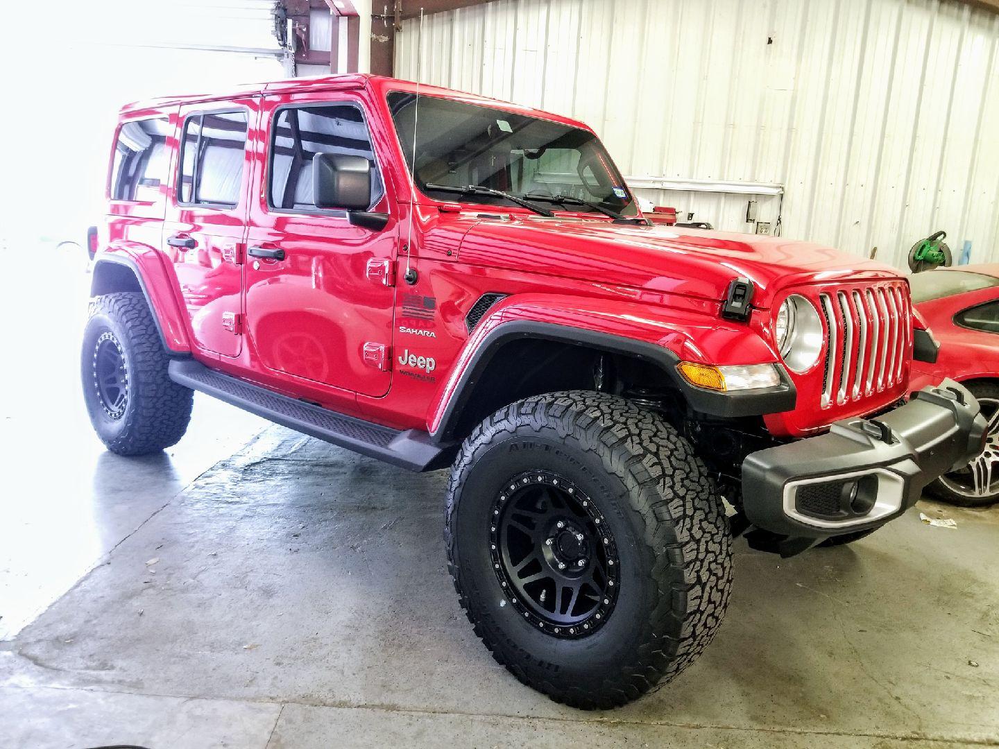

I was wanting to run my 18” stock wheels on my Sahara but after checking with several folks and talking to @TTEChris I decided it was best to run smaller wheels with a larger offset so went with. 2.5” RC budget boost and Method MR312’s with a -12 offset and put on 315 K/O 2’s the tires do stick out a little but not bad, the only downside is when it’s all clean you have to stay clear of any puddles on the streets and it throws some rocks
Jeep Wrangler JL Ideal offset/backspacing JL 801735D7-50A4-4936-9153-ADA2CDBE3670
Jeep Wrangler JL Ideal offset/backspacing JL 98791528-7E33-4B3C-94E8-1D17953D357D
Jeep Wrangler JL Ideal offset/backspacing JL 251D4296-0865-4C7C-A14E-F8B545E41807
Jeep Wrangler JL Ideal offset/backspacing JL 2A9393C2-5541-47E2-83E9-FF00FD9B7D72
Jeep Wrangler JL Ideal offset/backspacing JL 0864EF24-FCDC-4C43-B429-D8DD97F3250E

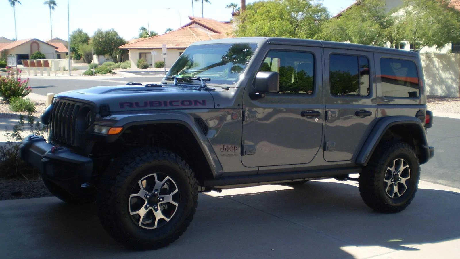

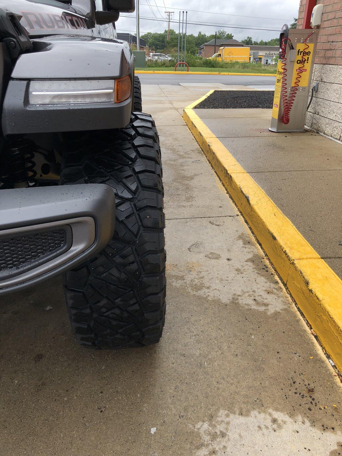

Thanks for all this info about offset. I was thinking of some Fuel Brutes in 20x12.5x9. They have them in I think 1 or -18 for the 20x10. Seems like the 1 offset would be what I want for a small amount of rubber past the fender similar to the white Rubicon above.
Jeep Wrangler JL Ideal offset/backspacing JL P9090003

Hard to say what ideal offset/backspacing would be as everyone has different tastes and uses for their Jeeps, and different tire sizing. Ideal offset for minimal fender poke on a 8.5 would be in the +18 range from what info I've been getting, and +25 on a 9 (using a 12.5 tire width).

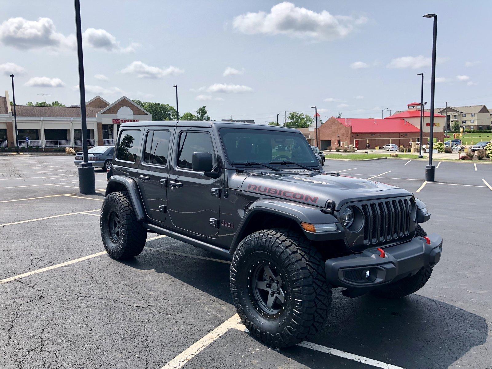

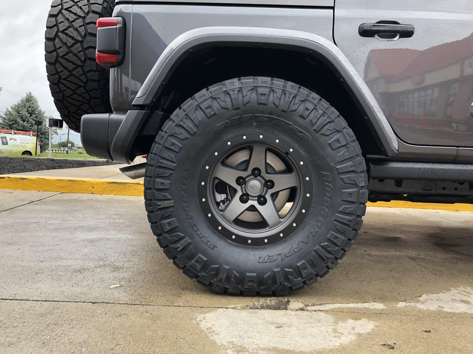

Was doing some clearance testing on our mid-width bumper and thought these photos may be of interest:
  • Lift is a Mopar 2" with the kit's bump stop extensions
  • Tires are 37" Nitto Trail Grapplers
  • Wheels are Mamba M14 Intel 17 x 9" with 5.47" backspacing
The only contact point is the grill, so it looks like that will either need to be trimmed, more bump will need to be added, or we will have to take out some steering. All other clearance looks pretty good.
I believe with the Rubicon's you can get away with 5 to 5.5" of backspace. Quadratec, AEV and Mopar have the most options for the increased offsets. Trail Ready and Raceline for beadlocks.

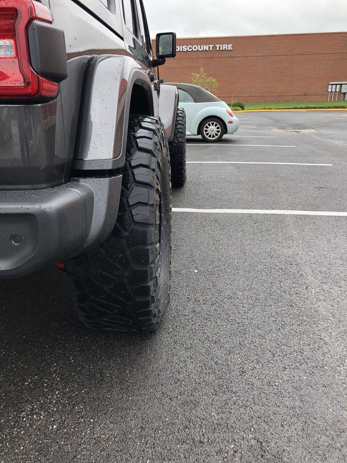

My tires are HANKOOK DYNAPRO LT315/75X16 BS 4.5" and I don't have any inspection requirements--
Jeep Wrangler JL Ideal offset/backspacing JL SUNP0228_zpsjspa139l
