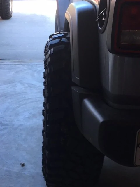

Man I mounted a tire on my wheel and slid it in place to check to see how they will fit. The stick out pretty far! these wheels have a 3.5" BS. What do you guys think will I have problems with this setup? The stick out like 3.5"

SST Pros on Methods? Looks great man.
If you’re good with how far they stick out, go for it! Do you have laws (enforced) in your area about tires sticking past fenders?
You’ll get more mud/rocks kicked up from the front tires going along the sides to the back - so consider a protective film (especially for the hinges).

Yea Method Beadlocks

How does it clear the front bumper and fenders?

Clear fine now that I have the lift on

thanks -44mm/3.5 they stick out there for sure lol
