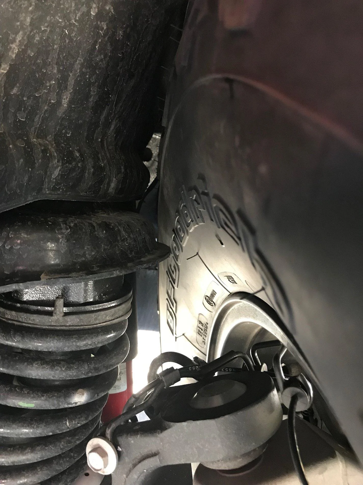

37s, 8.5 wheel width, 12.5 tire width , 0 offset, 4.5 back space. Sport S stock suspension. In my opinion I’d prefer them to stick out slightly more. 466659E9-1A75-470F-A1F1-1DB1BE266D00.jpeg 4D8F95A8-0093-41CB-BC2E-15CEC1394FAC.jpeg 373AE8F9-3453-4616-BB3C-3891B6C18555.jpeg
Please tell me you lifted this at some point and you're not riding around with 1 inch of fender clearance everyday?
