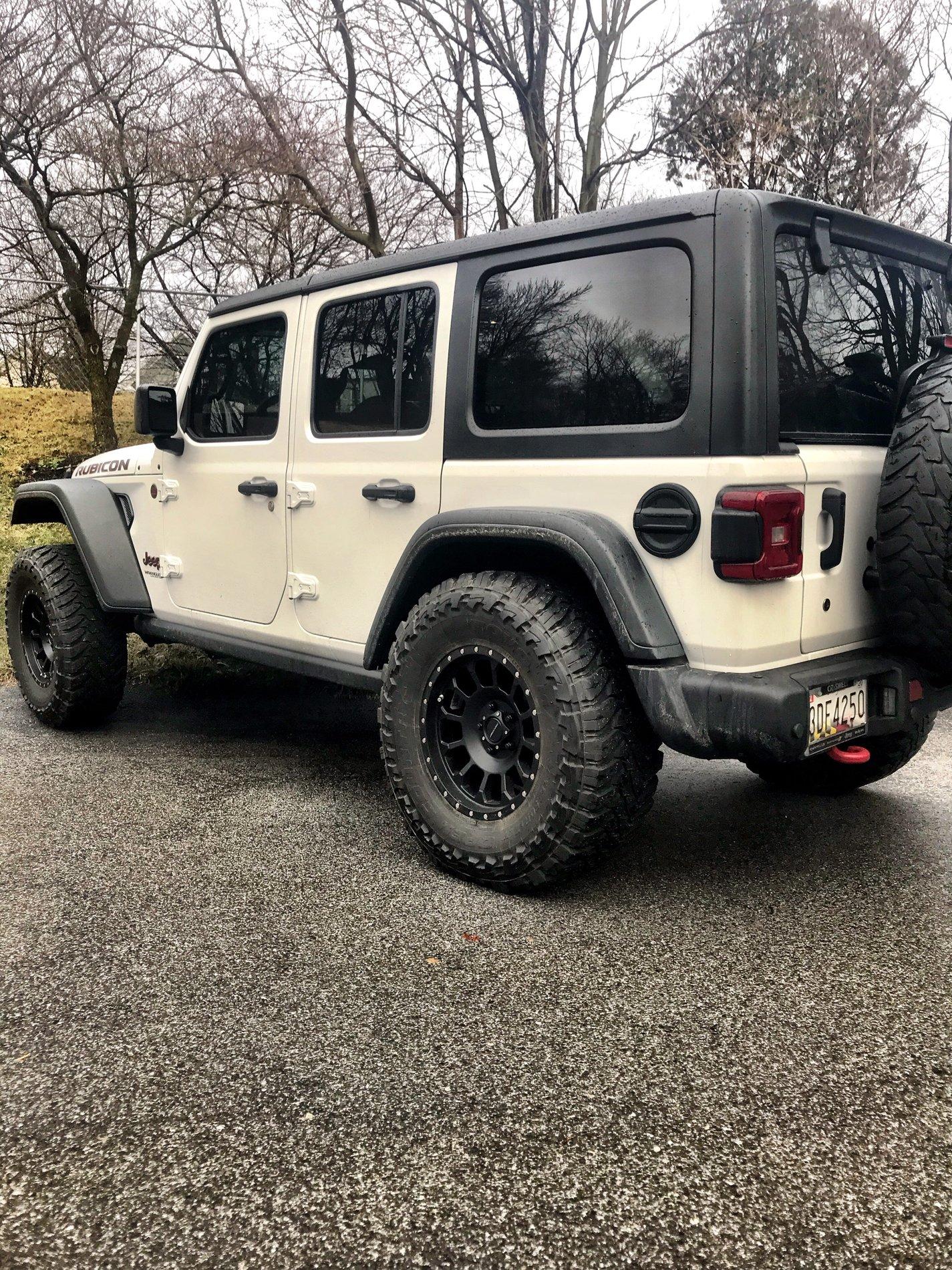

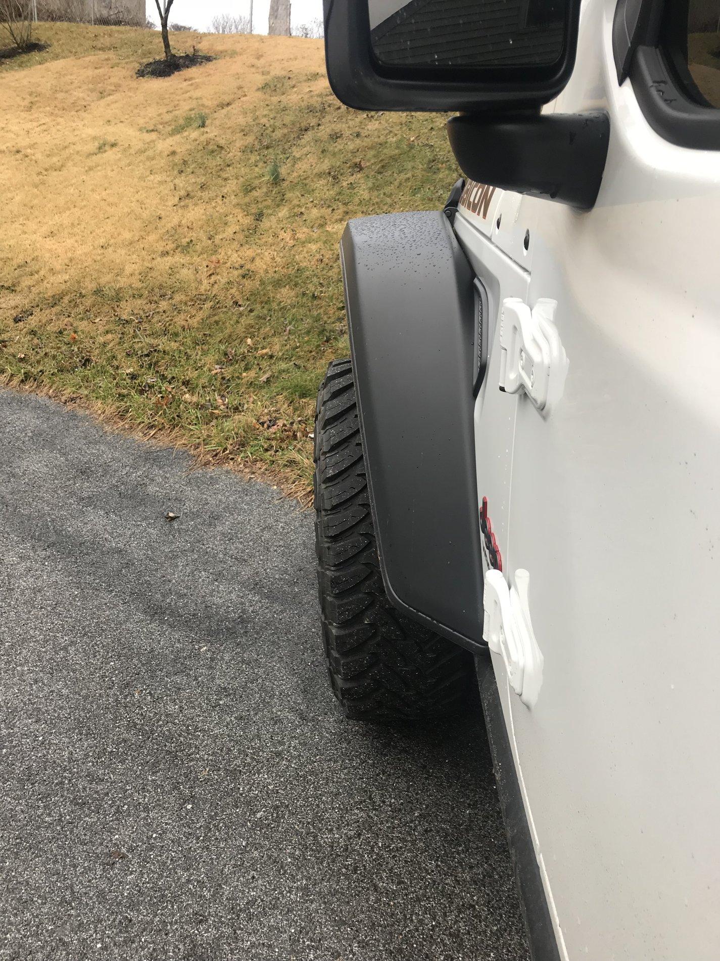

Here some more shots of the wheels and tires

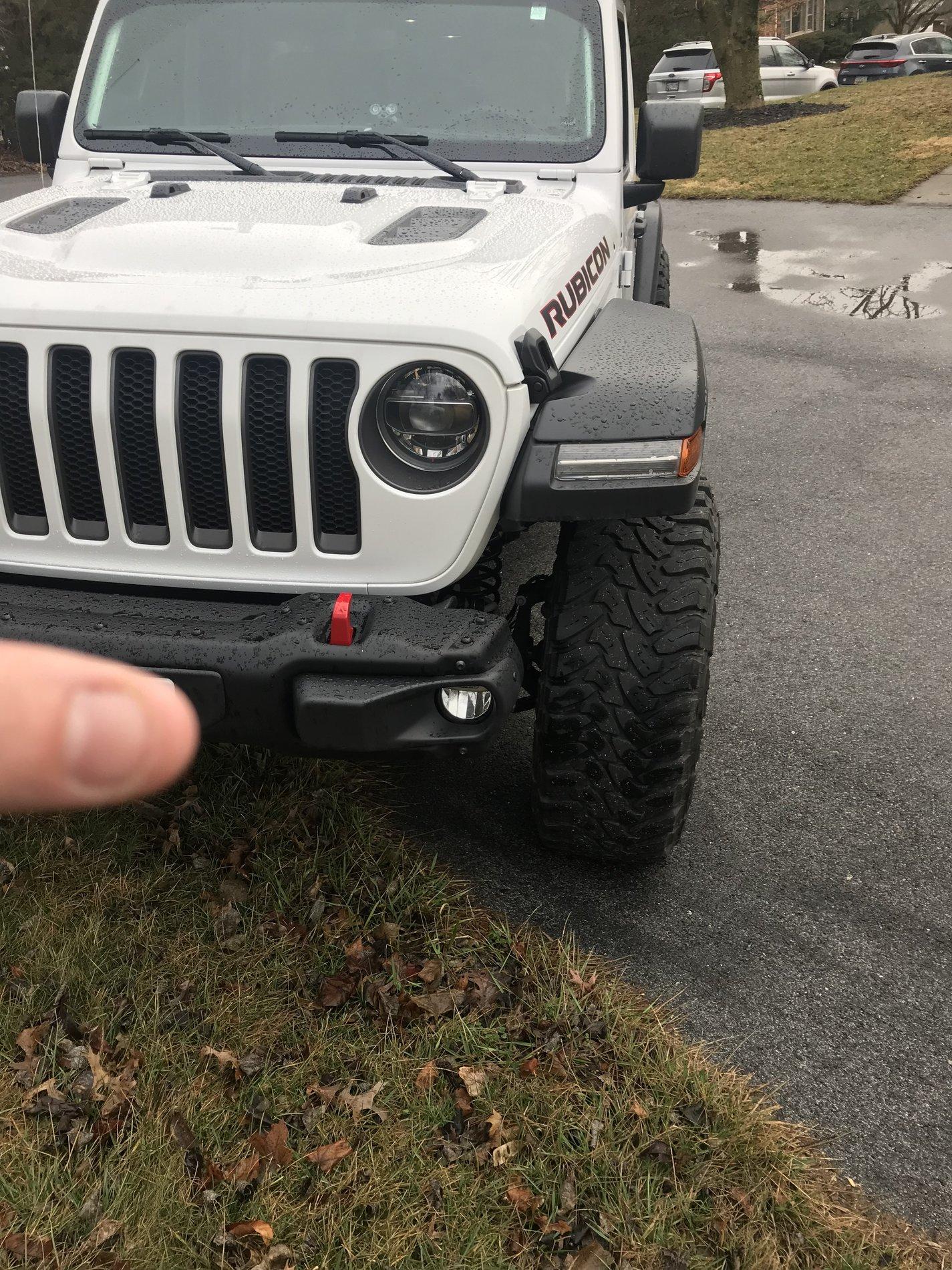

The gap between your tires and fenders seems dramatically higher up front. Is that from the heavier tire/wheel on the tire carrier or is there something else going on there?
I was sitting on a hill off camber
