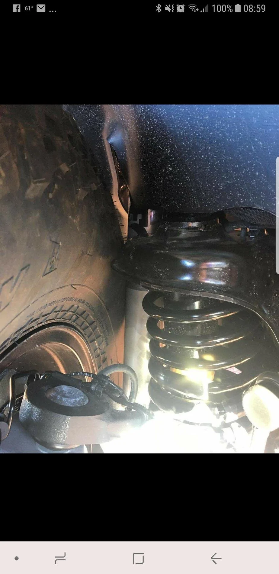

Here are 35x12's mounted on stock Rubi rims with a mopar 2" lift at full flex...rub is if full effect..
Texas comes through once again! Thank you. Back spacing needed! Save your old rims fellas... looks like at
Less 4” needed
Less 4” needed
No way less than 4" of bs is needed. That wasn't even needed on the jk. Seemed like 4.5-4.75 was the magic number for the jk. On the jk, I don't think you could even get away with a 285/70/17 on stock wheels without rubbing. With the JL you can easily, obviously. Also, which side was that on? Passenger? Isn't the lift shifting the axle to the driver side? Or is there an adjustment on the lift to center it? If not , you are reducing the clearance on passenger side. Just a thought. Seems like there are others where it's not a problem.
Axle is centered and it does it on all of the 3 lifted JL's the kit is on with the stock wheel set up. Ordering 3 sets of wheels to fix the issue. 35x12.5 on the stock wheel will rub at full tilt with wheel cranked. Falken AT3W used...
