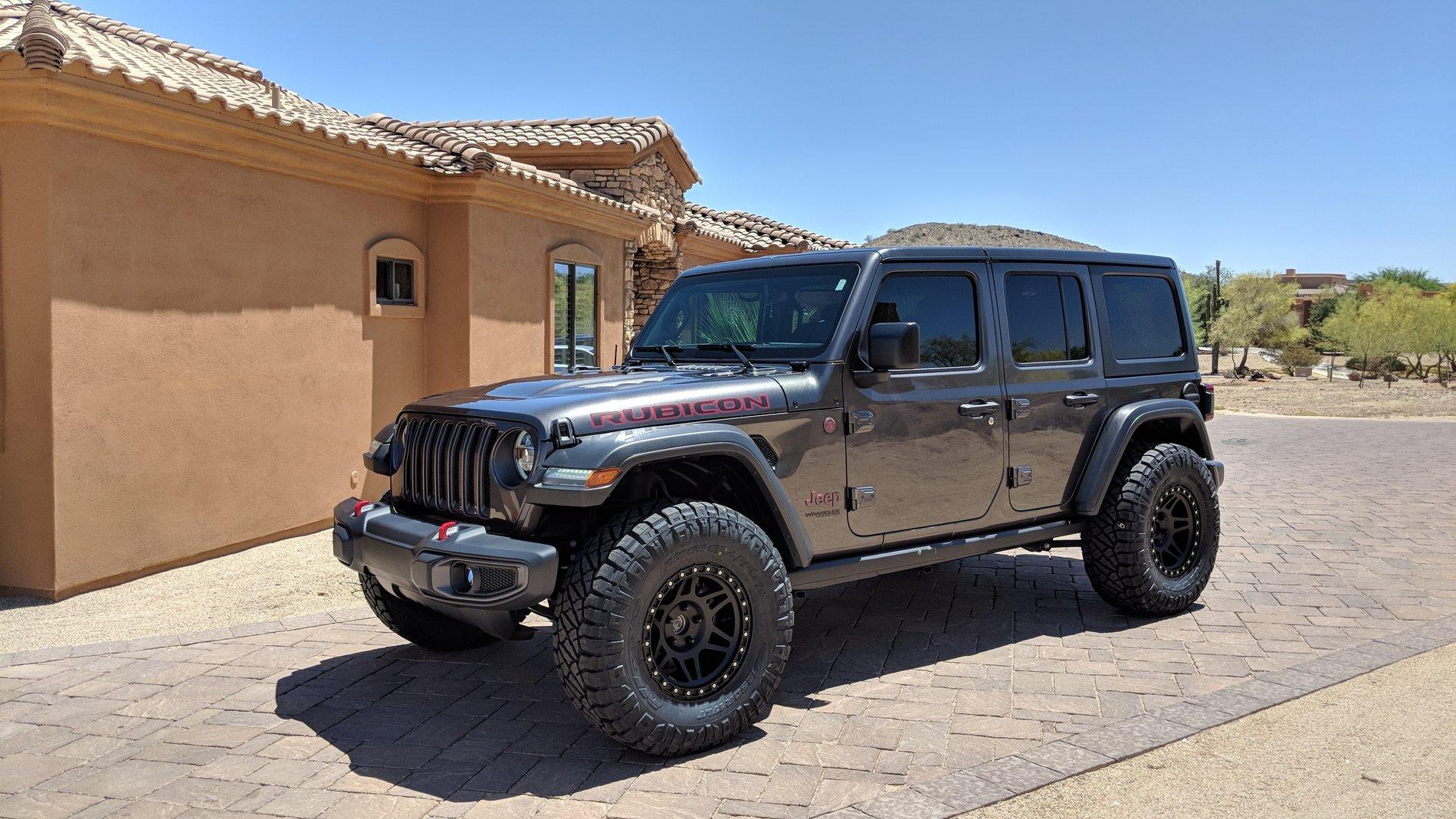

We have method racing mr312 17x9 wheels wrapped in nitto ridge grapplers 35x12.5R/17. The wheels are -12mm (4.5") backspacing on stock height Rubicon and fit perfect. Not to aggressive sticking out and they clear when the wheel is fully clocked left or right. So far no rubbing that I can see but I have not fork lifted it yet to max flex it out from all sides.
I just got the same wheels in. Looks great but I think they are 3.5 BS
