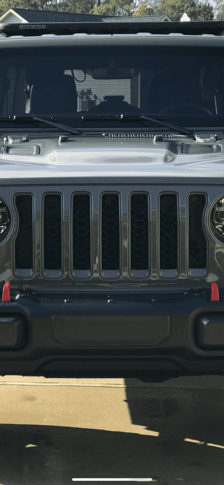

I'm not a diesel buyer, but I'm happy to find this thread of people who worry about the same things I do. I've long wondered about airflow/overheating with some of the bumper/light set-ups I see out there. I mean, maybe this stuff is all engineered in a way that doesn't obstruct airflow, but I'd be surprised. Engine cooling is kind of important, regardless of which engine you're running.
There's a reason Jeep had to engineer slightly wider front grille slats on the Gladiator to improve its cooling and tow rating. There's not a lot of frontal area to work with on these rigs.

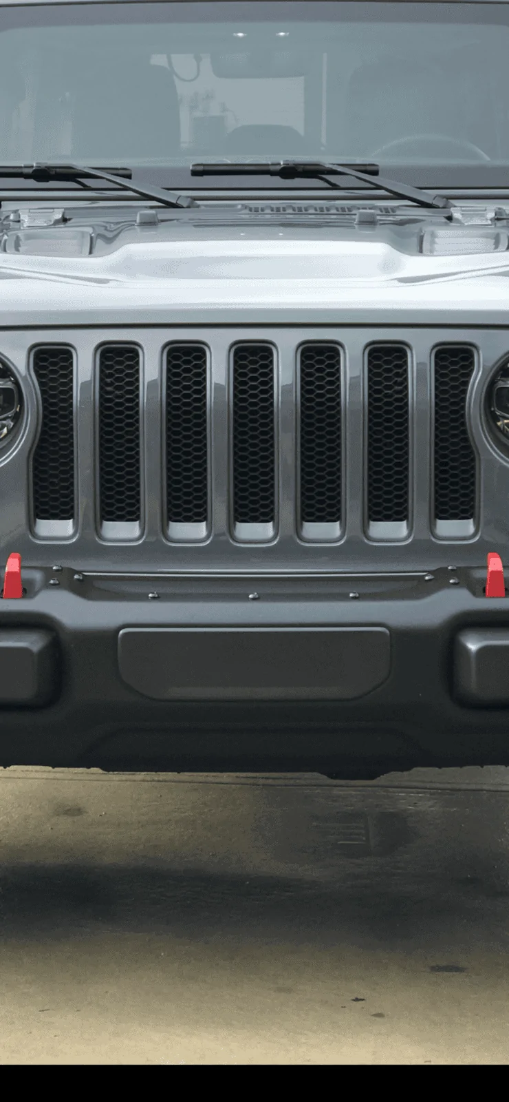

As LongTimeListener mentioned above, airflow across the radiator is what it’s all about. That’s all the electric fan is doing when it kicks on. I would encourage anyone who is towing in extreme terrain (high heat, high elevation, both) to swap their grille inserts for the gladiator ones. I did that to my JLUD and I’ve not run into any coolant temps higher than the 220s.
The inserts are cheap, they are 3 pieces and can be swapped out in about 30 minutes using hand tools.

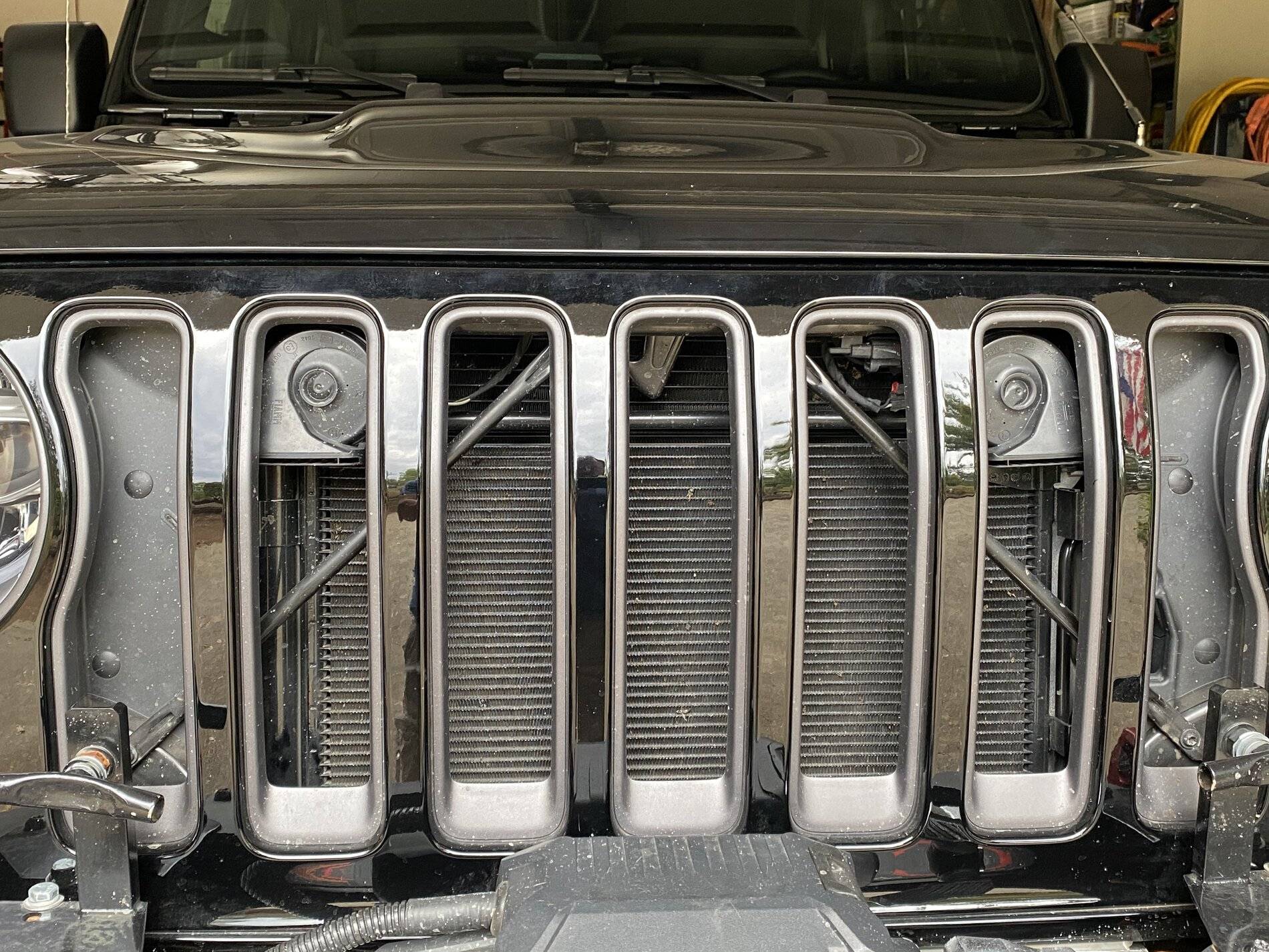

Those of us with the front trail cam already have the larger grill inserts. Ascending a grade in 115 degree heat doing 75-80mph, I saw temps exceed 240 degrees. Never noticed a power loss other than my foot backing off the throttle to get out of the boost. Once I did that, temps dropped drastically.

Grille insert will do nothing for the little baby fiat radiator they are using .

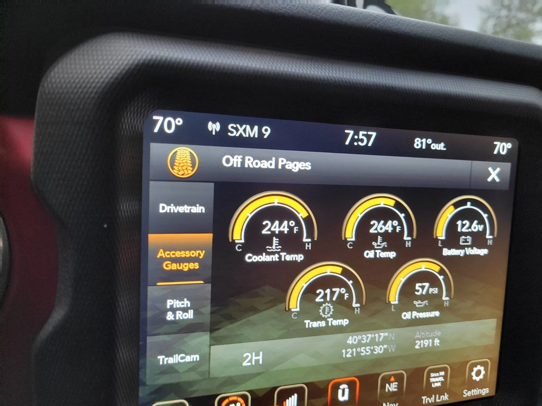

Someone posted pics earlier this week of the oil temps and it looks very similar to the inefficient oil cooling system on the 6.0 Powerstroke that drives up coolant temps. In the App/Offroad section of our head unit there are gauges that allow us to view our coolant and engine temps. I haul in the SouthWest and West coast so I have experienced many conditions like this with my HD trucks of almost all makes. It has gotten even worse since going to thinner oils and further EPA regulations since the manufacturers are trying to engineer modern diesels to operate at such high temps. The engine is basically already operating at it's threshold. Not good for the longevity of parts.

Agree all the manufacturers use heat to help with emissions. The more power and torque you need the higher the emissions go and the higher the heat needs to be.
With my ED temps have only risen when pulling a long grade at max GCWR. Coolant temps have gotten to 244 degrees on two separate occasions. The fan kicked in and kept the temps from continuing to rise. Ambient temps for one pull was 90 and the other 112. Many other long grade pulls have raised the temps to the 230 degree range. Driving style, RPM’s, play a huge roll with engine temps. More so than ambient temps.
