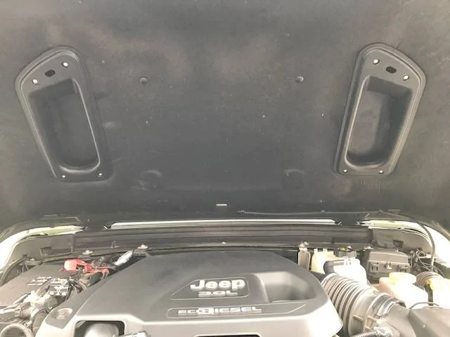

Last week, I pulled off the hood liner and opened the hood vents with a Dremel tool, to make them operational instead of cosmetic in hopes of getting some more air moving through the radiator because that is clearly the limiting factor. The only other thing I can see that would be an easy mod would be to move the horns, since they block the air flow to upper corners of the radiator. The grill inserts do block maybe 3/4” of the total width of each of the grill openings, and maybe the edges of the JT grill inserts are a little thinner? I haven’t checked that.

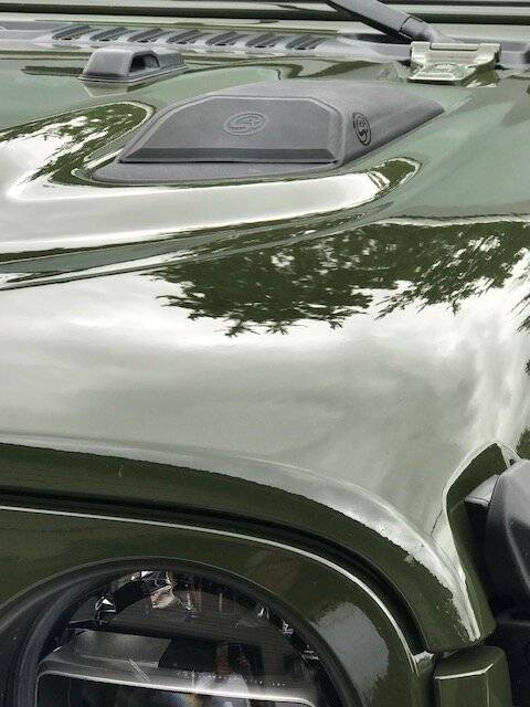

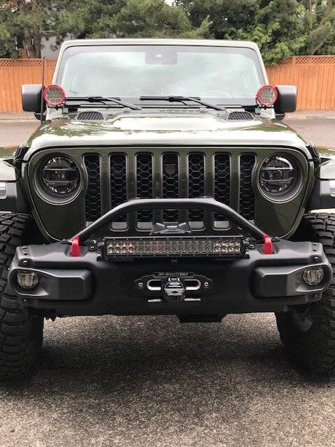

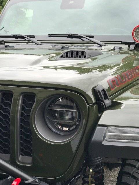

Doing the S&B Filters Hood Scoops on the JL and Gladiator. They seem nicely designed and have rubber caps to keep the PNW rain out when you don’t need the extra air. Monday was 116 degrees, today 71 so can’t make heat comparisons. Should be a fair start at helping with a little heat, air is being rammed straight in to engine compartment over exhaust. Moving the horns on the Gladiator this weekend since the bumper and grill will be off. Just off the insides of the frame behind bumper looks hopeful. Already have JT grille swap on the JL. @Mjolimar I‘ve pulled a 25ft travel trailer for 6yrs with my Grand Cherokee EcoDiesel. Motor has plenty of power just might have to baby the JL on hills with altitude. I always baby the GC, I’m pulling close to 6000lbs. We’ll put the JT to the test when we get the chance. (yes family of three EcoDiesels.

To waporvare: It is hard to tell if opening the hood scoops on my Wrangler has helped, as we have had outside temperatures that are in the 108-117 range for the past few days, so the darn thing is still as hot as can be. Once temperatures return to something like normal, I should be able to tell if it makes a difference. It certainly cannot hurt.
To Dezeljeep: The S&B scoops look interesting, but I would want them facing the other way, since I think the issue is getting air through the radiator and out through the hood, rather than in through the hood. If those do make a difference, though, please do let us know.

I’m on your same page. I was hoping a couple of months ago that If they made the Amfib snorkel for a diesel I would put one on each side and use them for air venting. That, didn’t happen so the thought is to take the left and right cowl covers from Mopar and create my own rear venting. Kid, said he could 3D print the vent at work and a little Bondo and sanding. It might still happen.

I really like both ideas. I might first try removing the hexagon in the OEM. I really like the super clean finish on the underside with the aftermarket though. Any thoughts there??
Edit: Remove the plate UNDER the hexagon shape...I made this mod the other day and there appears to be a noticeable drop in the average coolant temp on the off road gauge. So far so good...
Here's my theory but depending on how well it works, it could change...and this cost me nothing but a little time.
The engine compartment is absolutely filled, that we can agree on. The only way for hot air to escape is back down the firewall and that route is restricted. If incoming cool air has nowhere to go, it will slow it's flow through the radiator, essentially bunching up. Reduced air flow, reduced cooling through the radiator. This is my problem with hood "scoops"...you're adding air that cannot be expelled.
Modifying the OEM hood "vents" allows for more air to be expelled top and bottom and reducing the "bunching" effect from not having a place for hot air to escape to.
look at my attachment photos and you will see what I mean. So far this seems to be working and I have no money invested. There is a downside and that is water can get in the engine compartment, but it has not rained here in the southwest in 20 years...lol...but that side issue is something I'm working on...So, I prefer the "Hot Air Out" style.

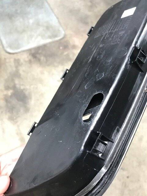

Also consider this, using the Tazer to manually run the cooling fan on HIGH is a huge benefit to expel unwanted heat through the hood vents.
Here's the underside...

I thought the hood vents were non functional?
DEZELJP
Paul
Nov 12, 2018
94
Washington
2020 JLURD, 2014 Grand Cherokee Overland Diesel
Here’s a pic of the underside of the vent. It’s none functional stock. They are cutting out the bottom lower half. You live on the right side of the state you can probably get away with running this way. I live in rainy Vancouver. I don’t want that much water in my engine compartment.
