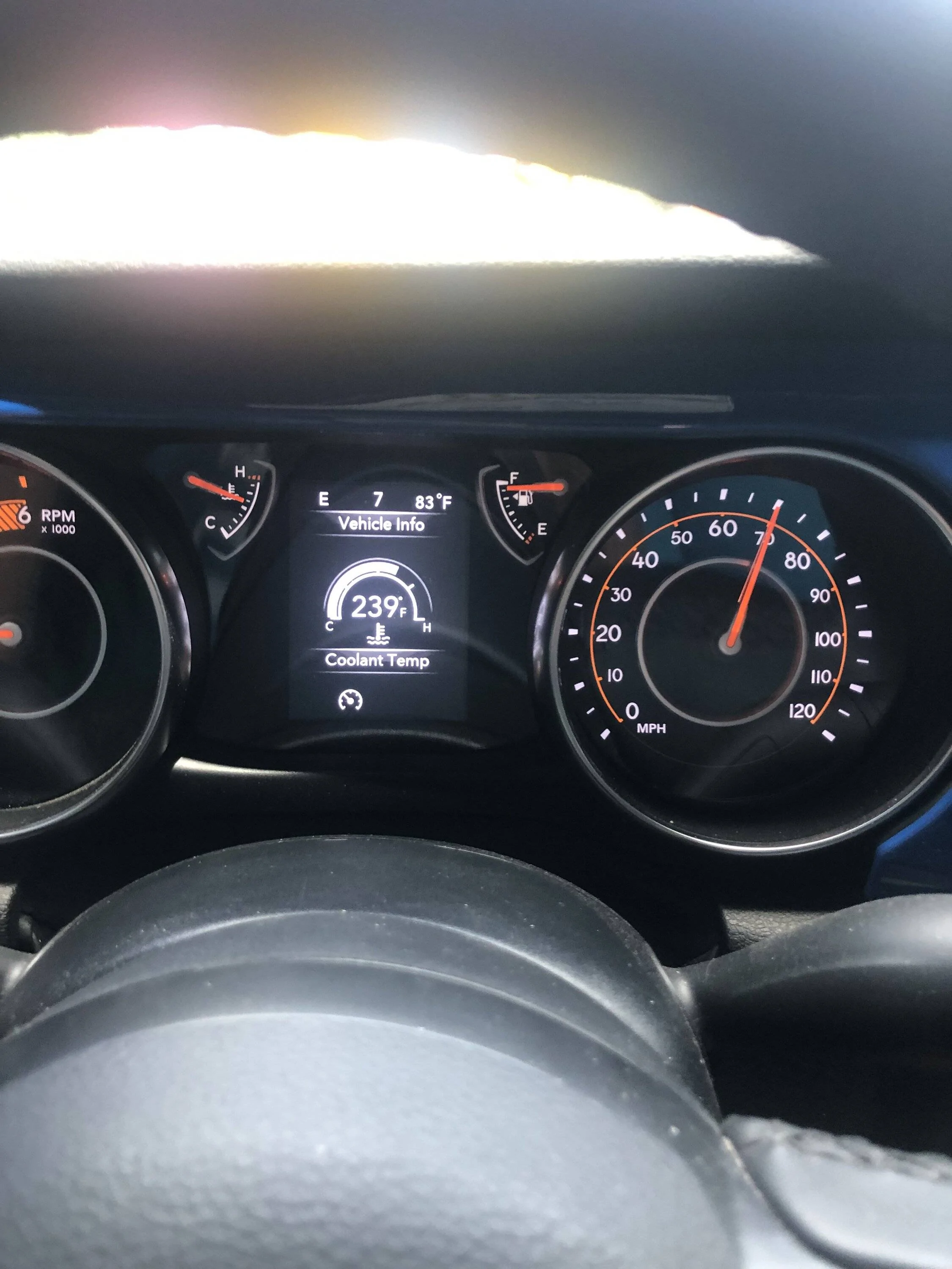

Hi Guys-
Has anyone experienced this? For reference-I live in Illinois, aka flat country. My coolant temp jumps over median at about 55+mph (highway speeds). Coolant levels are where they should be. But it is running extremely hot. Temp instantly decreases when I let off the gas pedal. Everything else seems to be running at normal temperatures.
I have a low-profile bumper and winch, so airflow is not restricted. I was wheeling this past weekend and was pushing it hard on rock crawling and it didn't go over median once. So, I'm confused on how and why this is happening at highway speeds when it is getting the most airflow.
Radiator has been power washed several times with the grille off to get any mud or dust in there. Its ticking me off that I can't figure this issue out and keep running hot. '
I need to figure this out before I head to windrock at the end of August so all ideas/advice please share.
Thank you.

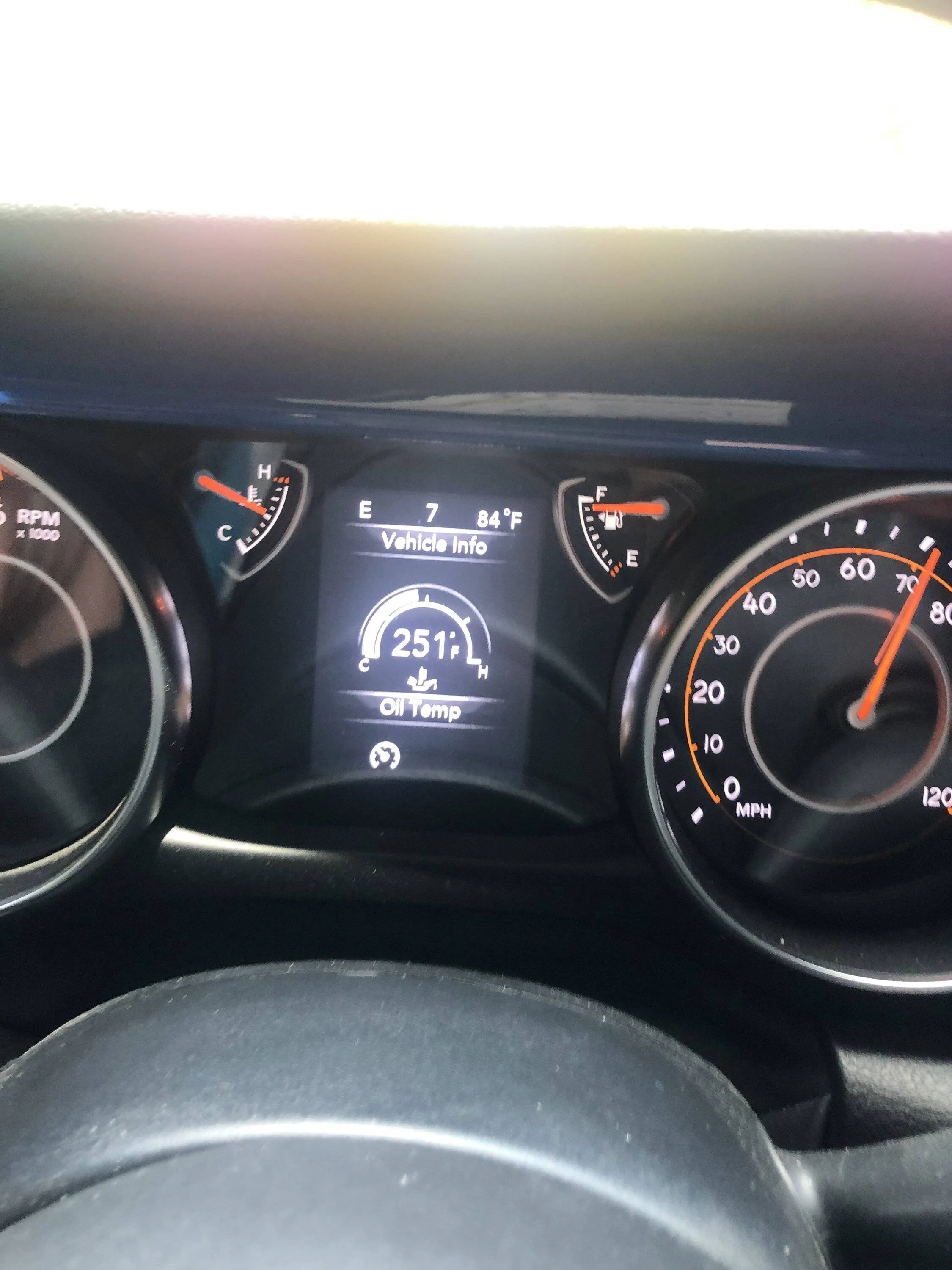

I have the same issue 16k miles running 226 to 240 coolant temps and 260 oil temps took to the dealer and they said it’s fine it’s normal and not to worrie if anything happens it’s covered under warranty but I don’t like that answer nore do I feel these temps are normal

Probably your case is the first one I would say is not normal. If you just accelerated to 70 in traffic, then your’s is normal. But cruising at 70 in FL. You should be around 225°. Make sure your fan is running properly. If it is, your water pump has an issue.

Oil temp looks normal, coolant temp is def hot......I was told that anything higher than like 220's,221-223 is a little warm. 229-230's would be cause for concern. I had a blown head gasket few months ago, was up to 250ksh. No Bueno. Jeep= Just empty every pocket for real, for real.

Sorry, 230 is normal. Fan turns on low at 226°. Takes a minute to settle at 230°

The diesels run hotter than the gas motors. I’ve got a 3.6L and a 3.0L, the diesel always runs warmer. My diesel is in the 1500 truck, which has a much bigger radiator and still runs warmer than the 3.6 gasser.
