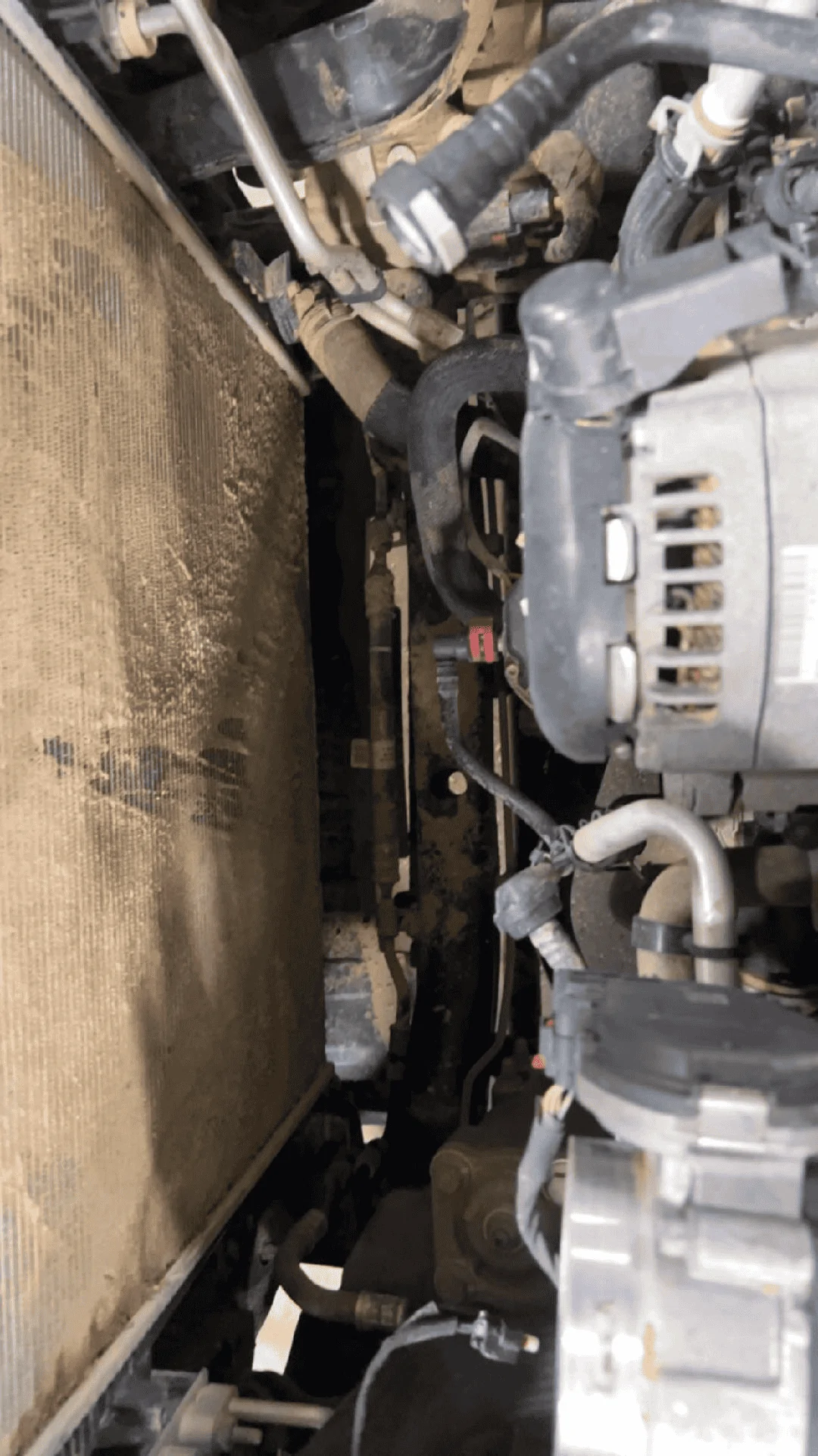

This similar thing just happened to me - 2018 Jeep Wrangler JL. I went to the ORV park, went through some pretty thick mud a few times. On the way home, would get really hot, when not accelerating would drop some in temp. Washed under the hood, what I thought was really good - no luck, still kept getting hot. Washed under the hood again - special attention to the radiator/fan area - again no luck. Took it into the shop, apparently the mud had packed the radiator fins - mud was almost like cement. Had to take it apart and clean it out - fixed - and luckily no damage to the engine.
Whoa!!!
Mud blocking the airflow in the radiator. I wouldn't have expected that. Yet... So logical with a Jeep.

One should never power wash a Radiator, because it can bend the cooling fins. Only use a garden hose, on the rain mode. So I suggest that you start by looking at you radiator cooling fins, to see if they are bent closed.
