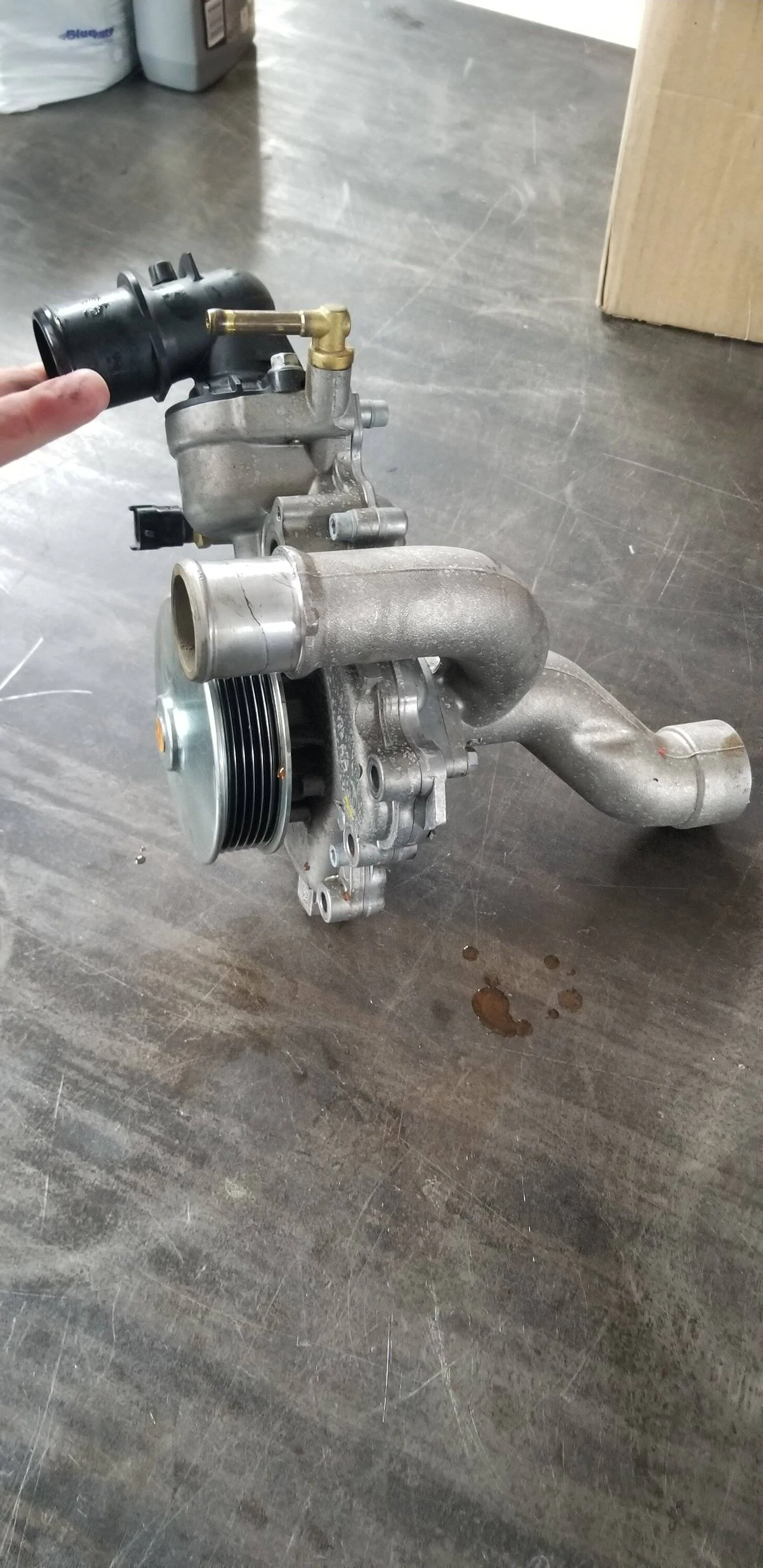

FOLLOWUP...The leak.
I had the Jeep up on the rack rotating tires and found more evidence of coolant...not enough to drip on the ground but traces under the engine. Did more inspection and found a small puddle under the water pump.
It hasn't been loosing much, just a "splash" into the reservoir about once a month, but had to add nonetheless. Figured the pump seal was leaking, called the dealer with my mileage, 36722, and they said "sucks to be you...you're basic warranty is a 3/36...WTF, just my luck.
Pumps are like $500 at the dealer, I found one on line (OEM MOPAR) for $350...(what a bargin...)
I tore into it today and it's not a job for the timid or unexperienced...ya are better off if you have a shop. It would be no fun in the front yard.

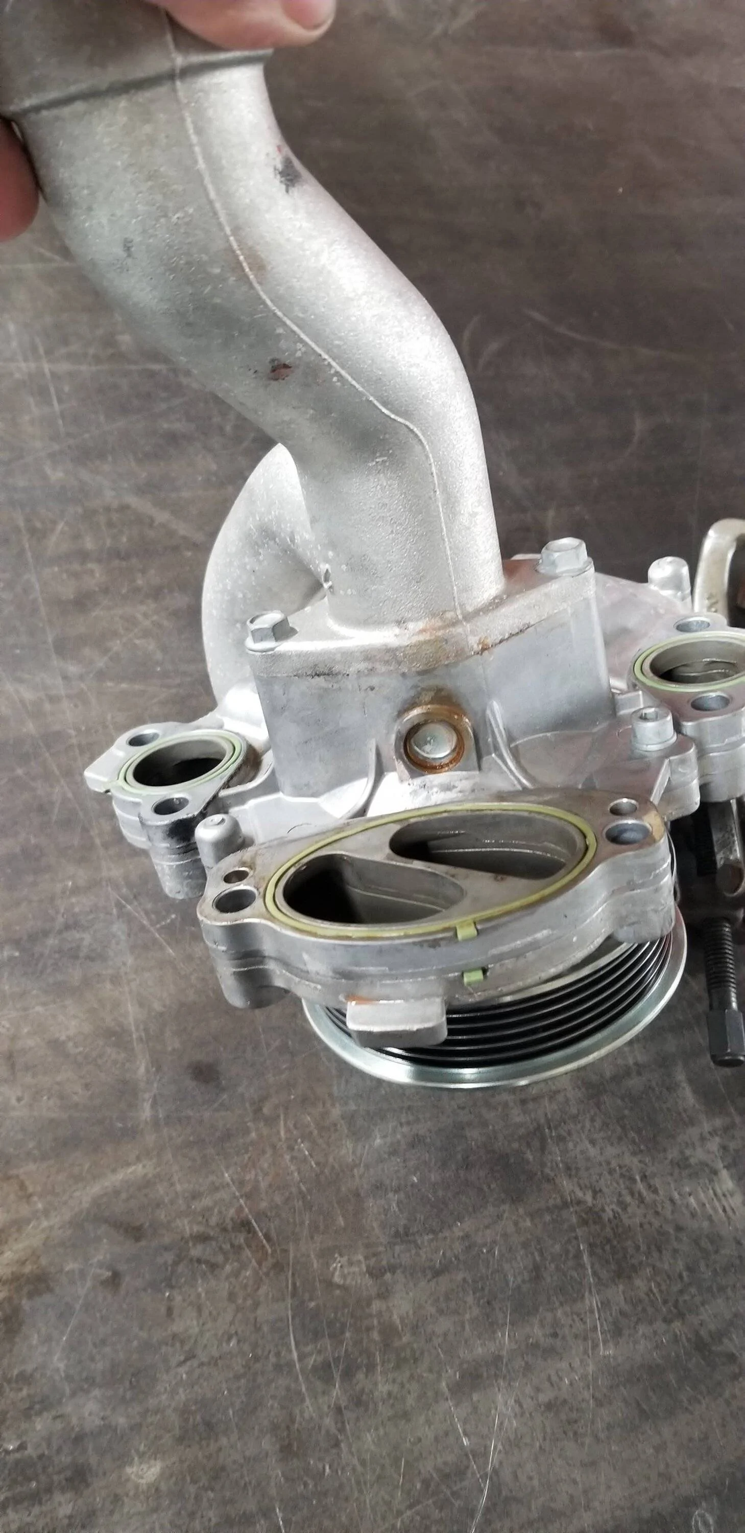

The leak was NOT the shaft seal. It was a freeze plug or if you prefer an expansion plug on the rear of the pump. Probably plugging some manufacturing process. This would be much better drilled and tapped for a pipe plug. Defiantly not the best engineering idea but obviously a cost saving idea.
Here's a picture of the pump and the plug. Watch for a leak, this could be it...I sure hope you never have to change out a pump...

garykk
Gary
Feb 12, 2022
945
940
Southern NM
2022 JLURD
Good catch…

When I called the dealer (65 miles away...) she was very nice and helpful. She said it MIGHT be covered but it would have to come in to be inspected, but there was not an open spot on their schedule for...TWO WEEKS.
All that just wasn't gonna work for me. I need the Jeep and I'm not going to drive it with a coolant leak that was of unknown severity and could burn up this engine. I just decided fugg, it and rolled it my shop.
Warranties are all fine and good but your ass is sure in their hands...and no one REALLY wants to work on your problem. It's a personal thing but I never purchase extended warranties...seems there is always some loop hole and I ultimately get the short end.
So...for the price of the pump ($350) and coolant, I'm it done and know it was done to my standard.
Here's something else...that problematic little freak'n expansion plug that caused all the headache got removed and a 1/4" NPT galley plug in it's place...it 'aint happening again.
