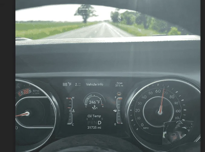

Hi Guys-

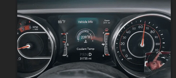

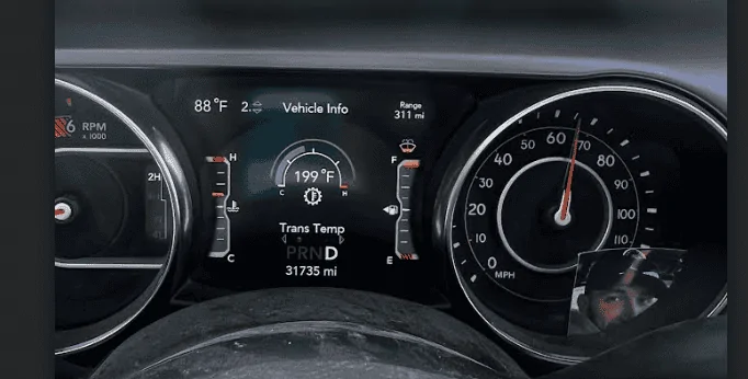

Has anyone experienced this? For reference-I live in Illinois, aka flat country. My coolant temp jumps over median at about 55+mph (highway speeds). Coolant levels are where they should be. But it is running extremely hot. Temp instantly decreases when I let off the gas pedal. Everything else seems to be running at normal temperatures.

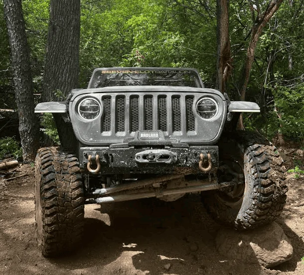

I have a low-profile bumper and winch, so airflow is not restricted. I was wheeling this past weekend and was pushing it hard on rock crawling and it didn't go over median once. So, I'm confused on how and why this is happening at highway speeds when it is getting the most airflow.
Radiator has been power washed several times with the grille off to get any mud or dust in there. Its ticking me off that I can't figure this issue out and keep running hot. '
I need to figure this out before I head to windrock at the end of August so all ideas/advice please share.

Those are some high temperatures but not completely off the chart. These Wrangler EcoDiesel configurations will shut down to limp mode protecting the engine from anything catastrophic. The cause is the engine bay is so small the engineers fit everything into this small engine bay. Example being the airbox found on the Ram is almost twice as large as these Wranglers due to the limited space. Don't forget they also had to raise the alternator for the water forging capability which is different than the Ram or the Cherokee that came with the Eco diesel. I live in one of the most hottest climates in the nation so I suffer from the same. The only time I've heard it causing a real problem is when you're towing. Too many people thought they could stack a rooftop tent pull a trailer and mash the pedal when climbing grades at extreme temperatures. You cannot treat a diesel that way if you do it will go into limp mode. A gas engine on the other hand doesn't have that protection and most times doesn't suffer from the extreme temperatures Wrangler owners are used to just mash in the pedal to the floor and running at a very high RPMs. These diesels do not like that. Even then as I mentioned it will go into limp mode to protect the engine. The fan may be extremely noisy but it's extremely effective that's why when you're wheeling you don't have the same temperatures. I would suggest turning your gear selector indicator on. Looking at your pictures you don't have this on and it helps to monitor your RPMs along with the gear when you're experiencing these extreme temperatures. These Eco diesels have a sweet spot where they like to run you need to know the RPMs along with the gear when operating a diesel correctly. Hope this helps. Water is the most effective for heat displacement I will run higher percentage of distilled water in my radiator during the summer than I would during the colder months of the winter this has helped a small amount

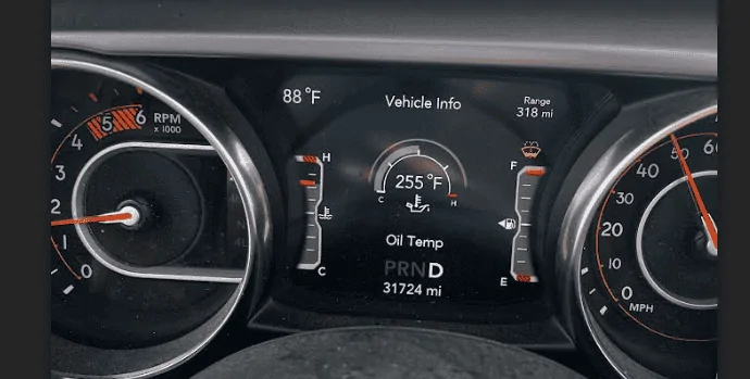

While I agree with everything you said, that coolant temp is unusual. Even when my oil temps were hitting 240-245* pulling a trailer up a grade I didn’t see coolant temps that high. I agree that he may have a bad thermostat or EGR issue. It’s worth looking into.

Thermostat not opening all the way, EGR cooler issue, or (and hopefully not) a blown head gasket. If you are maintaining coolant then it is likely the thermostat.
I have written these down for potential issues- I have an appointment with the dealer on the 14th as she is still under warranty. Thanks for the info and Ill update it once I get it figured out

Your oil is 255 on flat ground?
