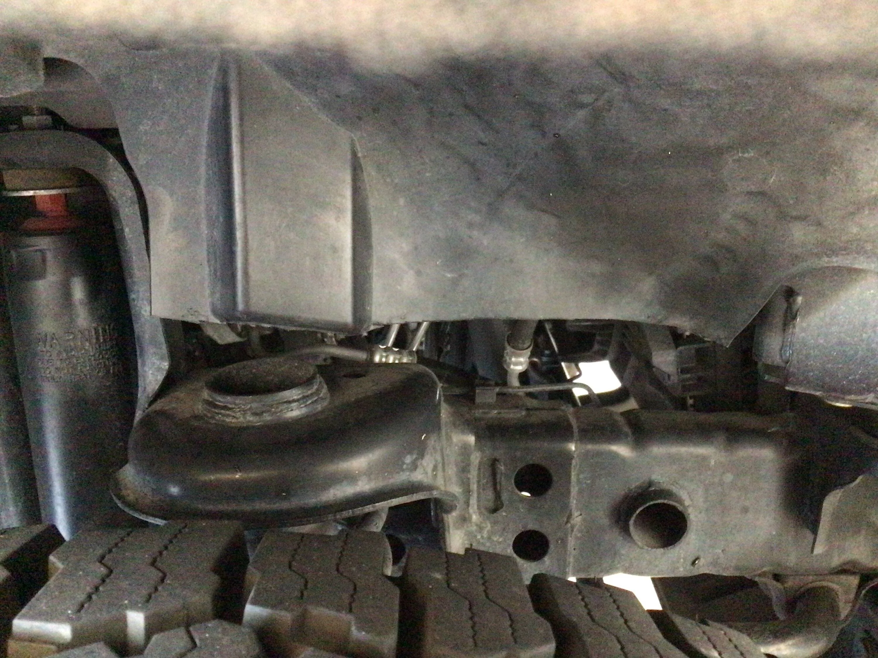

Just cut a piece out of the inner fender, from the front to the shock. This is a PIC of my JKR. But I also did this to our JLR. The engines cooling fan doesn’t have to work as hard, plus it move additional CFM through the Radiator.
Im going to give this a shot. Thank you
Any other tips to lower temps?

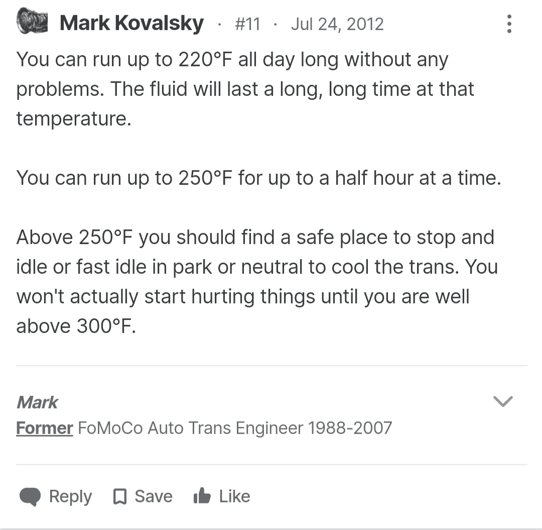

I'm guessing a lot of us are new to diesels. Thankfully I have my dad who has a wealth of knowledge about many different types of vehicles. However rather than writing a page of information that no one's going to read, here's a link to a diesel forum and a screenshot of the post that pretty much tells you everything that you need to know...
https://www.thedieselstop.com/threads/how-hot-is-too-hot.305213/
Jeep Wrangler JL Overheating... Screenshot_20230714-191357-081
