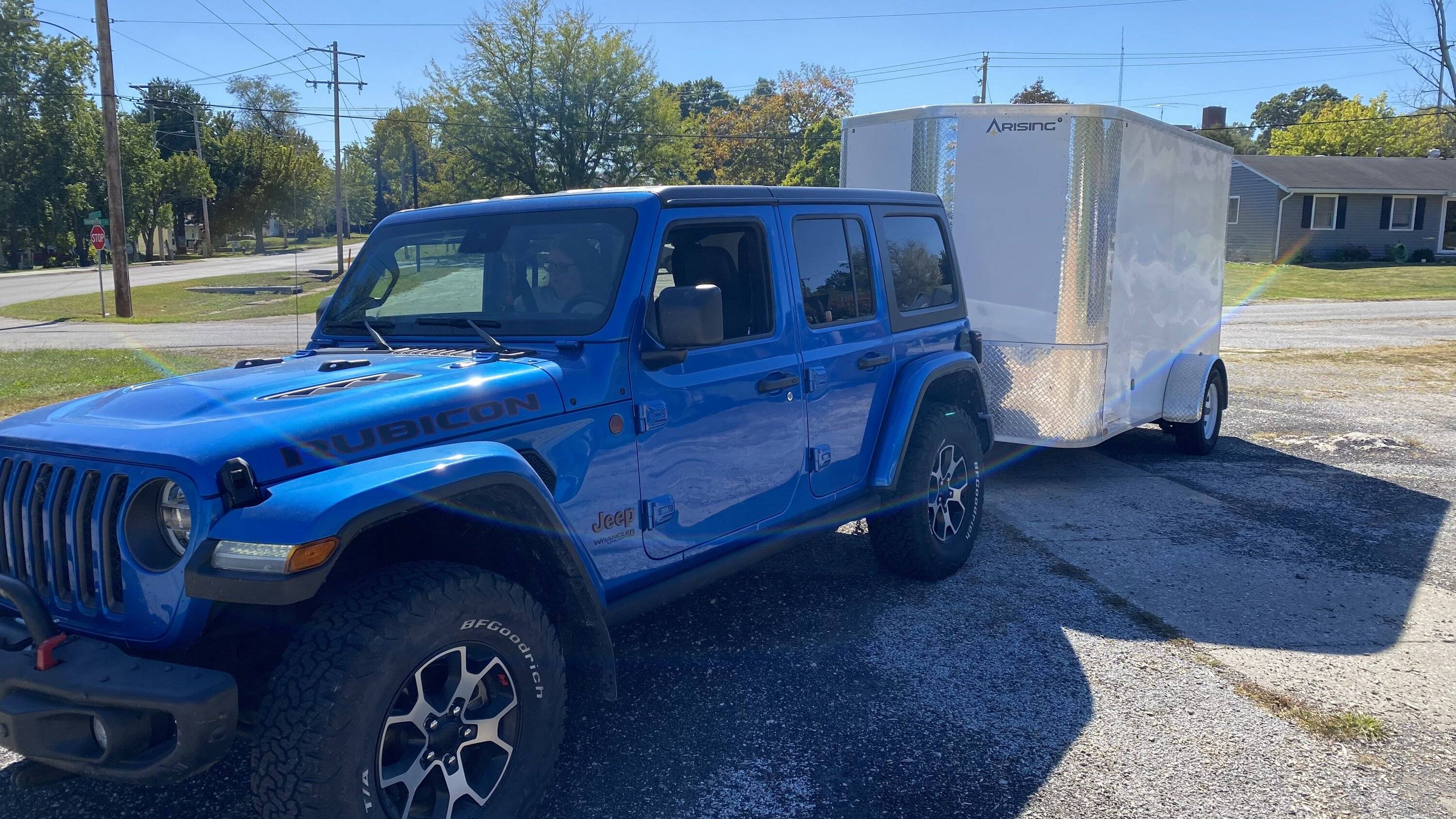

Thought I would share:
2021 JLURD, 33’s, steel front bumper with winch (down behind). I have the front camera, so wider grill mesh, and a RockJock base plate. Pulling a 6x10, v-nose, single axel cargo trailer, total weight about 2000# that is about a foot and a half taller than the Jeep. 3 of us inside, all at around 200 lbs, plus a cooler.
Initially had a 3/4” squat at the rear tires and a 1-1/4” rise at the front tires.
Moved some stuff around and got the rear squat to about 1/2”.
Just completed a trip from near St. Louis, MO to just north of Salt Lake City, UT. Route: I-70 west to I-29 north, to I-80 west to I-84 west, then north a bit on I-15.
Started at elevation 542’ slowly worked out way up to 8638’ (with a few climbs) and then back down to 4226’.
The diesel didn’t miss a beat. No “super big” climbs, but some long burns. None of the temps ever passed the half way mark on the gauges.
Started out running at 65-70 mph to get a feel for the trailer and milage. As we got further west, limits increased and so did our speed. 75, 80, 85 mph with ease. Only dropped into 7th or 6th gear 3 or 4 times. Milage danced around 16-18 mpg on the open road. I could get that up to about 24 mpg if I dropped about 5 mph and tucked in behind a trucker, using his draft. On long, flat runs that would increase to 28-34 mpg.
I found using the adaptive cruise control, set to max distance, was the best way to maximize mpg. Find someone bigger than us and drop in behind them to draft. Anticipating lane changes became a “game” in my mind as we would pass other vehicles, still drafting the vehicle in front. It was also helpful in construction zones, as it slowed down and maintained spacing as the speeds fluctuated.
Overall, a great run with no issues. Diesel was a joy, with torque to spare. The trailer was non-existent, except on conc pavement, when we got the bouncy-bouncy from the pavement joints. Nothing bad, just irritating! Might look into an equalizing hitch to smooth it out.
