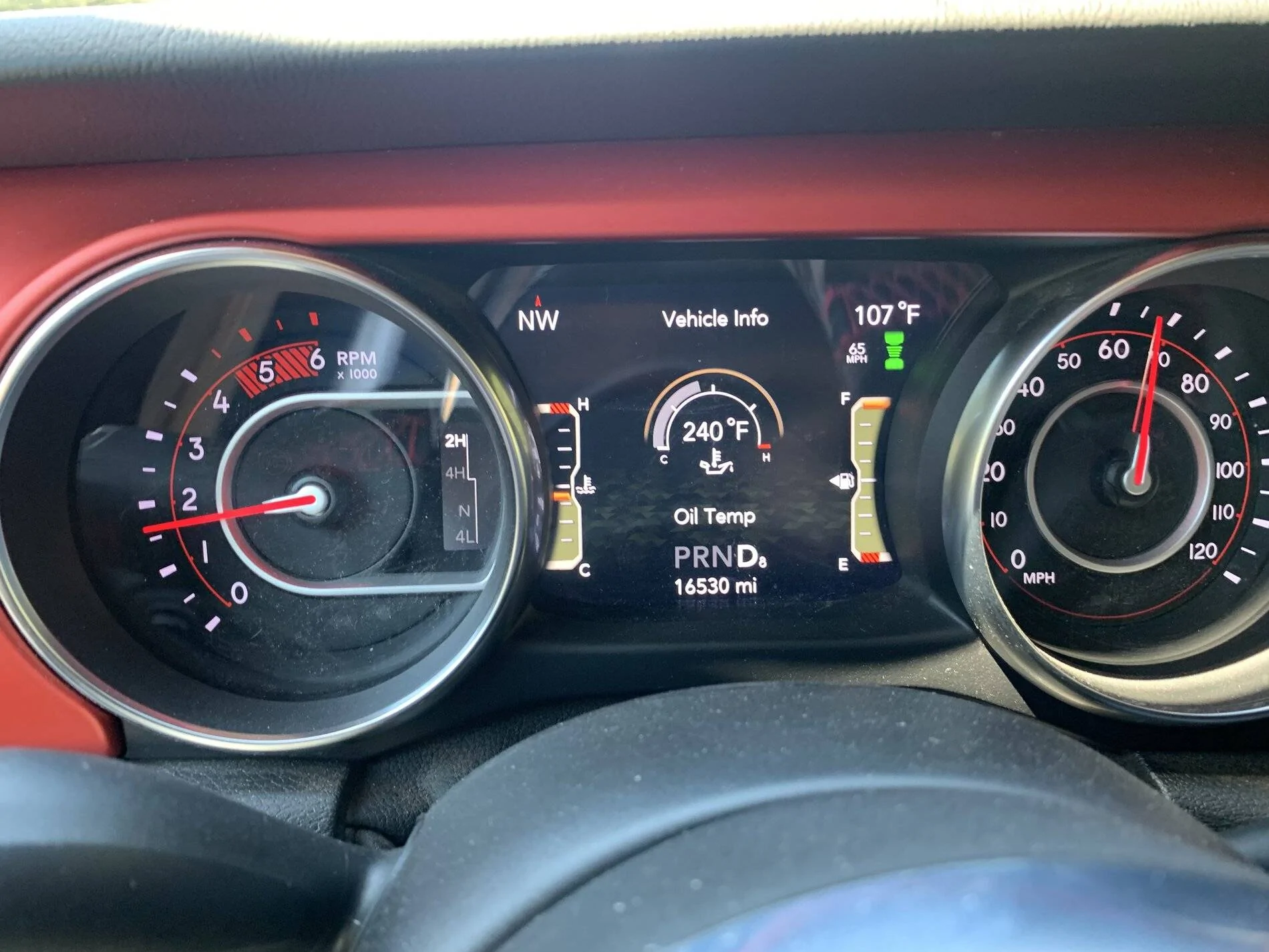

Alright I’m going to give you the truth according to two new version eco diesels. Just returned from Moab doing a 10 day family road trip. Driving a 2020 JL Rubicon and a 2021 Rubicon Gladiator. Both Diesel of course. Your diesel does not like the heat, the altitude and the RPM. Your Eco Diesel will protect itself and shutdown if you are pushing these. Your oil temp will hit which appears to be as we tested about 248 degrees. It will shut down and not let you push over 2000rpm. This means you will not be able to even hold the 80mph speed limit. Ram diesel owners have already experienced this and have been trying a variety of mods so they can tow their trailers. This is a dash pic with the outside temp, oil temp. The Gladiator carrying more load experienced this issue before JL did. No, neither had a lot of weight. JL had a cooler a suitcase, three passengers, normal tools, winch, running 35” Mud Terrains.
We have not had time to research this any further because we are headed out of town again. (Sorry if I’m slow responding to forum ahead of time.) Gladiator has hood vents already ordered to see if this helps since it is on the road again. So there is the truth.

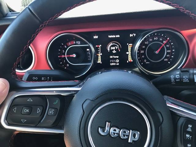

The little diesel DOES run hot...too hot for my liking, but it is what it is I guess.
The TAZER with the latest version allow you to manually run the electric radiator fan on HIGH rolling down the road. I find if I start the fan before actually encountering a high temp condition (ie. steep grade etc.) it does help keep the temp down on the off road gauge.
With all this said...For instance, I've scanned the entire engine with IR at many different temps and nowhere have I found anything as hot as what the digital gauge is reading..(except the exhaust amnifold...DUH...lol). I sure wish I knew where they were the sender is and how they are getting the readings.
