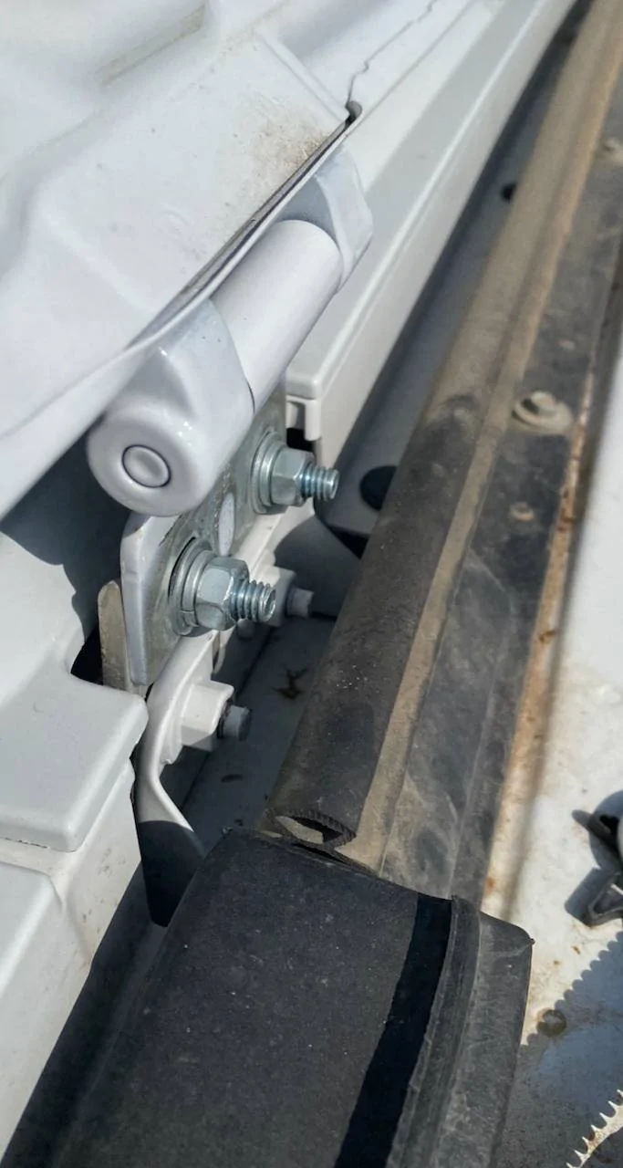

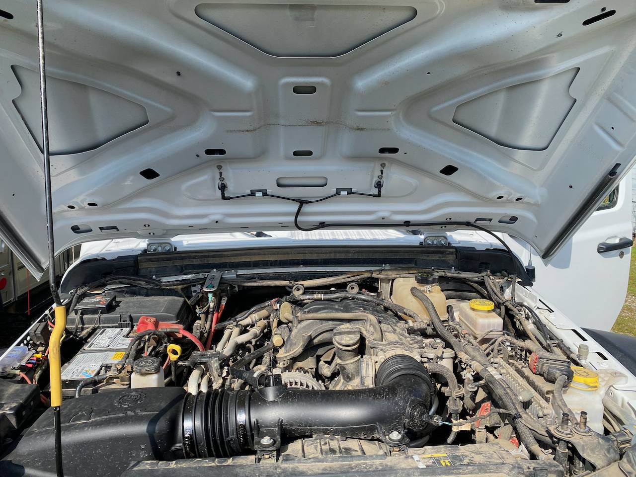

My simple DIY hood hinge extension vented underhood hot air really well. I also pulled the plastic engine cover, hood sound liner and installed the JT grill screen.
Jeep Wrangler JL Is overheating an issue? hood hinge extension a
Jeep Wrangler JL Is overheating an issue? hood hinge extension c
works for me

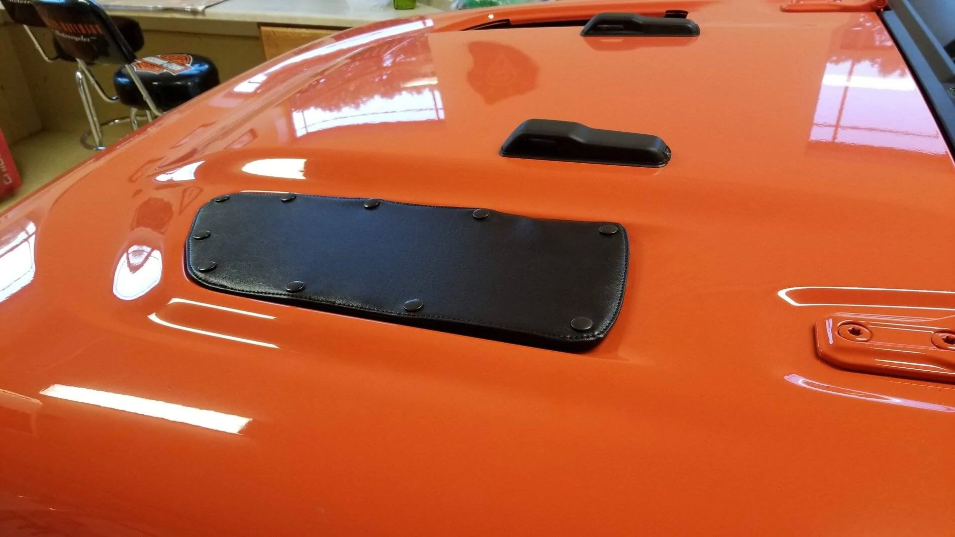

Plongson
Paul
May 8, 2020
60
432
589
So. Utah
2020 Wrangler Rubicon JL Diesel, 1984 Jeep Cherokee XJ
Retired engineer and business owner. Vibration analyst, reliability specialist.
I made my hood vents functional and here's my answer to water ingress...I bought some marine grade vinyl, made a template and had a local seamstress sew covers. I found stainless marine grade snaps on Amazon and...VIOLA!!
Pop them on in an instant, roll 'em up and tuck them under the seat when not needed.
The delta in the coolant temp reading is very noticeable with functional vents. I believe every little thing will help reduce the temp issue with this little motor...

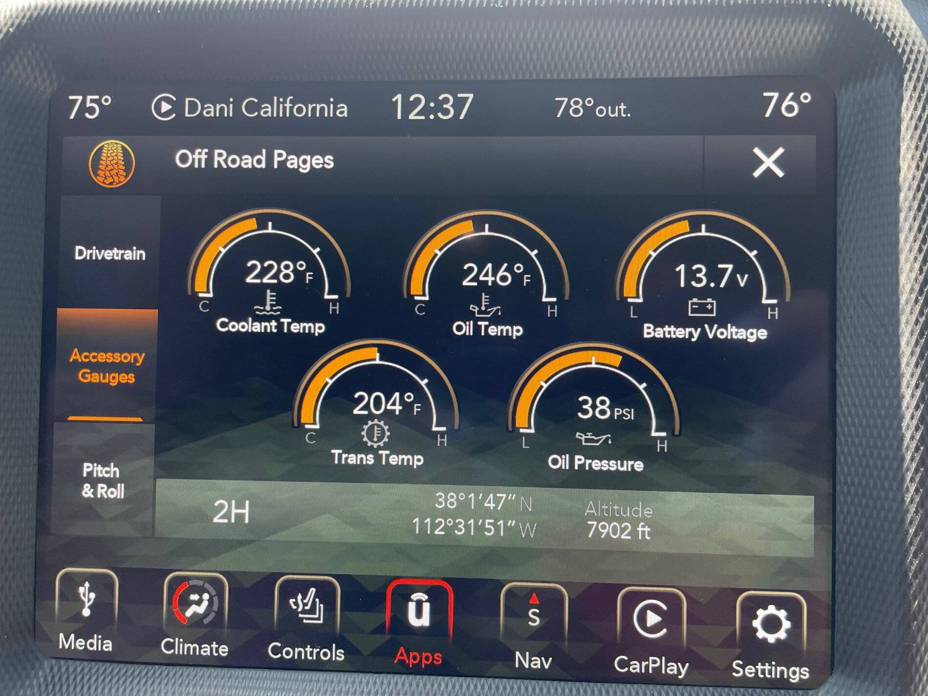

On my way to Salt Lake City today and on two separate highway climbs of 6% or greater I’ve seen 251 degrees F on my oil temp as I crested the hills. I’m not towing, and I’m able to maintain my cruising speed of 75 mph (the speed limit). Thankfully no engine codes or power reductions.
The 37” tires and lift have taken a noticeable performance toll as it’s not accelerating nearly as quickly as it used to on these grades. The heavy wheels are quite obnoxious on road imperfections too.

I have consistently found oil temperature to be higher than both coolant and transmission, even around town. These photos were taken last weekend while cresting 6-7% grade highways at 70+ mph in Arizona and Utah . . . and YES, elevation is a huge factor when towing and I WASN'T TOWING . . .
