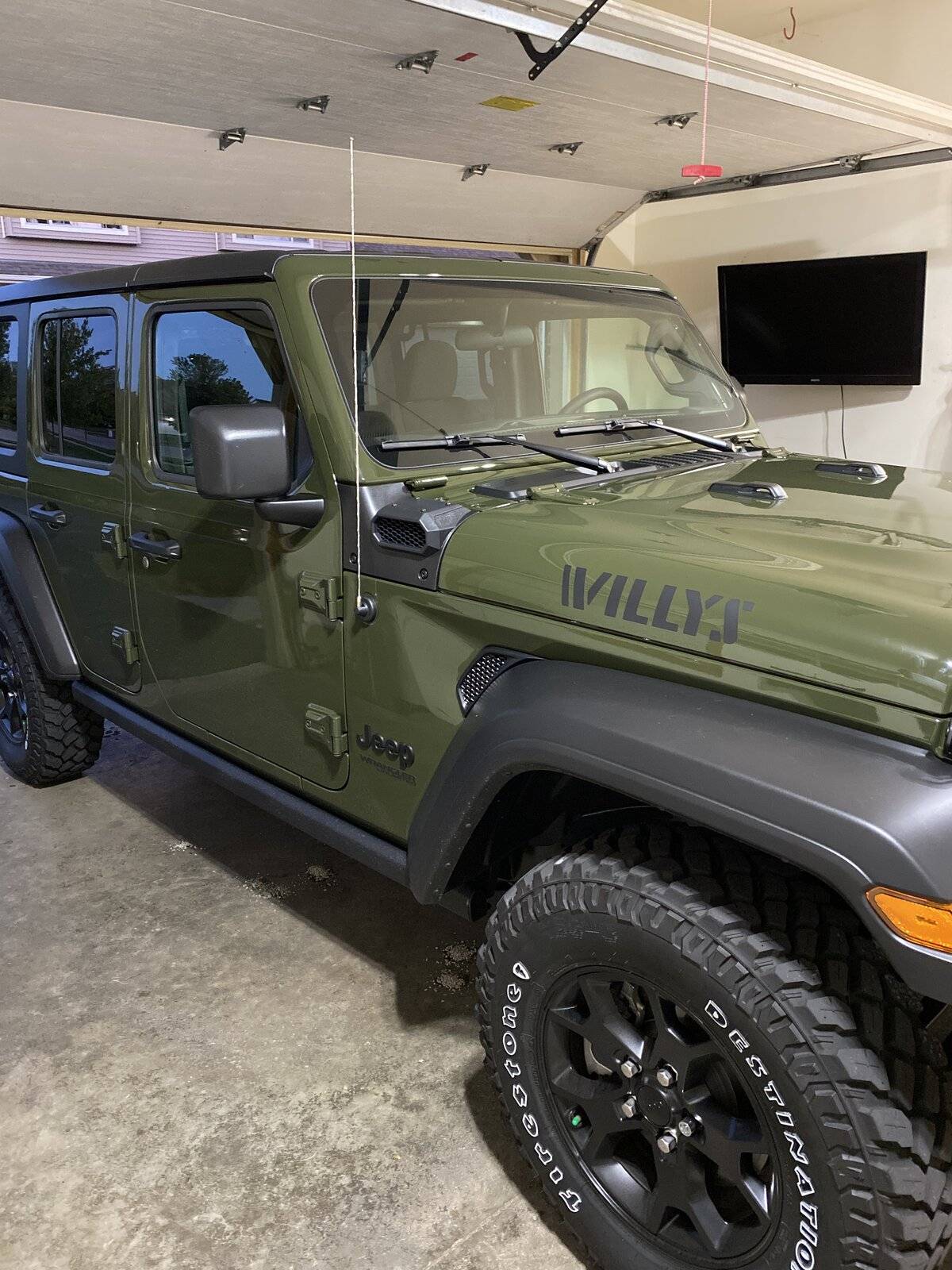

So I’m here to stir the pot on this old thread. I have a 2020 Willys 3.6 and have a CAI(of sorts) with a K&N drop in filter in the original housing and air system. I bought the “Short Snorkel” set up and it pulls air from the passenger side fender (near the windshield). It gives a throaty growl but not very loudly, it is all because it still has the factory air box and piping to the throttle. If I were to swap out just the piping to a more straight (and without the resignator) then I’d hear the intake much louder.
Can you show some pics from under the hood?
