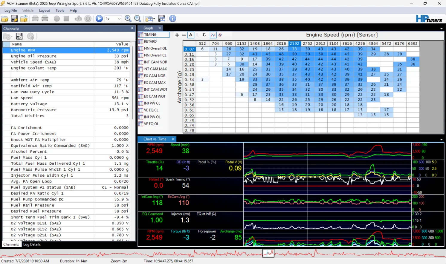

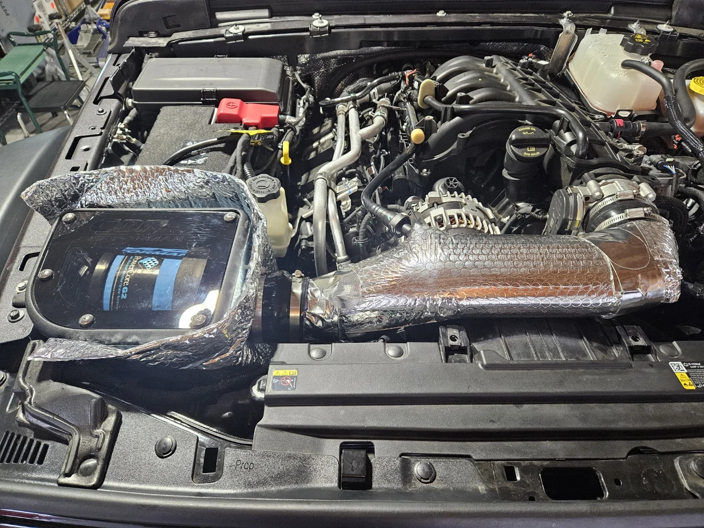

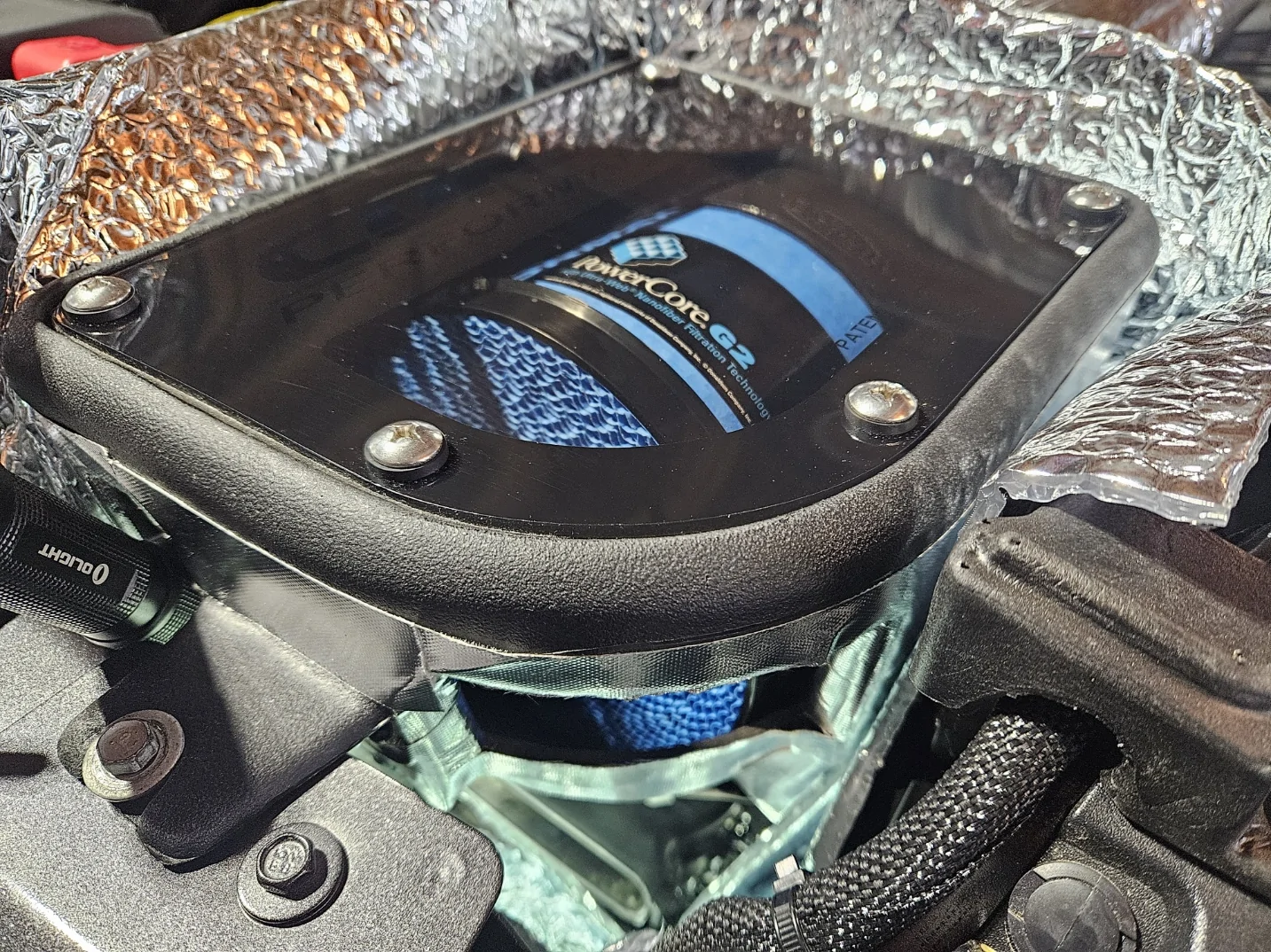

The Corsa intake box is wrapped in Cool Tape and fully enclosed on sides & bottom with Reflectix R-21 insulation. The Corsa intake tube is fully wrapped with Reflectix ... Data logging & intake air temps to follow.
Cleaned up my "CAI" insulation around the Corsa intake ports a bit to ensure good breathing & cool air from the stock jeep snorkel (visible in the bottom center of the second picture below).
The Good News is I got a great hour plus log from a cold start with highway cruising, back road barnstorming and lots of trips to redline.
The Bad News is when I went to save the log my fat fingers missed the Save icon and clicked the Open icon instead which instantly vaporized my sweet log to the great bit bucket in the sky. SMH! So, no log for you today, sorry. Little ticked over here.
Anyway, I DID review the log while driving and before dumping it, and it appeared the intake temps didn't get much more than 10-15 degrees above ambient the whole time, which I think is pretty good. Now, I was moving most of the time, I suspect sitting & heat soaking would yield higher intake temps at least til you get moving again.
I will let the jeep sit overnight and give 'er another go. I do it all for my esteemed forum-mates and "The Science"! 😄
The Bad News is when I went to save the log my fat fingers missed the Save icon and clicked the Open icon instead which instantly vaporized my sweet log to the great bit bucket in the sky. So, no log for you, today. Sorry. Little ticked over here.
I will let the jeep sit overnight and give 'er another go. The things I do for my forum-mates!

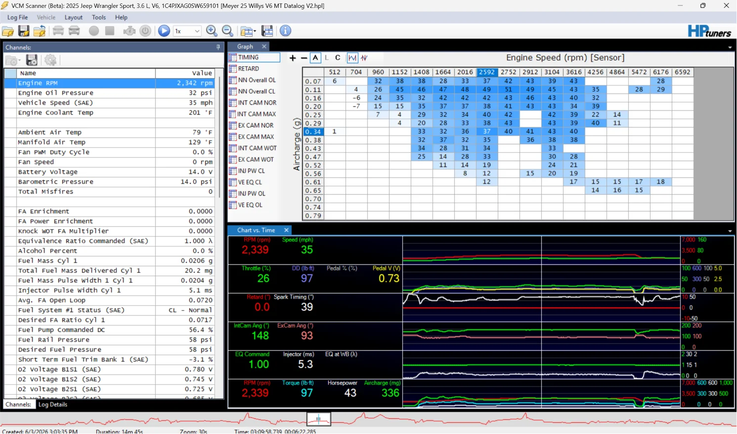

Reviewed Dave's logs. First one is from back when we first started logging before he insulated his intake tube. Log date is 6/3/26 and ambient temp was 79 degrees F. Screenshot below shows intake manifold temperatures hovering around 129 degrees during a light cruise around 35-40 miles per hour. I usually see 125-140 degree manifold temps during cruise and similar ambient temps on all JL Wranglers with cold air intakes. Usually stock intake is on the lower side of that and "cold" air intakes are on the higher side of that.
Jeep Wrangler JL Cold Air Intake hogwash Screenshot 2026-07-09 081419

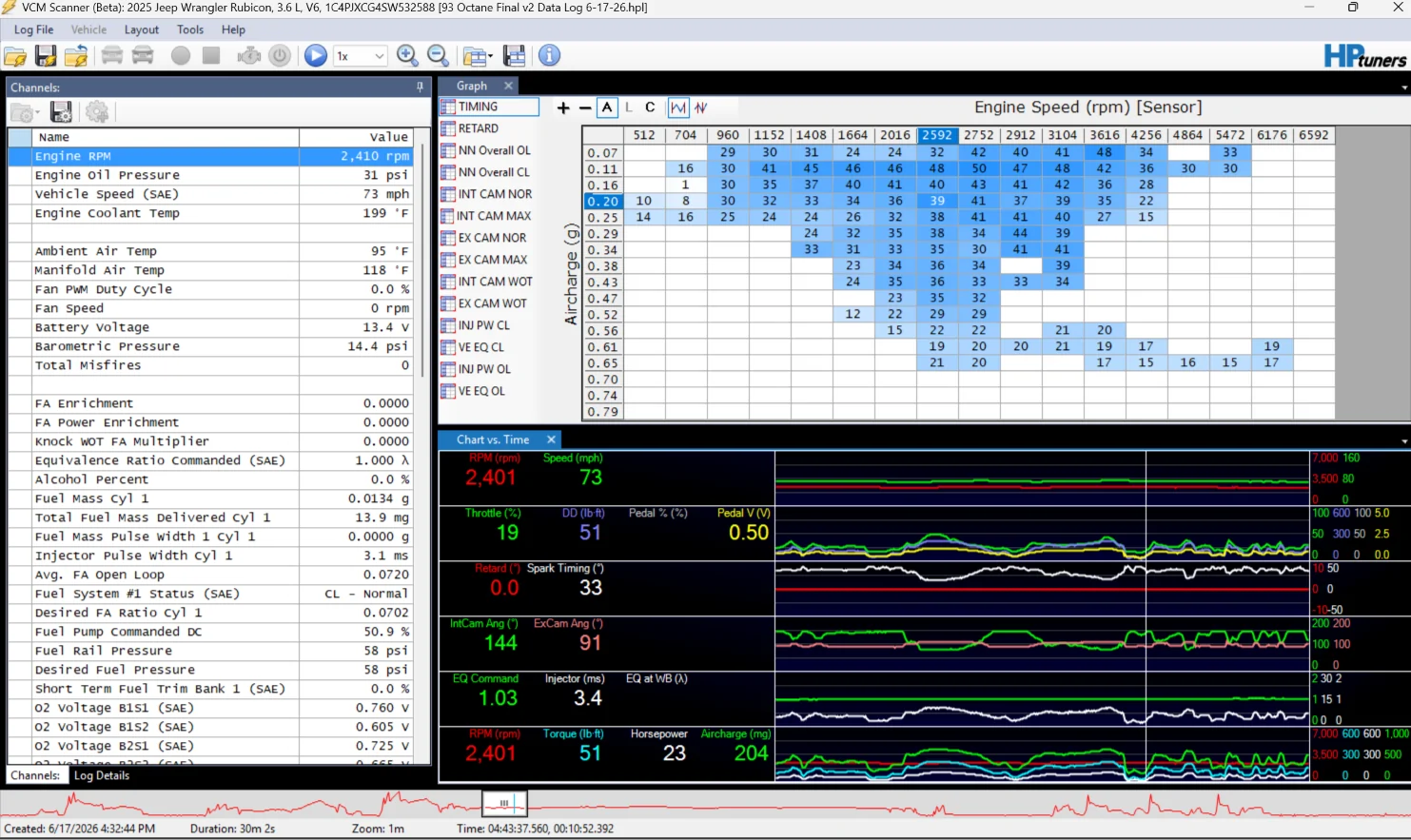

Cary, I pulled one of your logs, your stock intake did a much better job of maintaining colder air temperatures at even higher ambient. Here is a cruise at 72 miles and hour, with ambient temperatures way higher at 95 degrees. Your manifold temps with this high ambient temp hovered between about 112 and 120 in similar conditions as Dave's fancy pants intake with ambient air temps significantly higher. Here is Cary's data at interstate speed with the factory intake in hotter weather....
Jeep Wrangler JL Cold Air Intake hogwash Screenshot 2026-07-09 082824

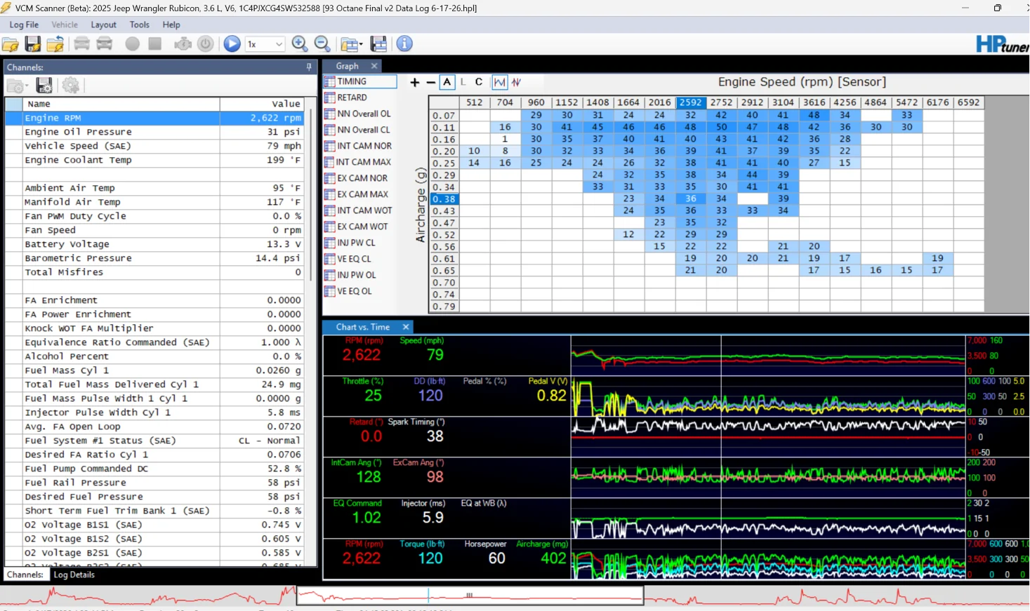

And here is Dave's with his fancy pants intake at interstate speed (yeah, not exact same speed, but as close as I could find). Virtually the same manifold temperature. But his ambient temps were lower.
Jeep Wrangler JL Cold Air Intake hogwash Screenshot 2026-07-09 082956
In conclusion, a cold air intake is not really helping cool your intake temperatures, and could be even making it worse. Insulating your new cold air intake will help, but ultimately, the factory system does the best job keeping temperatures in check.
