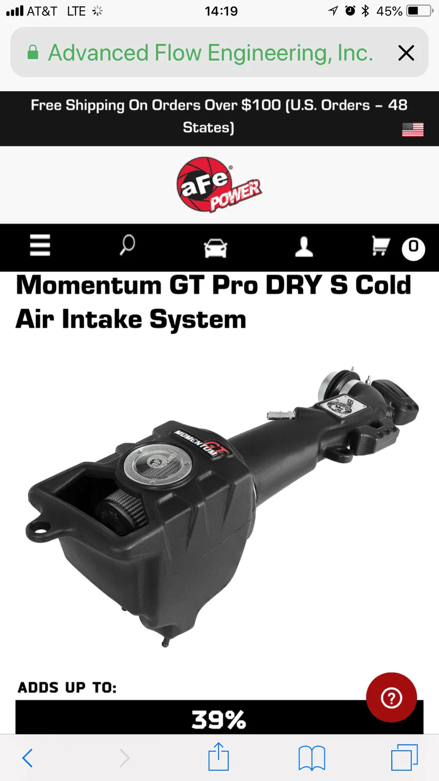

Thanks for all the support folks. My JLUR is my daily vehicle, no wheeling at this point. I seen an aFe that’s encased, seems as if it’d take a pool of water to do any damage.. I did put a Gibson slip on, on her & she growls. Not super throaty & no drone as of yet “but as it’s breaking in” I do hear a little more humming on the freeway.
Thanks again..
