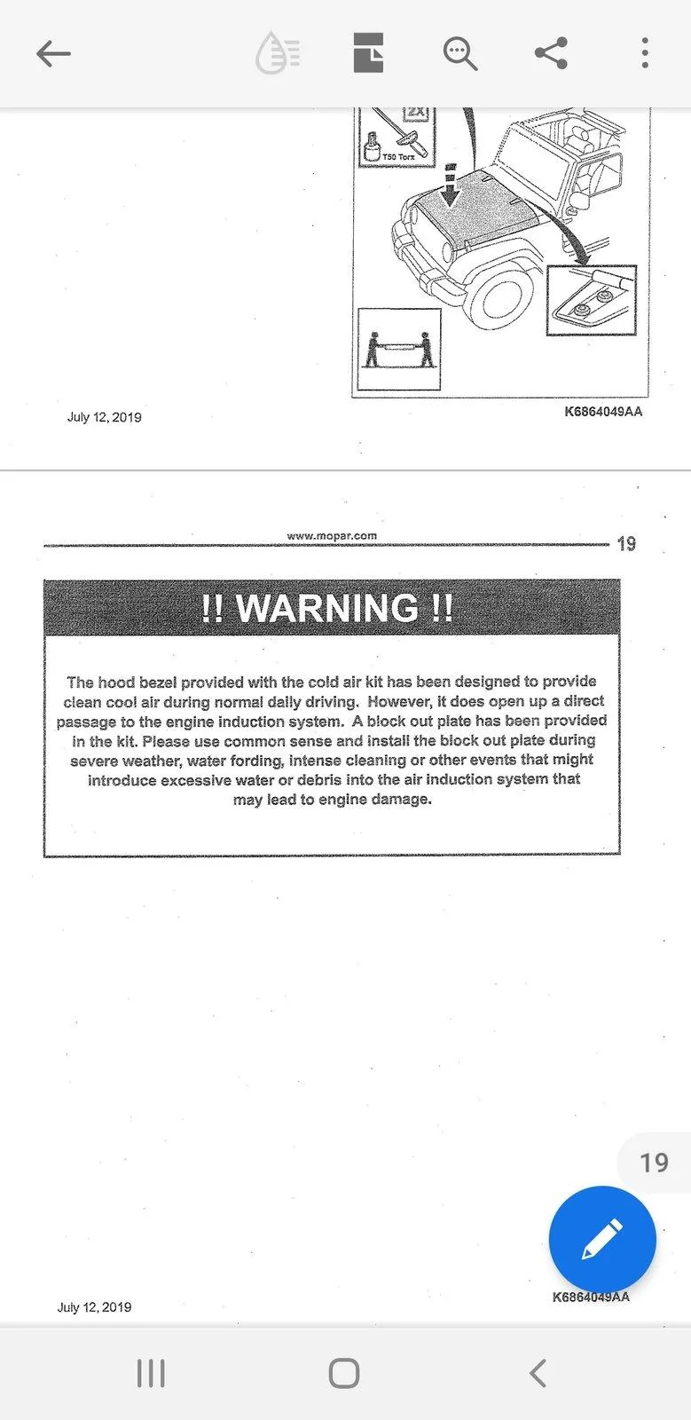

I just purchased the kit from the dealer, however I’m hesitant to install the vent due to the warning on the box. Why would it have this crazy warning If they are being sold And installed as a factory option?
Instructions also say this.....

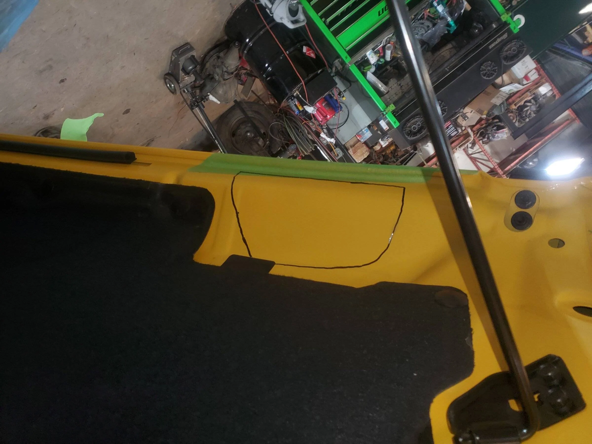

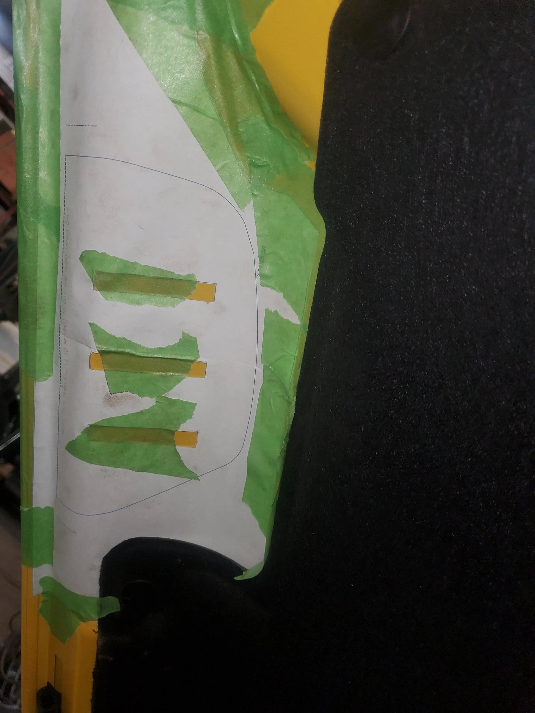

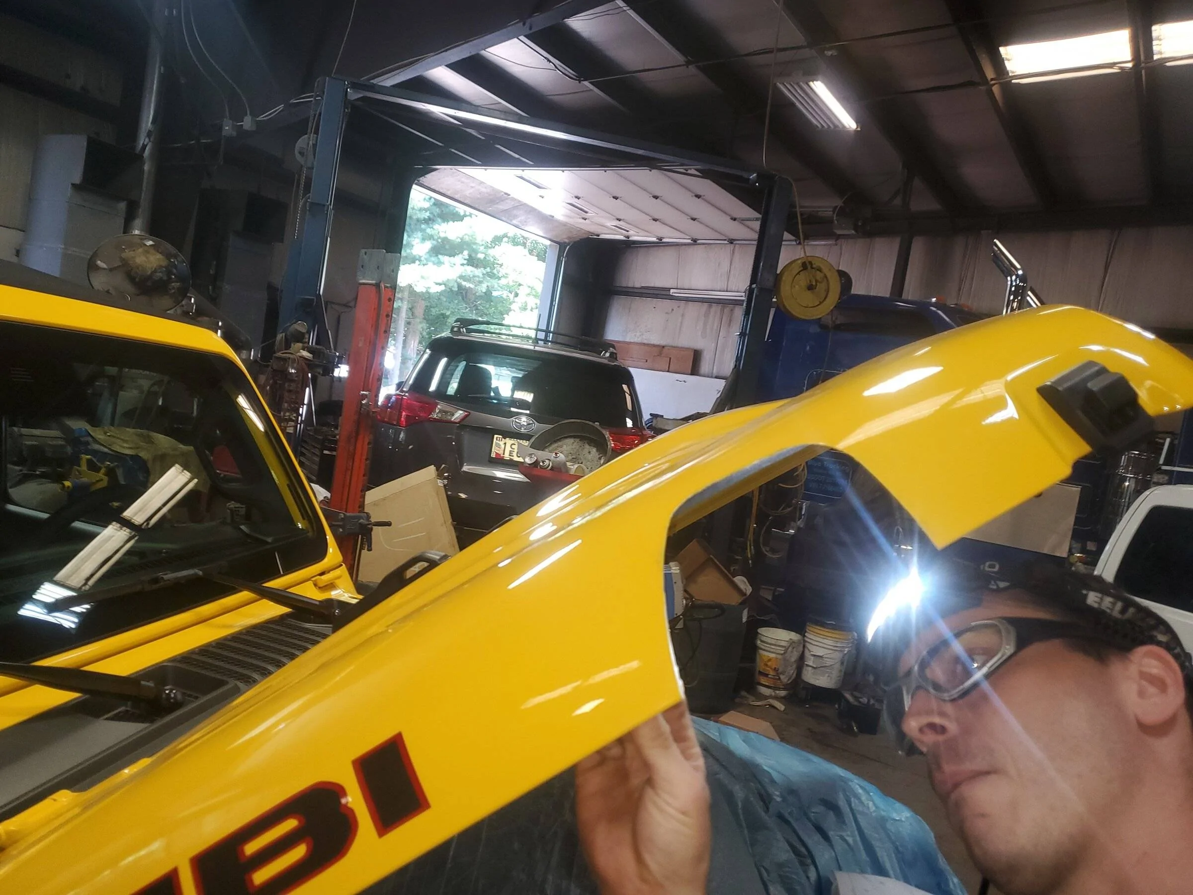

I have the factory CAI. I drove it for a while with the new intake tube without the hood cut out, and then I cut the hood. There is a small noticeable difference. It's not a true CAI if it pulls heat from the engine and not the outside.
would do it again, but that's just me. To each their own

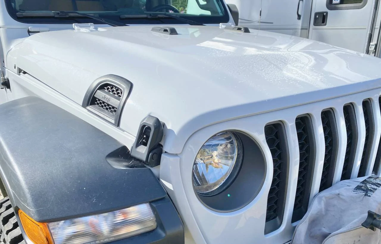

I did the complete CAI a year ago and have no regrets. The fake vents on my JLR bugged me so much I swapped hoods with a Sahara owner. One of my favorite mods plus the $500 cash the Sahara owner gave me bought the CAI.
Does the back of the hood sit up that high all the time?

lol, you cut the hood, but couldn't be bothered to trim the inside of the factory Rubicon vents in order to make them funcitonal?
At highway speed those vents would probably flow inward, and at low speed, outward. LOL.

There is a factor to vent covers called clear area. I didn't do the math but the easily available clear area in the OEM hood vents did not seem to be worth cutting them open and cutting the sound liner. There is a water intrusion issue with vents on top of the hood being cut out. Someone found one one-way fabric with openings smaller than a water molecules to keep the water from entering through the OEM cut out vents. That materials restriction of air movement pretty much closes the clear area the vent openings.
I raised the hood hinges without any modification to OEM parts and the clear area of the opening is nearly as big as removing the OEM vents entirely.
Remember the old Z28 hood scoops that were backward? That worked because the windshield created a high pressure at the hood in front of the windshield. Our Jeeps have such an upright windshield, that at freeway speeds, the high pressure is greater. So jacking the hood hinges up was probably working as an outlet at low speeds and at freeway speeds, it was probably pushing back in. Or maybe just a wash or close to it.
Probably a liability or legal issue, lots of after market products have that sort or label, lights, performance parts, exhaust, oversize tires. Bumpers, anything that changes how the manufacturer engineered the vehicle.
