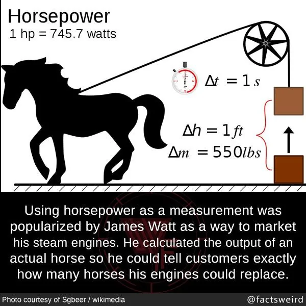

Everyone has a concept of torque and horsepower.
But to break down the engineering terms, torque and horsepower:
  • torque is a STATIC force measurement and
  • horsepower defines quantitative amount of work (actual movement of a mass) in a defined time.
Torque is you leaning on a long wrench on the head of a bolt that is not moving.
Horsepower is moving a certain weight vehicle up a hill of a certain distance in a certain time or moving a certain weight vehicle down a drag strip in a certain time.
As others have pointed out, you can take a given torque engine and multiply its torque by gear reduction. But, while gear reduction may optimize the use of available horsepower, it will never change the horsepower.

In Watt environment?
