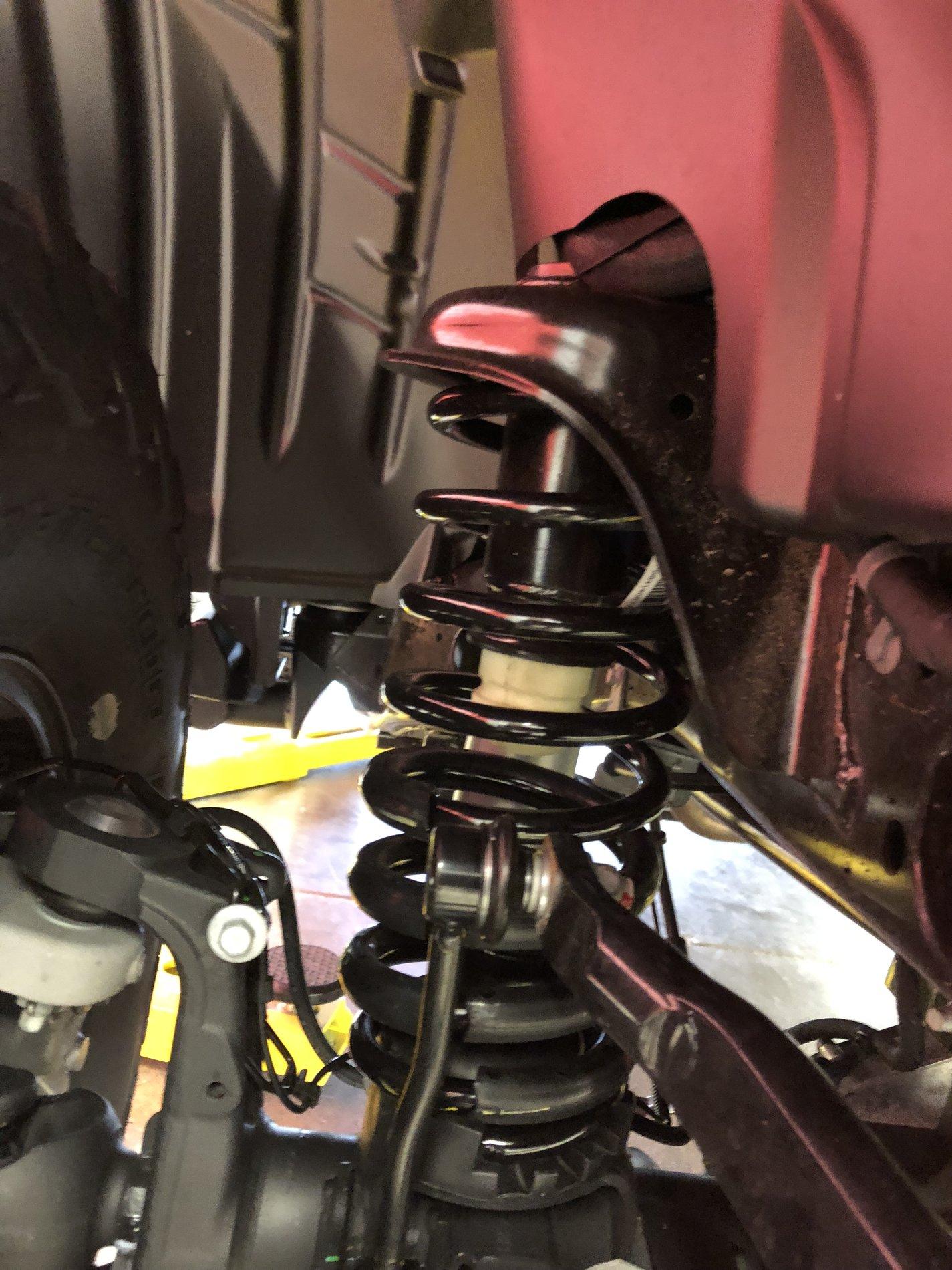

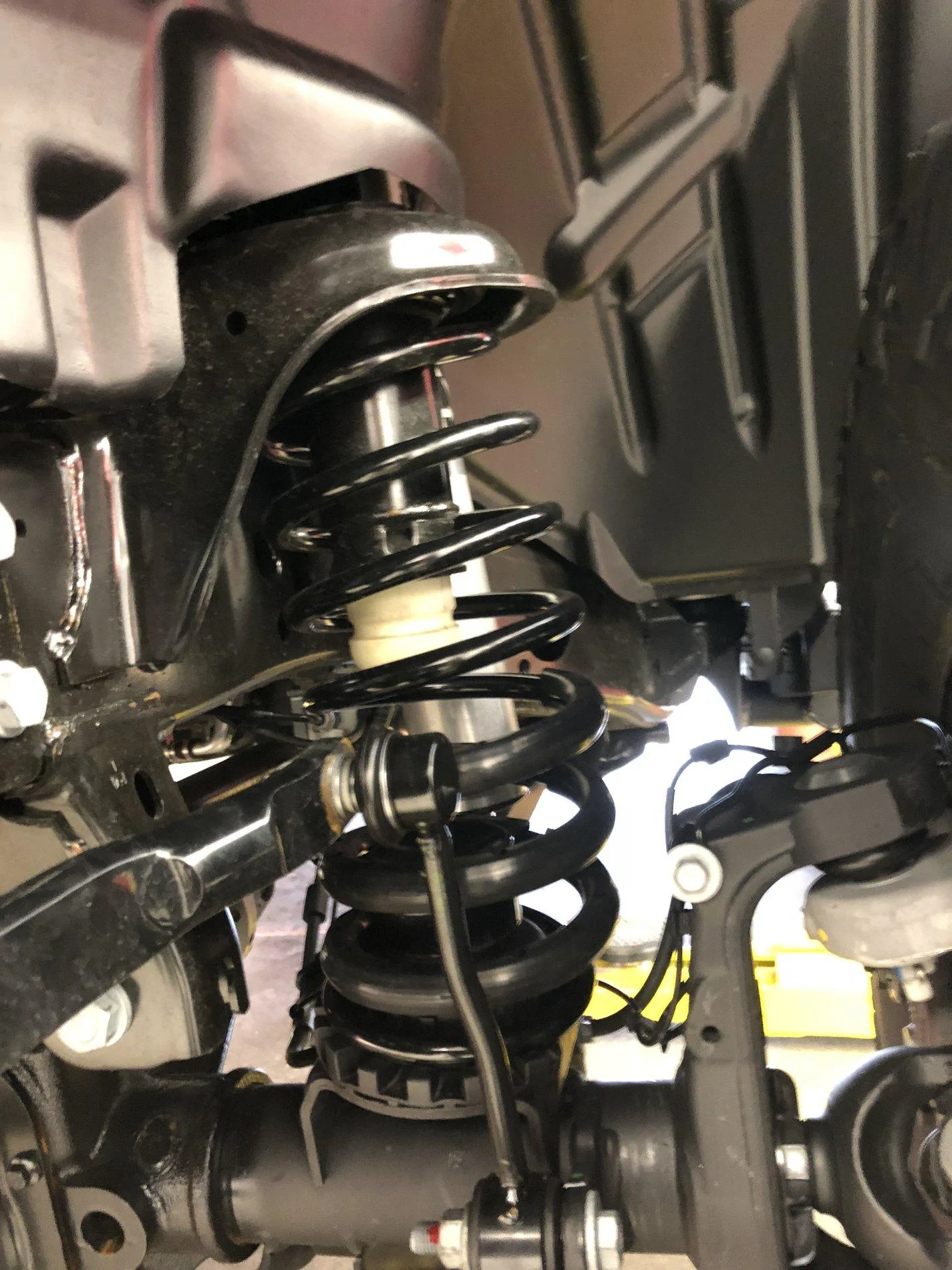

Instakled the 2 inch lift and the Jeep dealer says there is no need to do alignment on the truck is this true??
Doesn’t look like you have the new/modified coil bases - you still have a pretty good bow on the drivers side - nothing you can align except Toe without adjustable control arms/Track bars.

According to the Mopar 2' Inch Lift Installation instructions, the springs will bow outwards when installed correctly, I agree that it does not look correct.

Mopar lift is very incomplete for the amount of lift it provides. Your axles are likely not centered now - that may cause the spring bow, not sure though
You don't get anything from a new alignment as you didn't swap in any adjustable length parts (LCA, track bar) that can correct your caster or toe.
