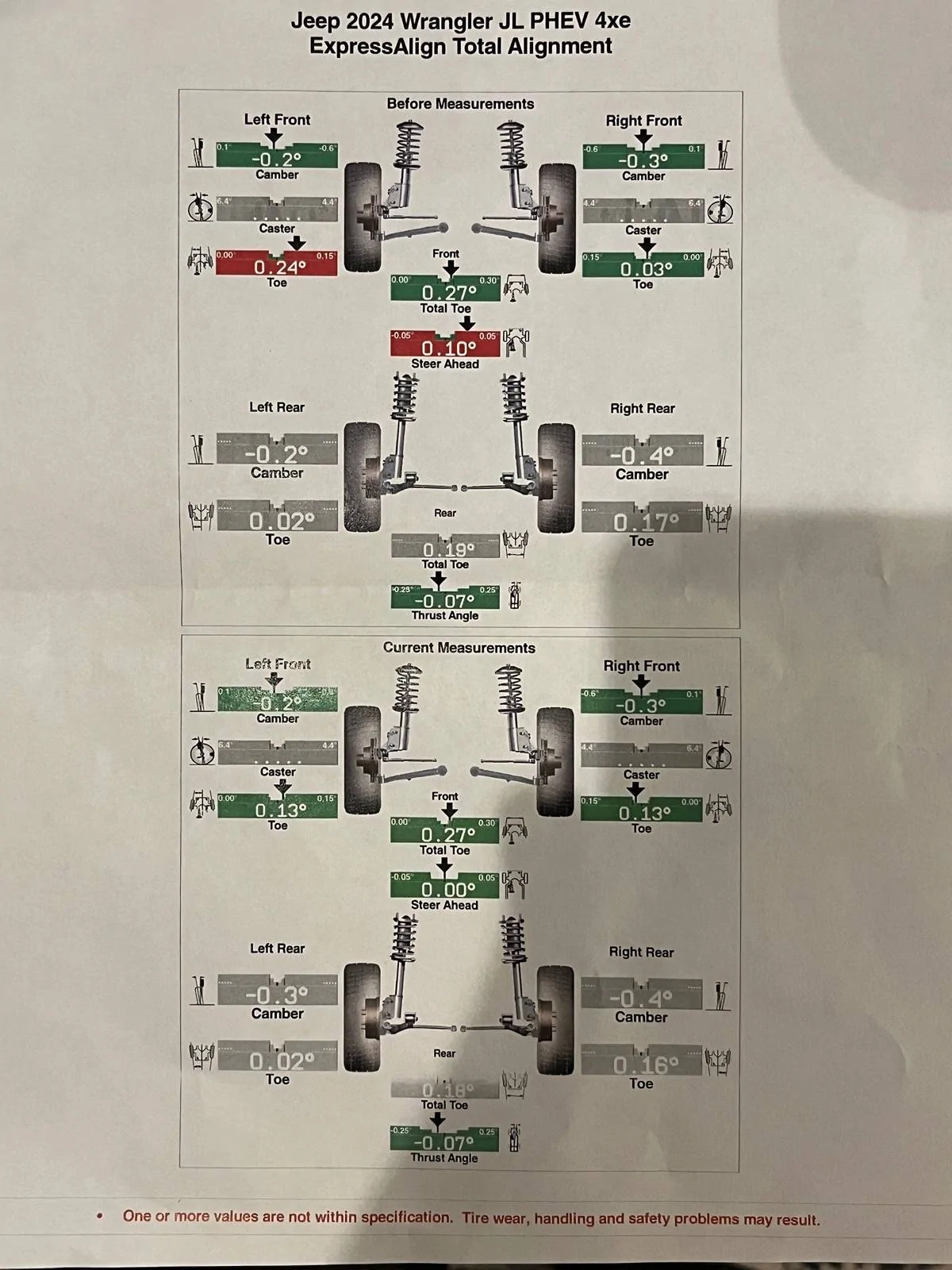

I had alignment done today after I had done the spacer lift. Here is the results. Is there anything I should be changing? I also added Clayton front adjustable track bar and AEV geometry brackets. Appreciate any input.

they left off the most important reading, the caster......

That, and they didn't do anything but adjust the drag link to center the steering wheel. Toe is same before/after.

Alignment shop when they see a jeep come in…….then notice the customer watching……
Jeep Wrangler JL AEV 2 inch spacer lift alignment IMG_9893
Alignment sheet looks good OP, take it back and tell them to give you the caster numbers….

Bring the instructions so they know the orientation of the Geobracket caster adjustment. If it's low, have them bump to the next setting.

I didn't see the caster until you guys mentioned it. I was in a hurry. Duh. I used the Klein angle finder I read from other post. This is my first jeep. Its saying 90.

Nice, that should be 6 degrees IIRC (the 6 degrees is built into the housing). You should be solid if it's driving nice.

remember when you use an angle finder the grade of the garage floor has to be taken into account. as was said I would take it back and ask for the caster number.
