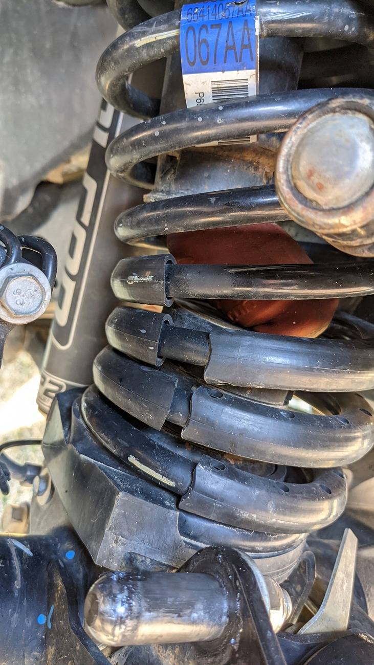

My experience is that those longer and "better" jounce bumpers never perform the way manufacturers advertise. Its not the longer or better materials that do not work. They never get compressed straight when articulating the suspension. They always get compressed and folded side ways. They only get compressed straight when jumping where both side of the axle go up at the same time, which... not too many people jump their jeeps.
That's why I said I would go a different route if I were doing it again.
