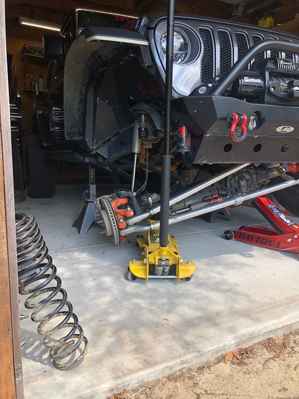

You’re talking about the jounce bumper , or upper bump stop , right ? The rears are easy, can do it with bare hands, but the fronts I had to remove the spring….

Mine are MC, but I didn’t see a way to install them with the coil in place….Im talking about the upper jounce bumper, which is what OPs part number refers to….. I have pucks on the bottom, and yes they’re easily accessible with the spring in place……..

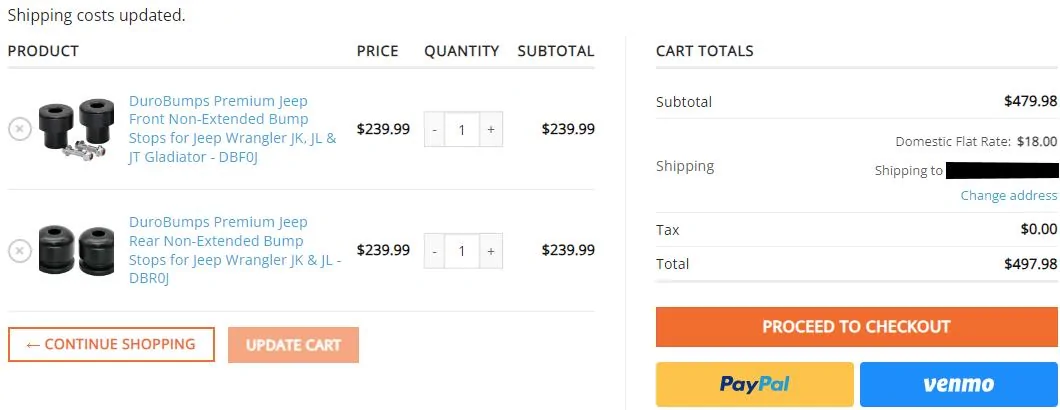

If anybody is discovering this in the future (op has found his solution) Durobumps makes a no-lift version if you just want a better/softer/more progressive bump stop than stock.
https://durobumps.com/product-category/jeep/jl/
Can you help me understand how they justify $500 for a full set of OEM length bump stops? That seems crazy high unless I'm missing something...
