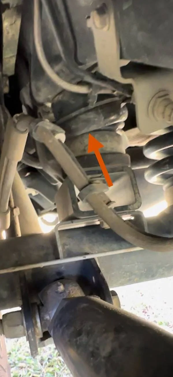

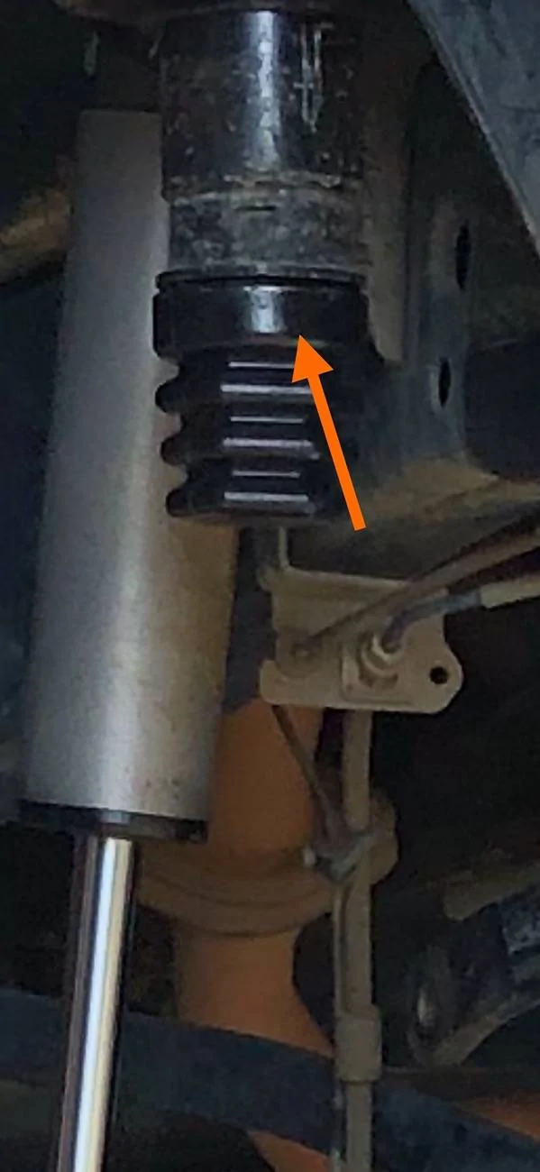

Hey Brad, I was checking shit out on the ramp and snapped a pic of the MC jounce fully compressed….. the fat top part of the bump is a little bigger diameter than the metal jounce tube so that last inch stays put, where the oems stuff all the way to the metal……

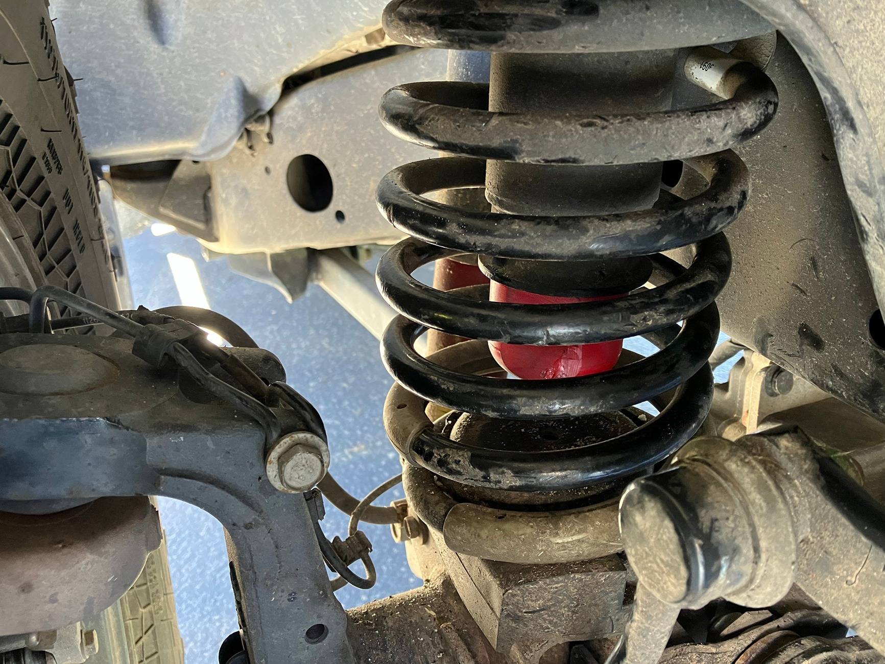

An update on replacing my factory foam bump stops.
First, I replaced the foam stops with stops made from a harder urethane material. They were ~$20 from Amazon. I'm hoping urethane will be more durable than the OEM foam material. Eventually, I plan to install a lift. I will decide then whether to keep urethane bump stops or try something different.
Second, I followed the YouTube video procedure where I only raised the vehicle and didn't remove the spring. The problem I ran into with urethane vs foam is that urethane doesn't compress.
With the vehicle only raised, I couldn't get the new bump stop through the spring coils. I disconnected the sway bar, used spring compressors, but it was a No Go. I used my belt sander and flatten the one side to get the total thickness 1.725" or less. With a slightly thinner bump stop, I could squeeze it through the spring coils. I placed the flat side inward so you can't see it.
It took me a total of two hours, but most of the time was figuring out how to get the urethane bump stop between the coils. The installation of the second bump stop took maybe 20 minutes.
I also learned that urethane gets hot when sanded. It doesn't turn into dust, like sanding wood. It turns into a hot goo. I would let it cool before removing it from the parent piece.
Here's the finished product;
