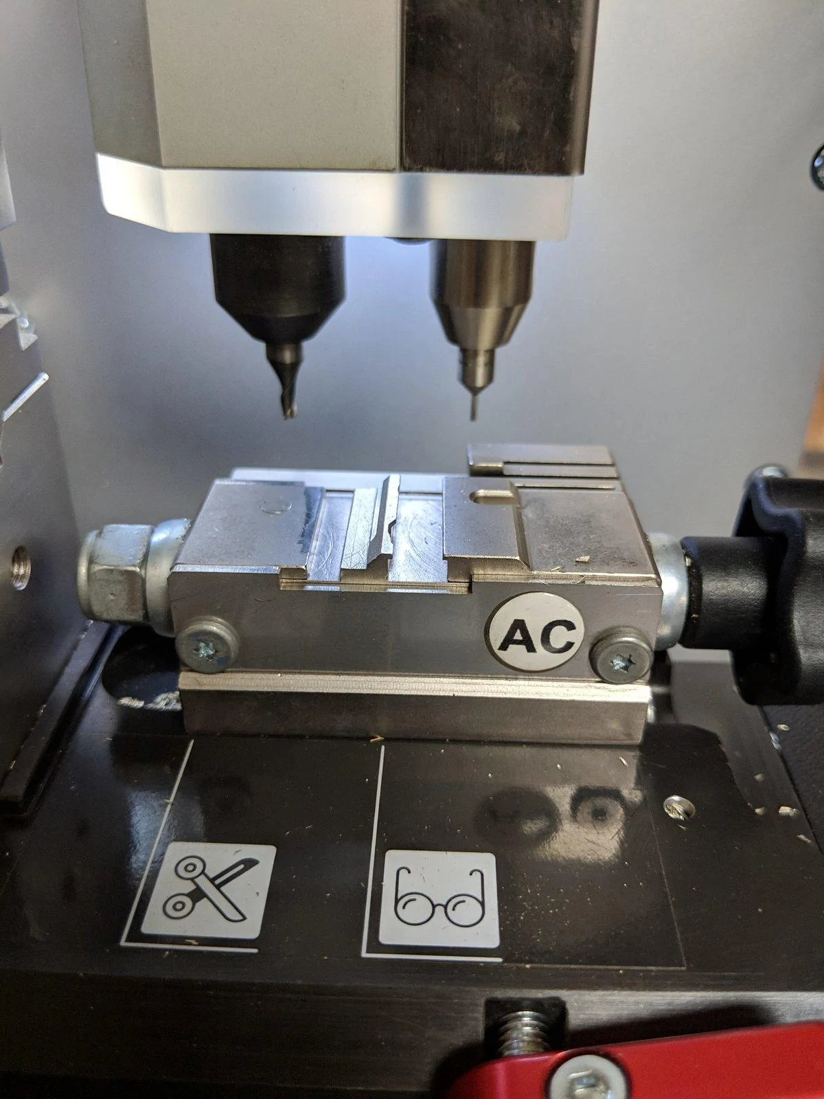

If you dig long enough and deep enough, you can sometimes get an answer that makes sense. The machine is called a Ninja Laser. It uses a probe bit to follow the contour of the original key, simultaneously cutting the contour into the blank. My local shop currently charges $10 to cut your blank.
Jeep Wrangler JL Fobless key IMG_20190121_091205
