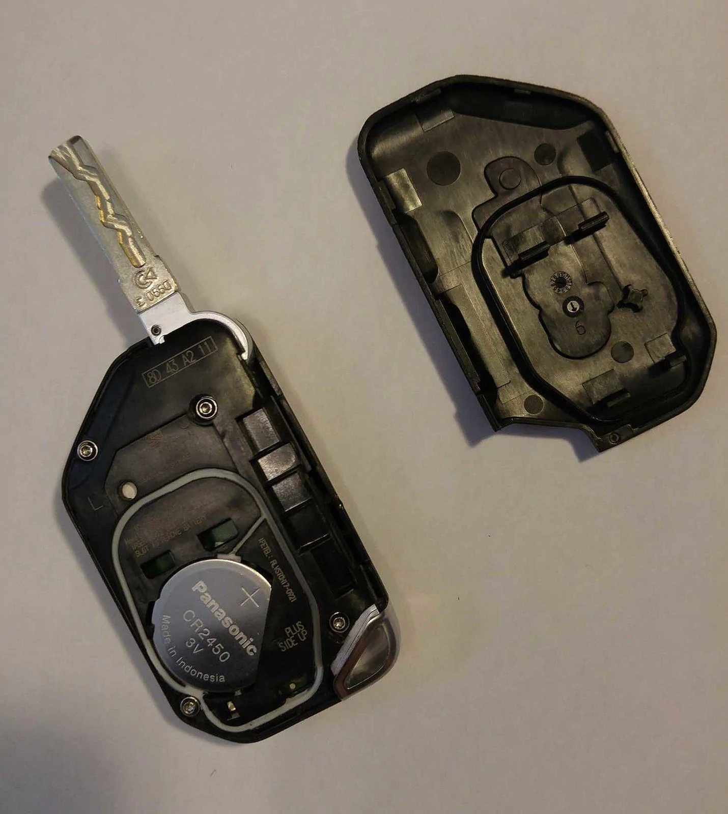

Here's the inside of the fob with the cover removed. You need to remove the four torx (T6) screws.

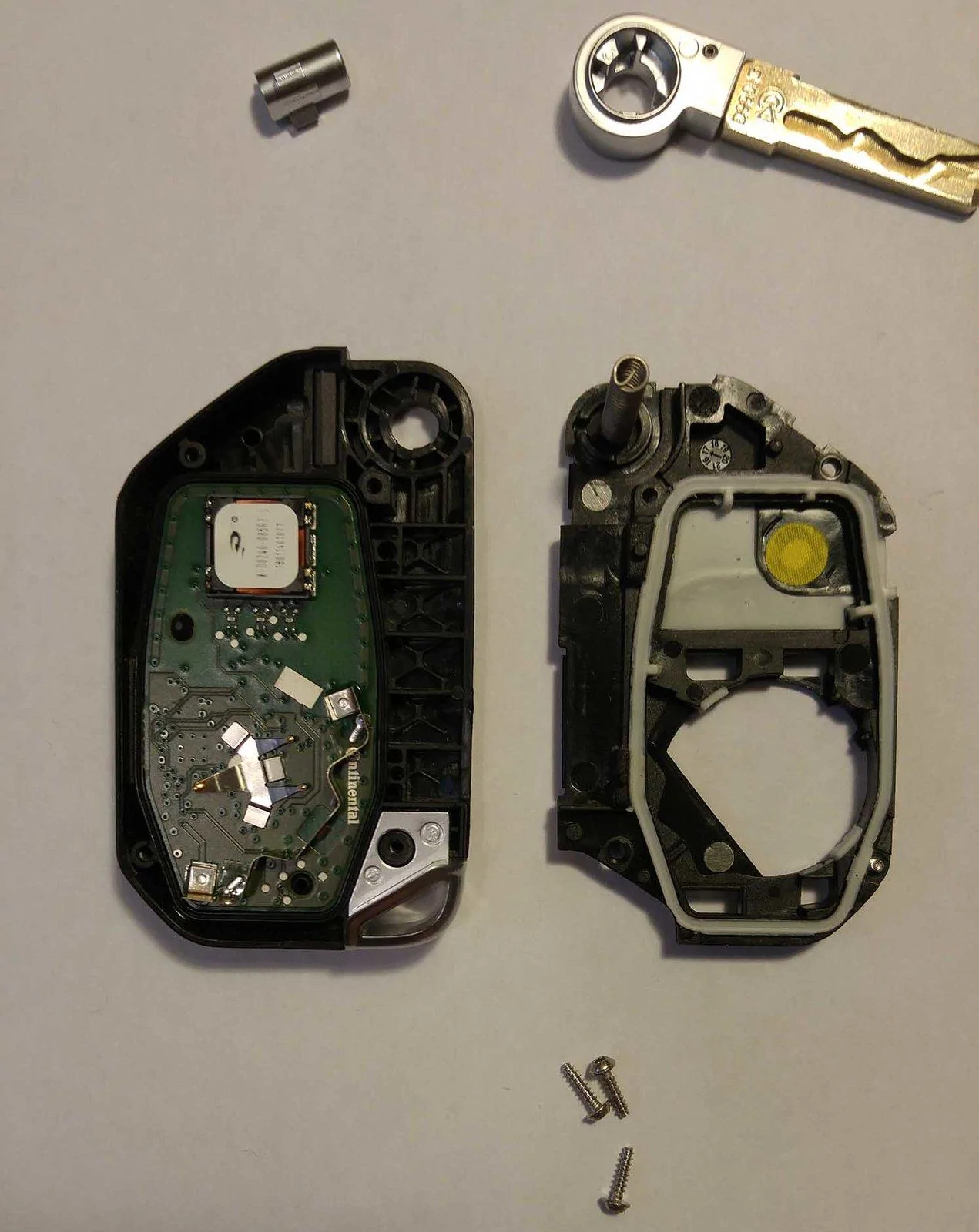

Here's all the pieces of the disassembled fob.
Here's the key and spring in place ready to reassemble.

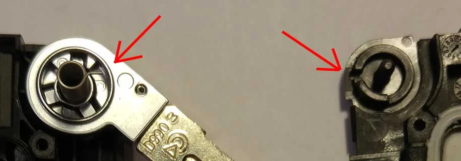

Detail of tab on spring and matching slot on case. The spring tab goes in slot on case. To reassemble with normal spring tension, you would need to rotate cover to wind the spring tighter before screwing the case back together.

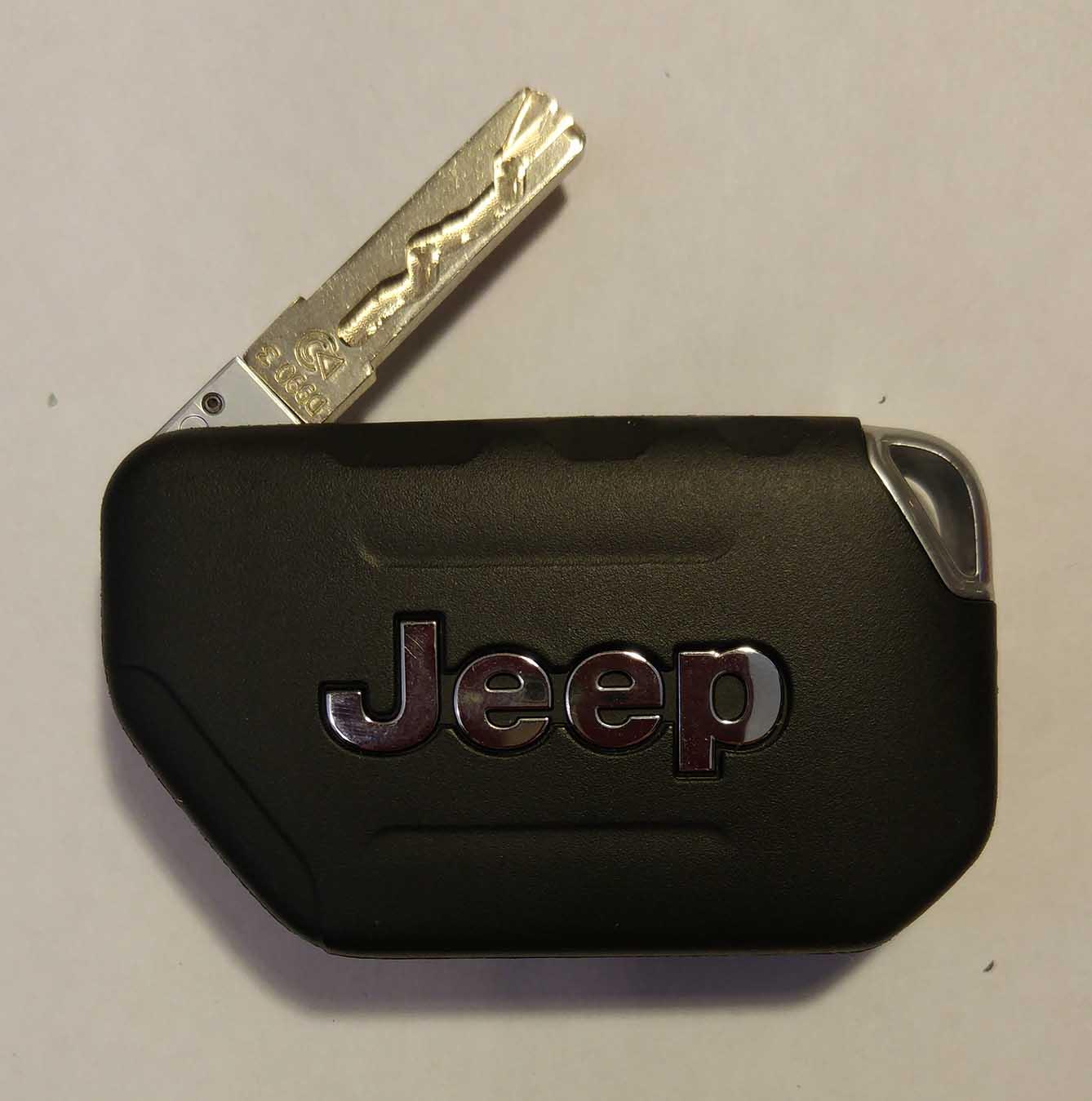

Here's how far the key opens with the detensioned spring. The spring is not strong enough to open the key all the way.

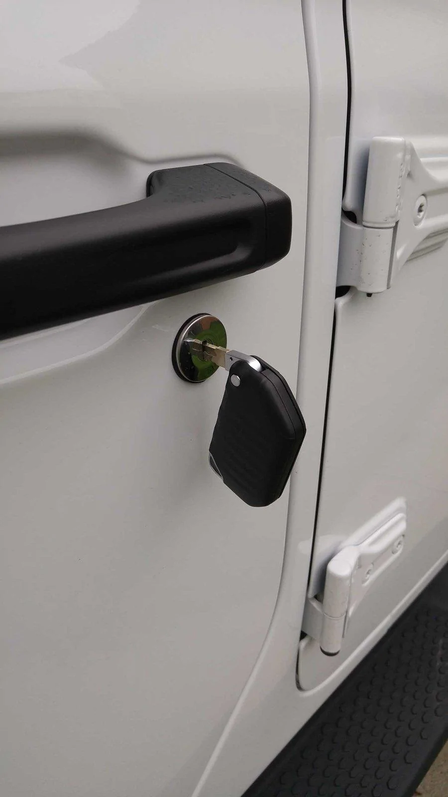

There are additional benefits to this mod for the people with manual locks that actual have to use the key. You can operate the key at an easier to work with 90 degree angle.

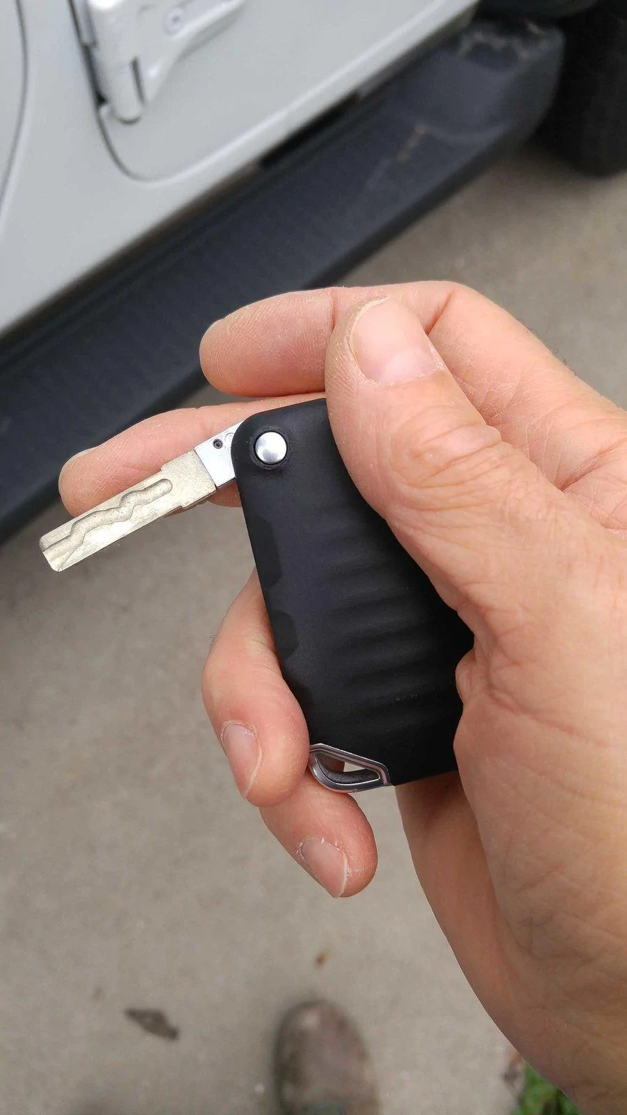

Plus it's easier to close the key with one hand since you don't have to push the button to close it.

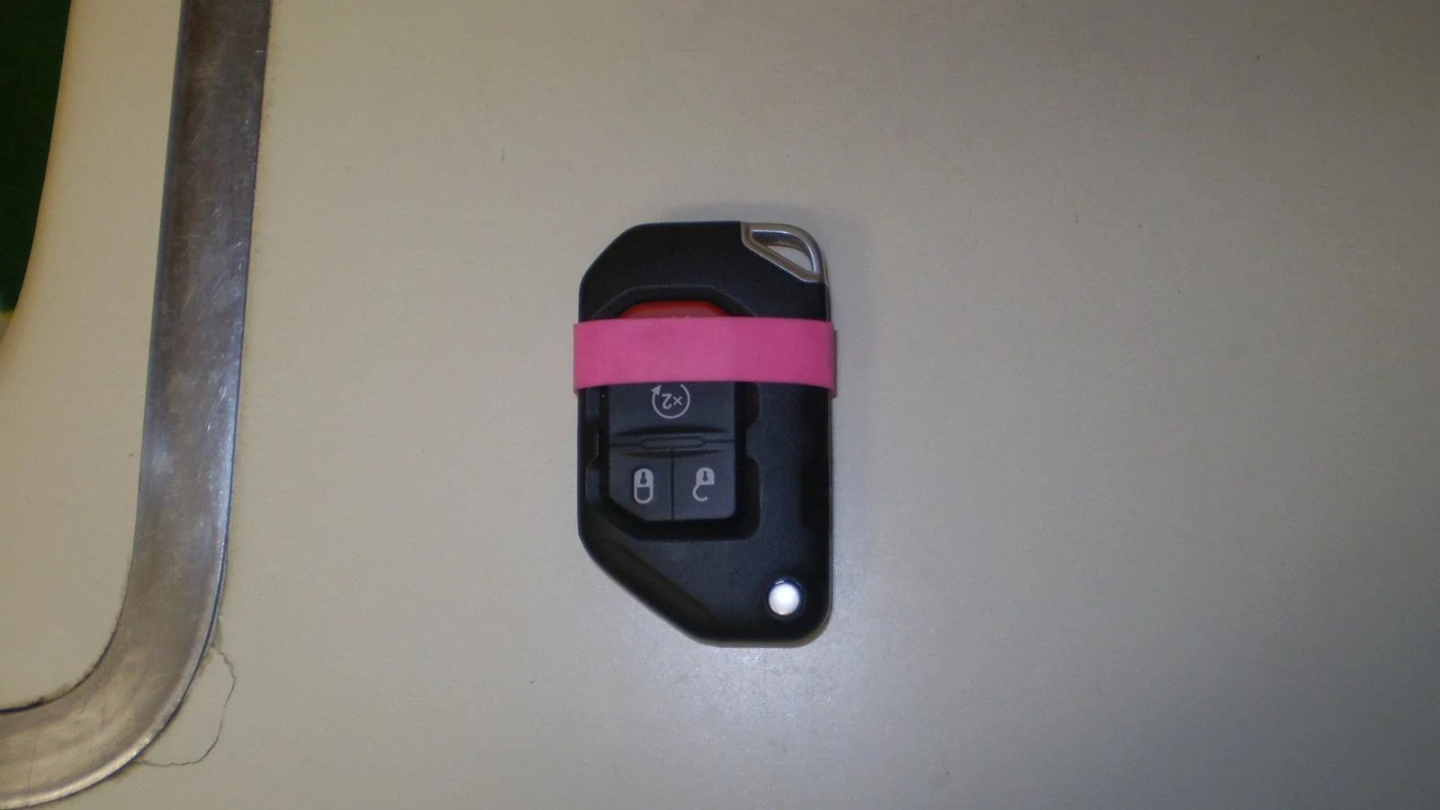

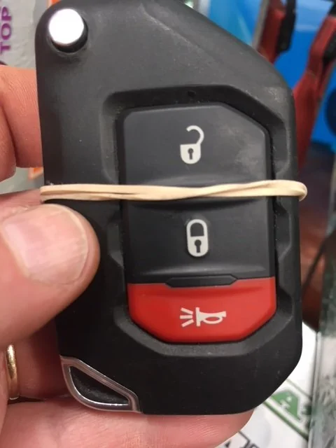

(Satire)
@Jebiruph Jerry, I'm afraid a cease and desist order for patent infringement is going to be necessary on my behalf to shut you down.
You are diluting the value of my brilliant invention!;)
The "key enforcer" TM (proprietary rubber band sold separately.);)
