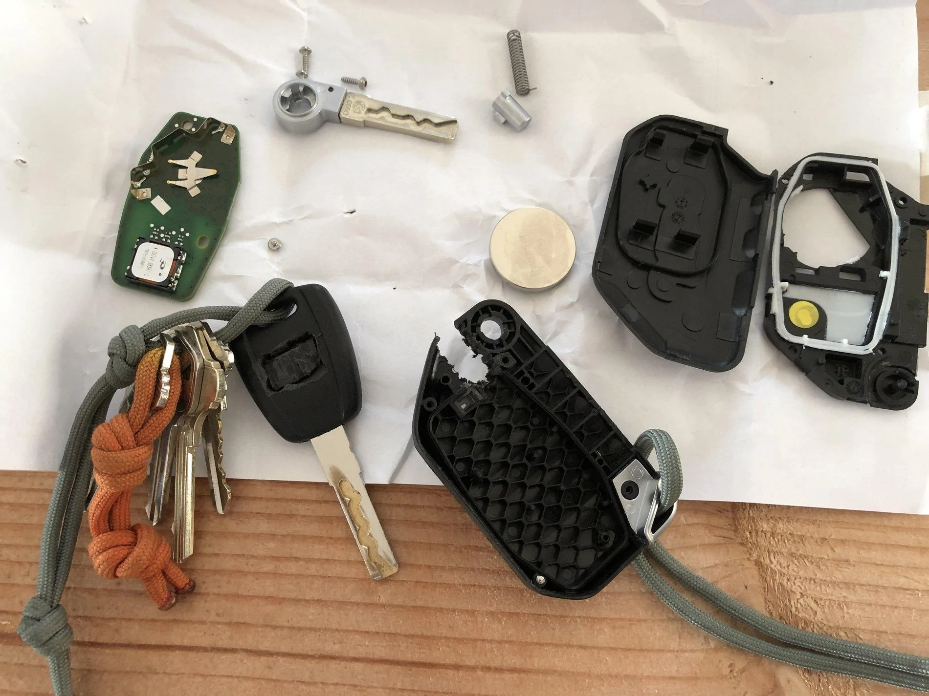

For my Sport model with manual door locks, I had a key made and then cut out the NFC chip (near field communications) and imbedded + glued it into the new key body (and wrapped it in orange duct tape).
I now only have to carry a regular key around like I am used to from my old jeep.

this is to the earlier thread? I FINALLY got my fob open.
what kind of tool (exactly) do I use to open the 4 torx screws?

I found the tool when I went back & looked (it was a t6 torx), but NOT after I went out an bought a t8 torx and it didn't work

I bought a torx set on ebay, but it hasn't come yet :(

For those buying the AJT Design, fob offering......with the fob they ship, they provide a T-6 Torx driver to remove the board from the stock fob and an Allen wrench to use when fastening their fob case together with the hardware they provide.

my torx kit showed up (finally) and I have a key under my hood now...after I have locked my key (and fob) in my car a few times

When I get my Jeep I may machine the button down to flush. If I can. Or just machine a new smaller button.
I thought this was genius when I first read it a few weeks ago and finally had time to try today....it won't easily work 'cause the button isn't solid (I was hoping to just face it down).
Also the amount of engineering put into this fob is impressive but also makes me feel Jeep has no excuses for any design shortcomings in the JL if they had this much time to over-engineer a fob. The button would not be easily replicated as it has three "wings" of varying size and placement.
I'm not saying it's not possible, and if one had a machining center they could crank out shorter versions and sell 'em....but I'm fully manual and it would be WAY more time than I had allotted for this little (well, it was supposed to be little) project today.
I elected to just reassemble with the spring inop and that's fine by me....I've only had my JL a few months but never once used the actual key so I don't think convenient access to it is a priority for me

Oh also is it really a T6? This was what I determined on my own solely because a T7 wouldn't fit but a T6 is VERY sloppy....did Mopar try to use a propietary or oddball fastener here?
I think I had one head start to round upon reassembly -- I didn't try too hard to figure out if it was fully rounded 'cause it was good enough so I left well enough alone
