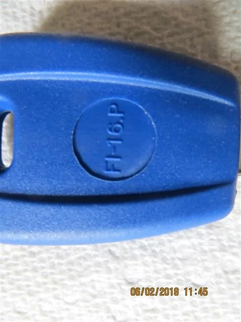

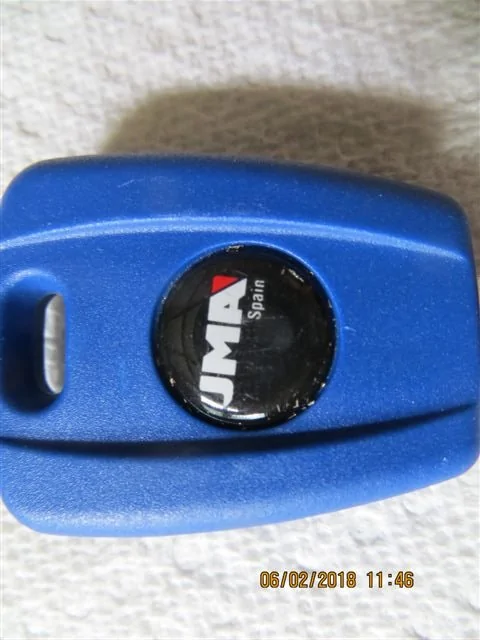

I had another forum member, email me to say he had the blank in the picture below cut to fit his JL.
@larrynjean stated:
http://www.shearerlocksmith.com/
"The above is where I got the blanks and keys laser cut...Laser cutting was $45.00 per key...My total bill for 3 keys, cutting, blanks & return shipping (USPS) was $160.00...You need to talk to their automotive key specialist"
So, IF you are in need of a non-chipped JL key and cannot find anyone locally, you could contact this locksmith, mail him your Fob and have him cut you a non-chipped key and then mail back to you the non-chipped key and your fob. Looks like it would be about $53.00 per cut, un-chipped key.
So, if you just cannot find anyone locally here is a way to go. Just be sure to insure your fob mailing package for say $300 when mailing in case it were to get lost.

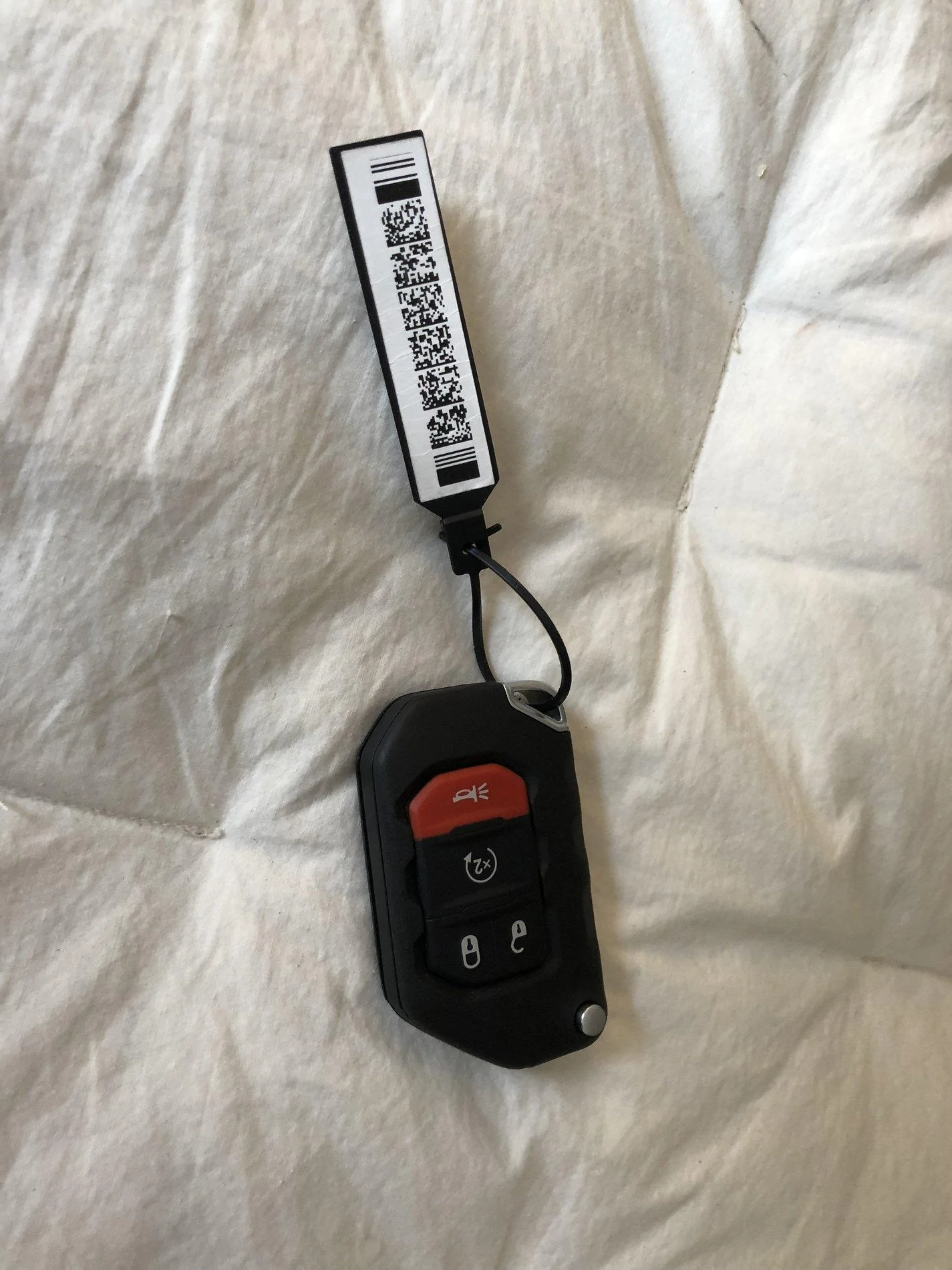

Guys be sure and save the tag you see in the photo. It contains the key code for your Jeep. My locksmith was having trouble matching the key but used the key code to do a perfect job!
My 2 fob's did not have that bar code tag on them when given to me. Undoubtedly, removed by the dealer. 8-(
Dealership parts department told me that FCA cuts keys based on VIN #. Dealership orders fob from FCA and the new fob with cut key is sent to the dealership who takes the fob with cut key and programs it along with the other fob(s) you have.
Unlike with past Wrangler's, dealership cannot cut the key. Dealership told me a tad over $160 for the fob with cut key from FCA.... Then you pay dealer $45+ to program the fob. So, out the door about $205+ to replace a fob.
IF, I ever need a new fob, I will buy a fob on say eBAY, have local locksmith (I found one that can do) cut the key and then have dealership program the fob's. Doing this will save me $50+ I believe.
Note: My locksmith did not need code to cut the blank. His machine just duplicated the key on the fob. Jeep dealership and a few other locksmiths said this was not possible but it was. 8-)
