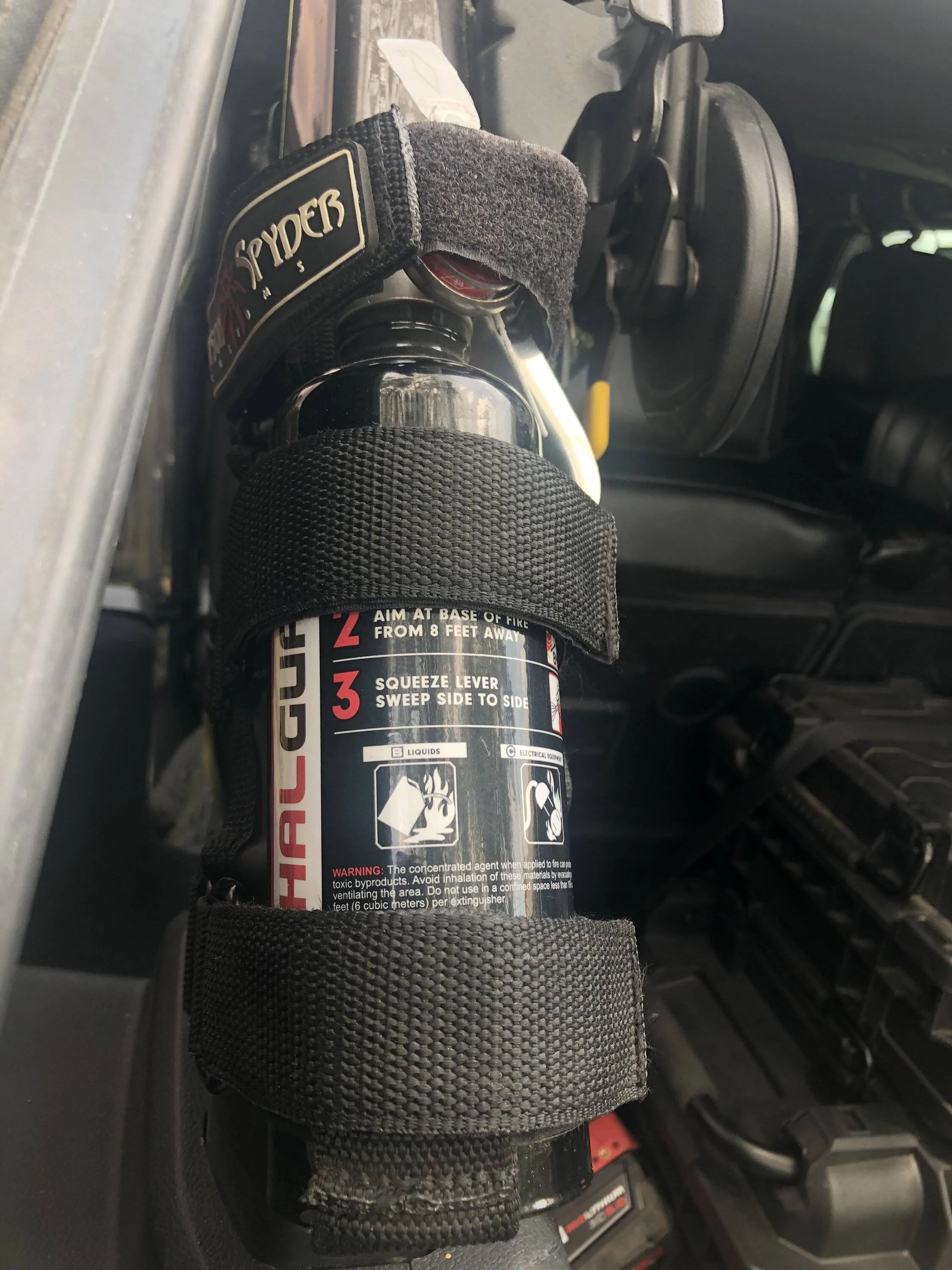

Went with an element under my seat. Small, kinda compact. Hope to never find out how well it does or doesn't work.
Out of curiosity, for those that keep them on board all the time, is there a concern that heat built up inside the cabin on a hot summer day with the windows closed might trigger one of these to blow and douse the interior?

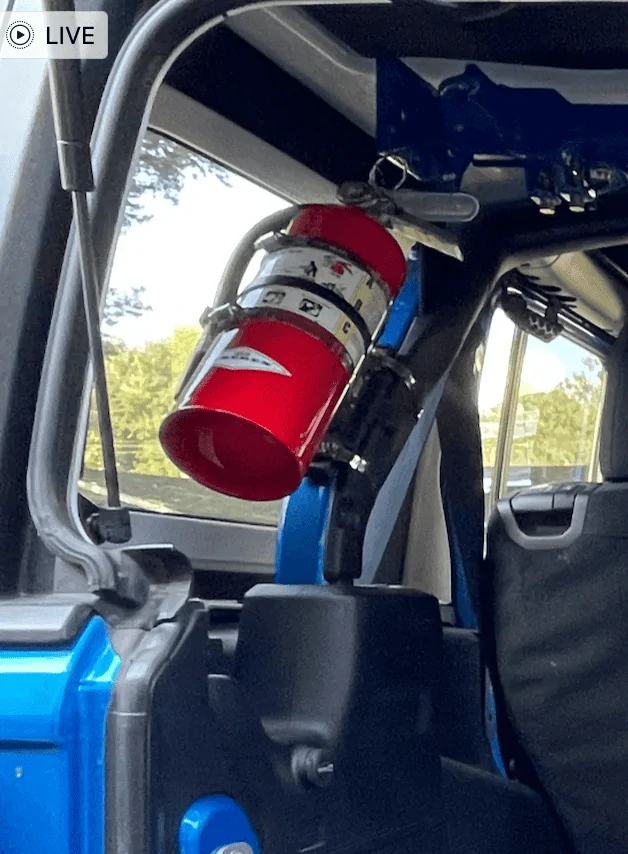

I like the Rugged Ridge mount. It holds a 5lb extinguisher to the rollbar conveniently inside the tailgate.

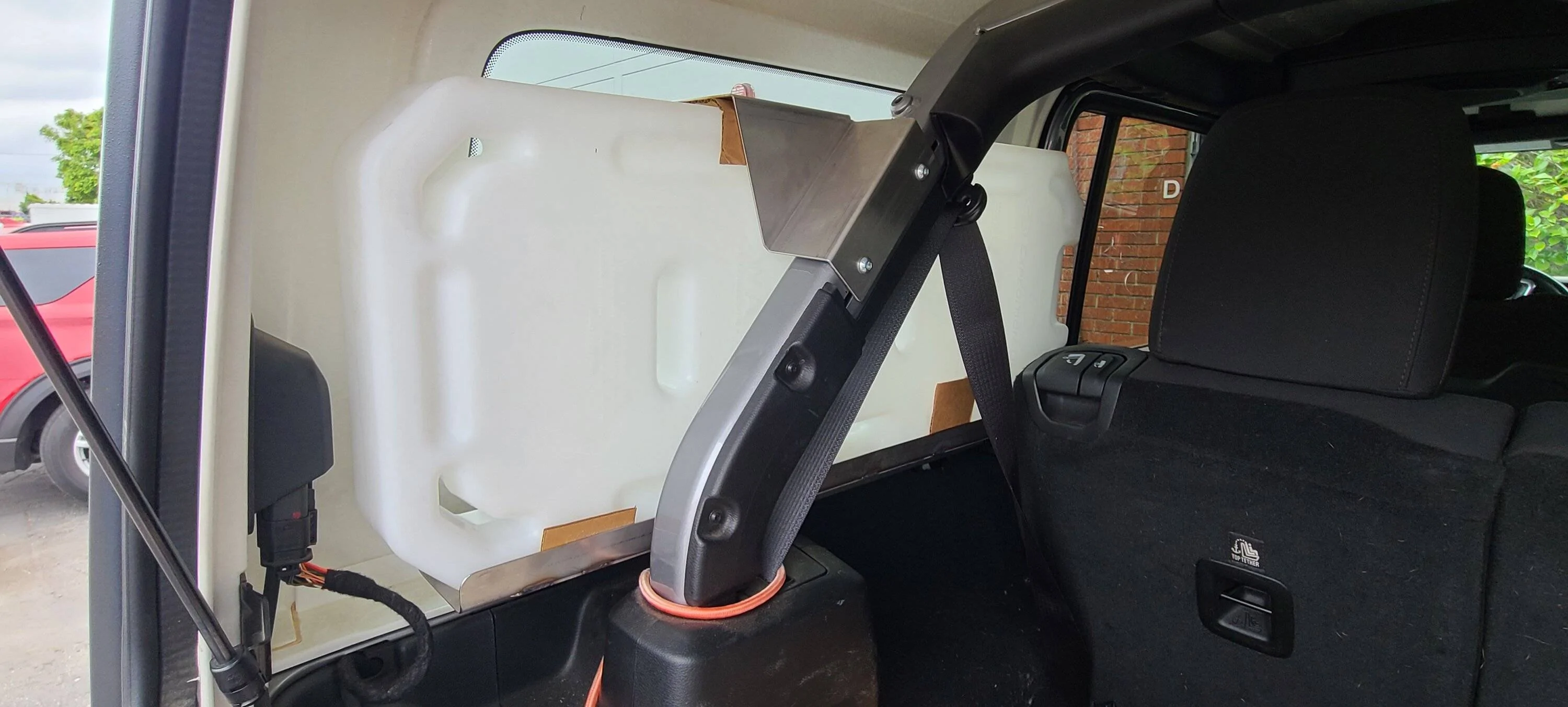

That spot is currently occupied by my water tank bracket.
