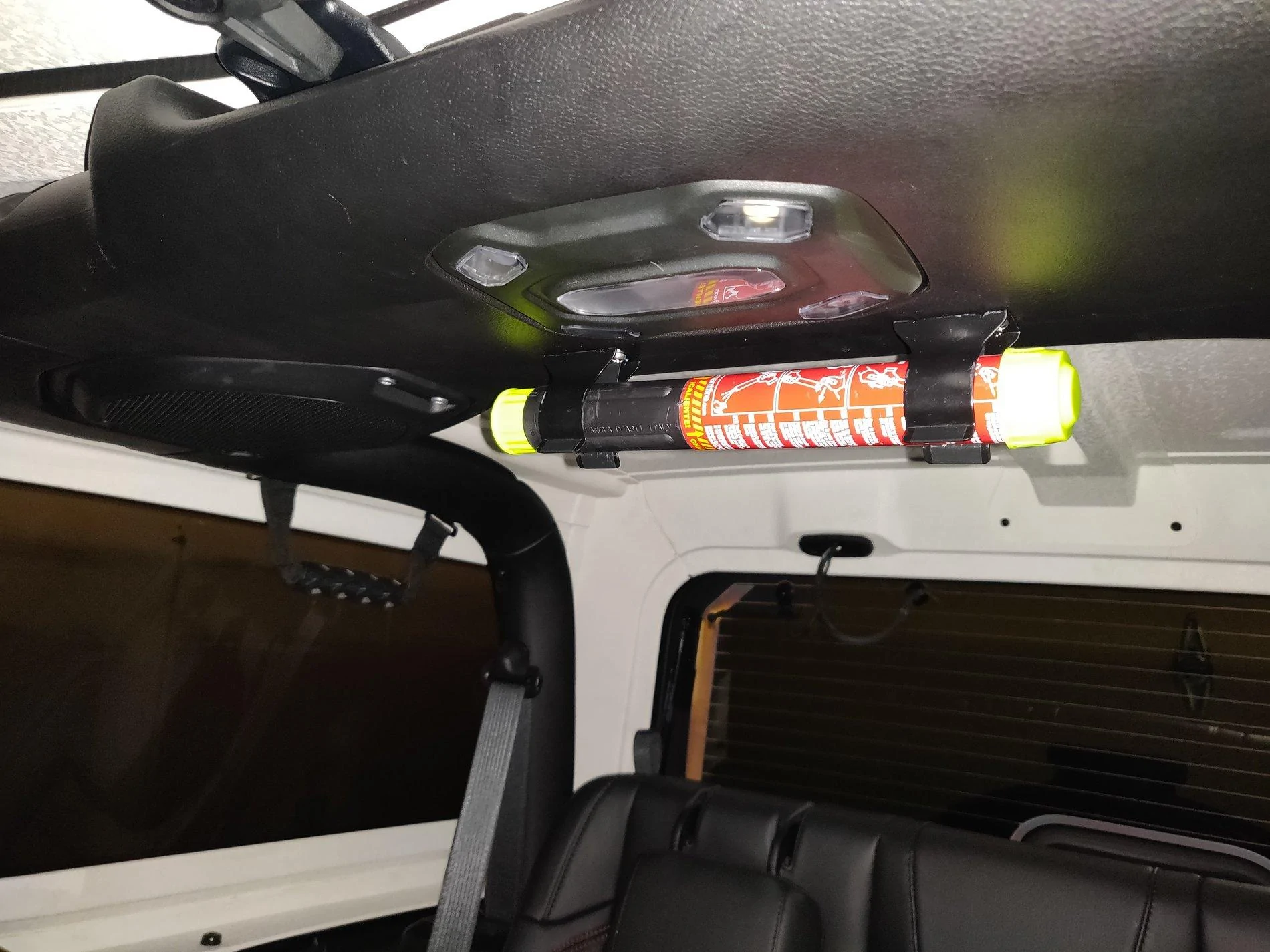

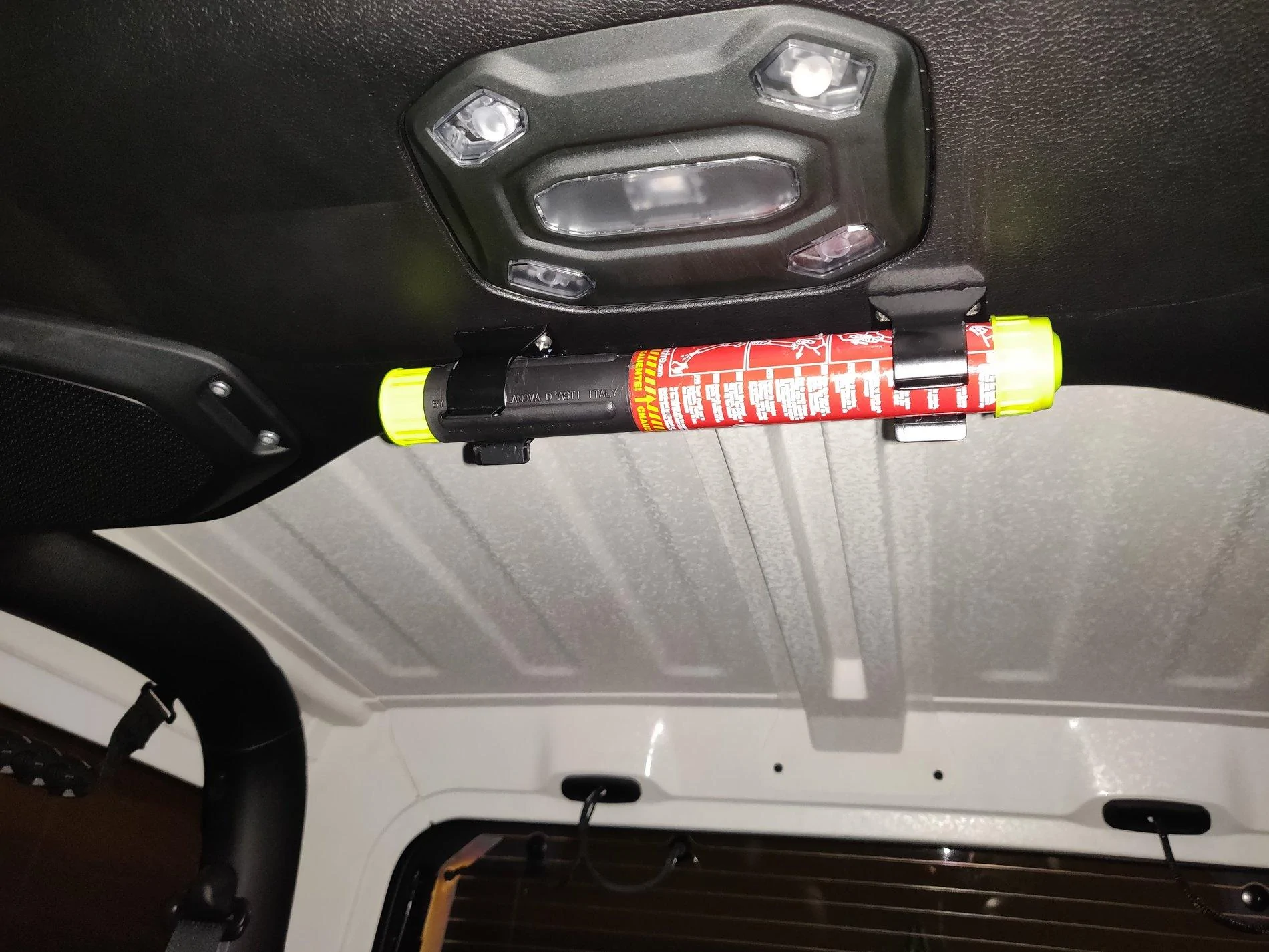

I posted this in another thread as well, but I figured I might as well post it here too.
I finally got my Element 50 fire extinguisher mounted this afternoon. I had to wait for the Rugged Ridge Flashlight holder clips (#11238.06) to arrive from Amazon.
The Element 50 came with one plastic mounting clip, but I wanted to use two metal clips just to make sure it doesn't come loose.
The Rugged Ridge clips were a little big for the Element 50 as they're meant to hold a 1.5" diameter D Cell Maglite, but a few whacks with a rubber mallet made them the perfect size
