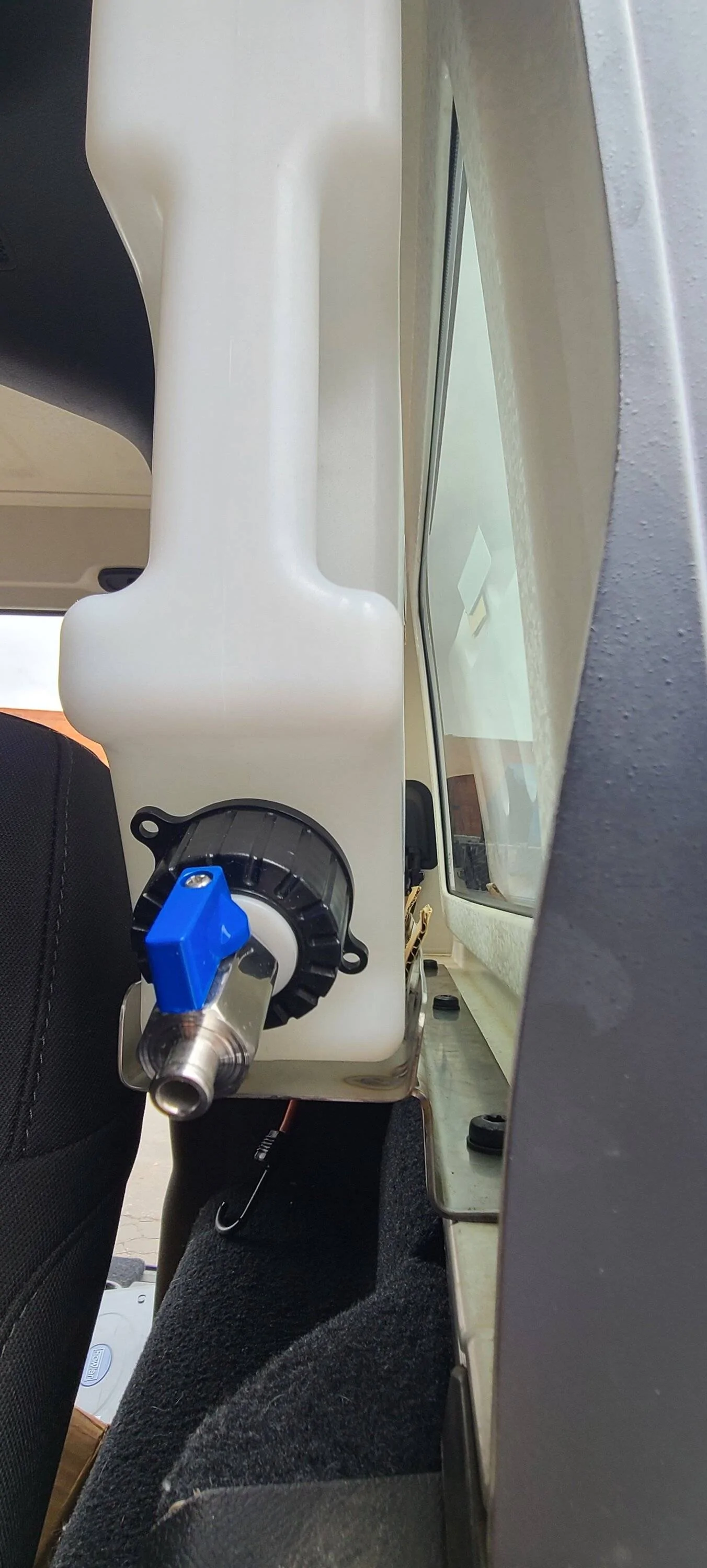

@roaniecowpony sorry to side track the topic, I really like your water tank bracket. Is this something you bought or fabricated yourself?
I fabricated it, or should I say; I designed it and a friend's employee fabricated it as I walked him through what I wanted.

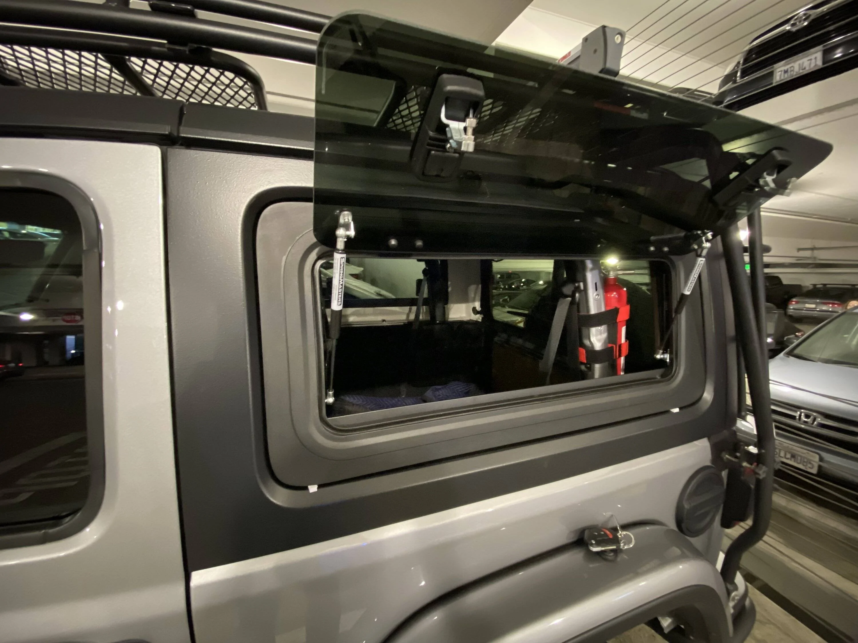

I'm the IC for the hospital where I work. We've done countless drills on fire prevention, containment and extinguishing. That said, getting the largest ABC extinguisher you can manage can "buy you time," but depending on the size , location and type of fire, might not extinguish it.
I went with a conventional 5lb extinguisher that I have checked every 6 months with our facility extinguishers and have it rotated every year with new or recharged ones.
I've had to use for camping incidents that got out of hand and thankfully, not for any roadside engine fires. The only time I would use an extinguisher for an engine fire is when life was in immediate danger. We're trained that the FD is best at handling fires and I leave it to them when I can.
I use a Bartact Velcro soft mount.

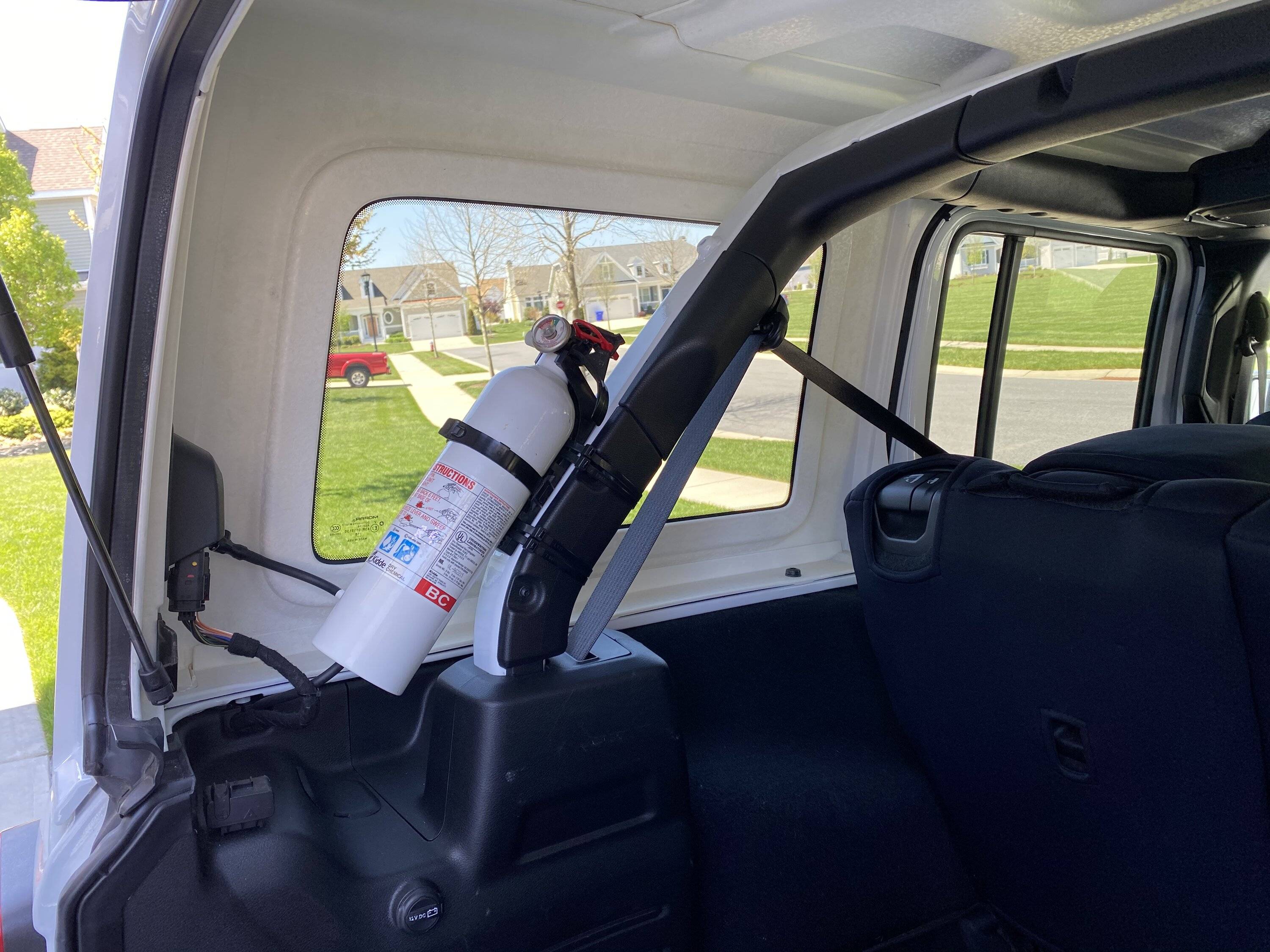

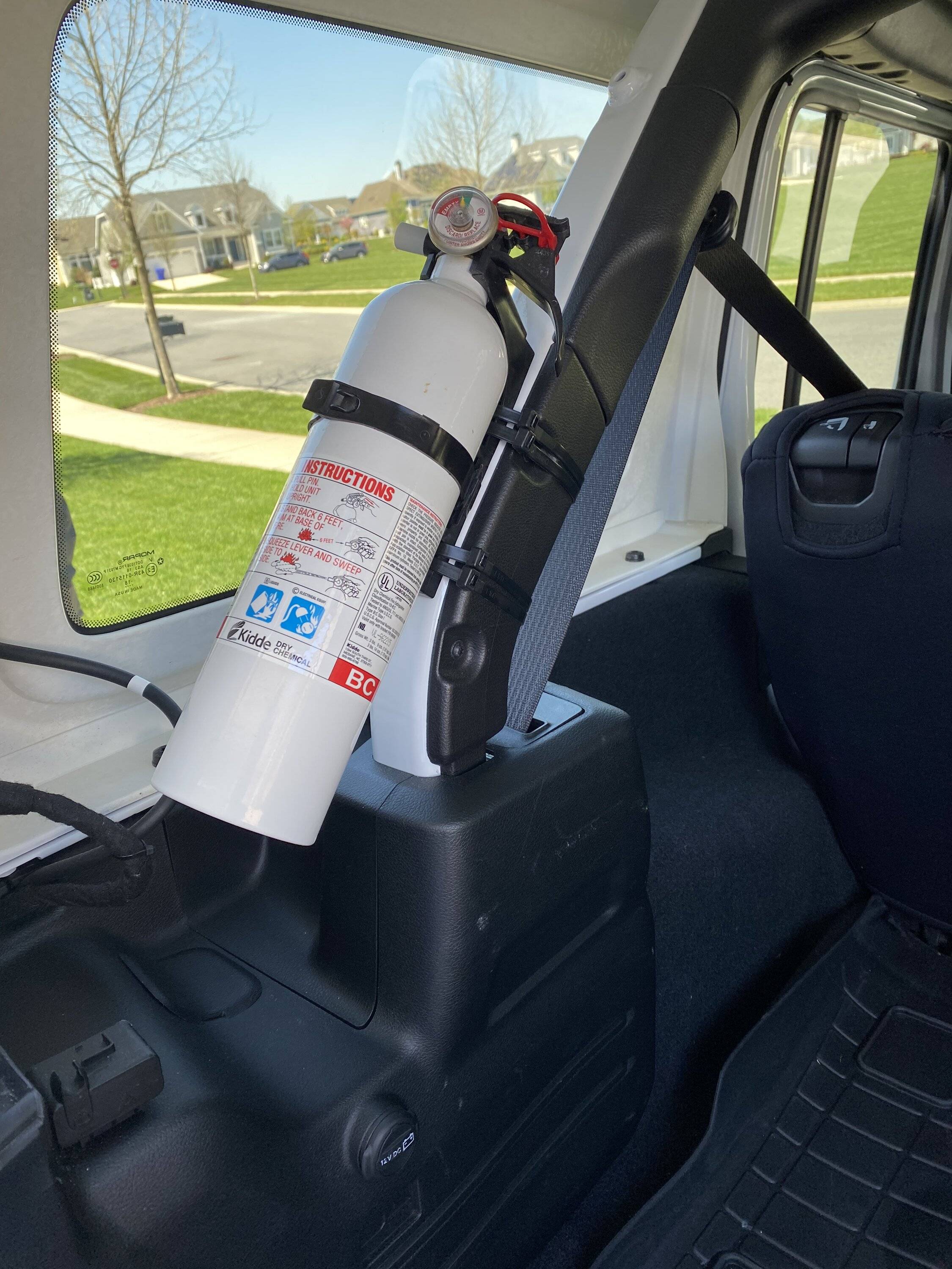

I'm considering a fire extinguisher before going on the Rubicon. I looked at them and thought that a Co2 would be the way to go. Looking for comments about which kind and size to get, and why you'd pick one type over another.
CO2 extinguishers are not effective outdoors. To displace the oxygen in a fire situation, they are really only effective in enclosed spaces.
I have a marine style BC dry chemical extinguisher attached to my roll bar with multiple heavy duty zip-ties. Its been there for several years and never moved.
