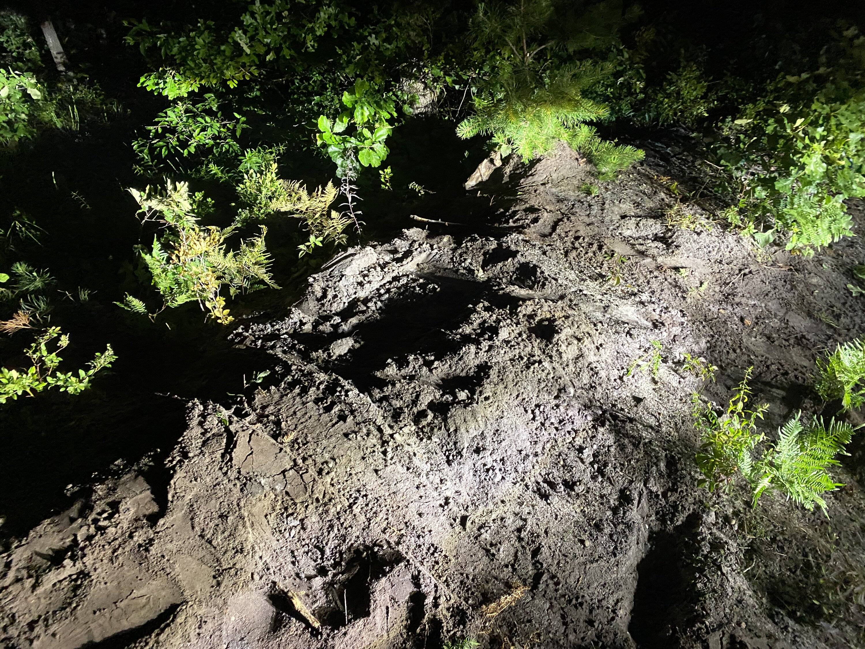

From what I can gather from the pics, you were turtled to the frame and had low traction at front and rear ends due to sandy/silty soil.
Of course additional frame clearance from lift/tires is one solution, real cause in this configuration is likely severe lack of traction. If that was because you were droop limited (the springs were no longer pushing down on your axles because the shocks limited extension) a possible solution is simply adding shock extended length. With no "weight" on the tires, its likely different tread itself wouldn't be the answer.
In the environment you were wheeling in, looks like the young trees and loose soil would have made it difficult even if you had a winch or used the come-a-long, you have to have a point to anchor the other end to. Some options there are sand anchors or even burying a tire. With no natural ways to shore up a tire, this is one instance where traction board could have come in handy. Another option would be to lift one end enough to get sufficient weight on the other axle to gain traction. Dangerous in my opinion, but something like a high lift could work there. Digging out the hang up would be an option, but obviously if your hung all the way across the frame and trans/tcase even a could hours of shoveling would probably not have been enough.
