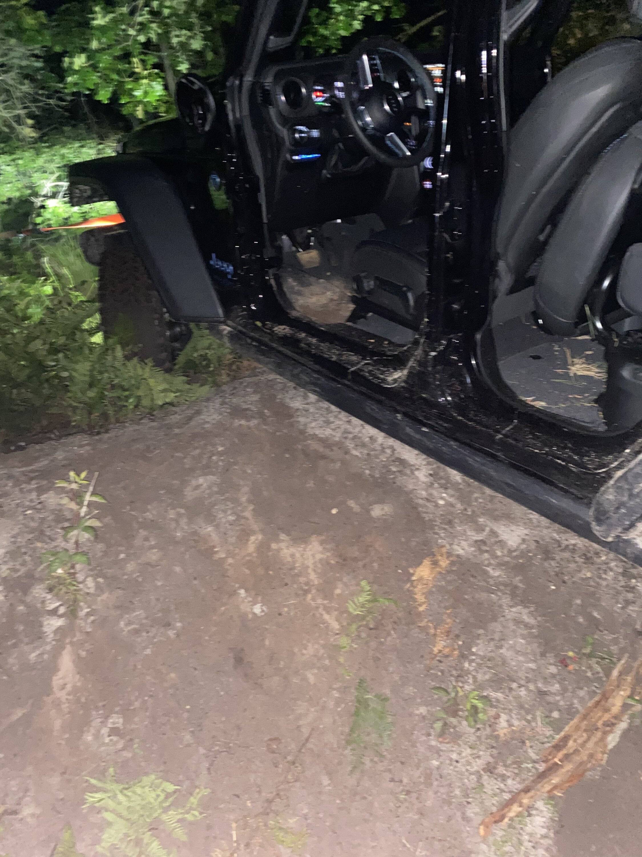

nothing to put under the tires except dead branches. No anchors to pull the thing sideways. No shovel. No answer from local FB group with a few thousand members.
jacked up each tire twice
Called an uber. 45 mins ride home, get the truck, 45min ride back.
Dented front bumper, interior is totally caked in dirt, car has 300 miles on it
was having so much fun and was just exited and going home

Without seeing a wider angle of the whole situation it's kind of hard to tell what's going on besides being high centered. Give us pics from all angles if it's possible. I'm with the people saying wedge the spare tire somewhere. If you can get it under a tire and your lockers are engaged (assuming you got them engaged? I didn't see an update on that), it doesn't look so high centered that climbing the spare tire wouldn't be able to walk you out of it.

Are you high centered? Or cross-axled?

It looks high centered but it’s hard to tell from the picture. OP keep us posted please.

Are there some rocks or something there thay you can put in front of one or both of the rear tires so that you can get the back end to climb?
If not, maybe you can lay your spare in front of one of them. Once the rear climbs, the clearance under the frame should allow the Jeep to move forward and off that ledge.
If it wont climb the spare, let some air out of it.
