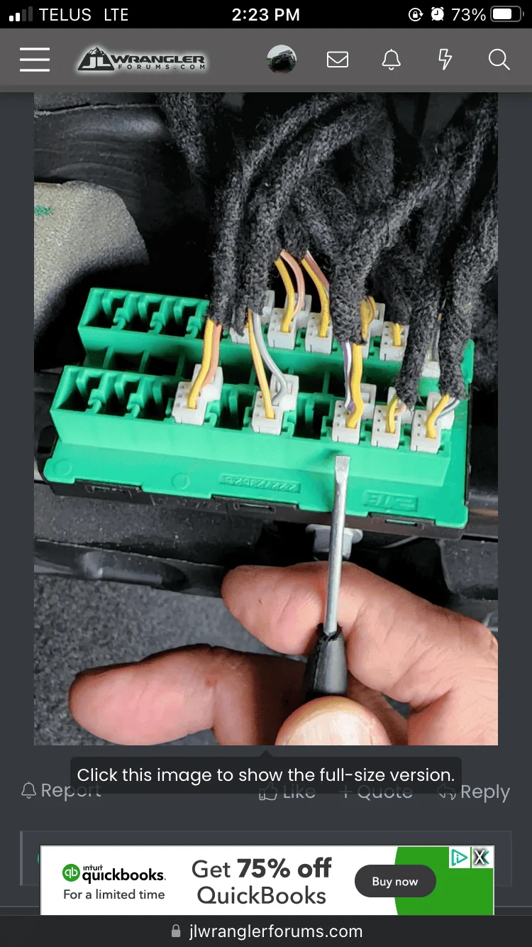

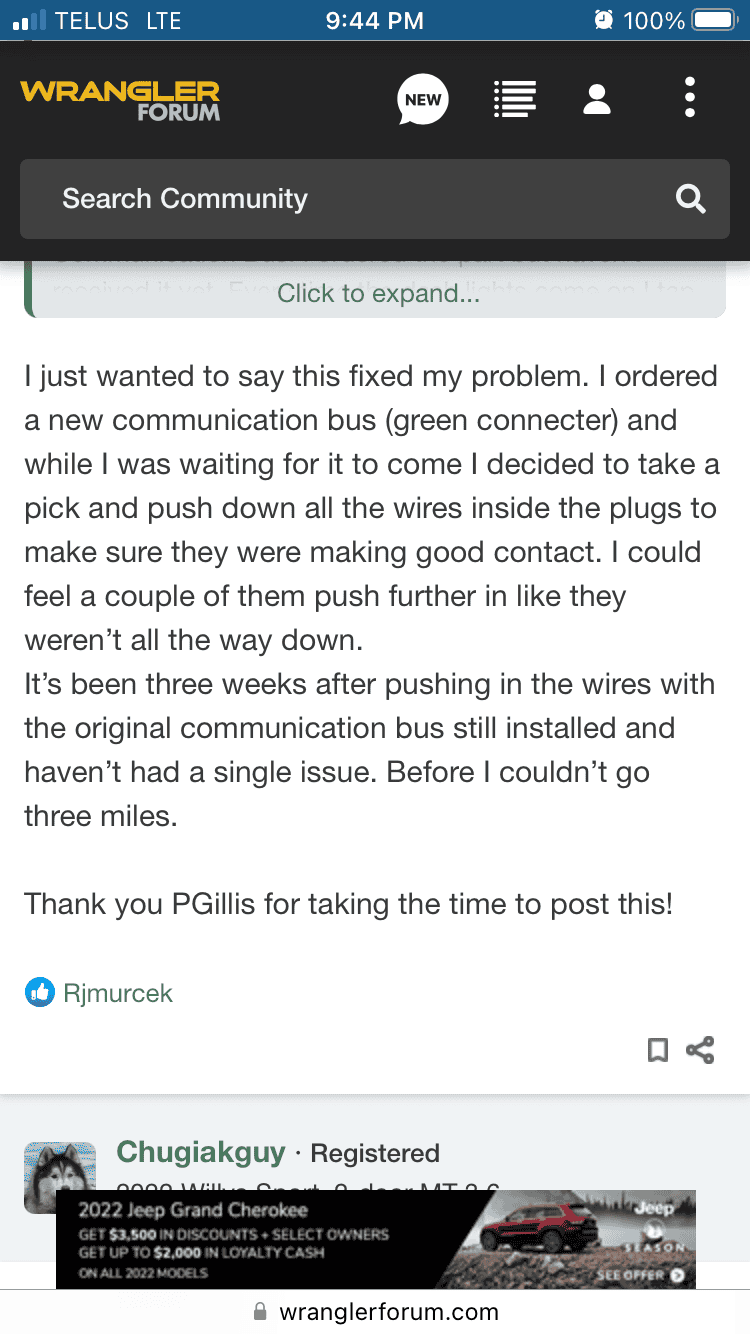

I believe the OP said he cleaned the connections on his CAN BUS found in the glove compartment and added contact grease. He had no issues for a week. I believe his response is on page 2...

The warnings can be replicated by unplugging the connectors from the green bus one at a time, it did for me.
Also tapping the green bus makes the cycling error codes go away.

Purchased a 2018 JLU Sport S a few months back, shortly after the purchase I started having the same issues everyone in the thread is describing. Curious if anyone ever found a solution to the problem? I've read all the proposed fixes, but I've yet to read any thread where someone has actually found and fixed the problem. Any updates from those who have found a cure?

Hey Larry, I feel your pain, no permanent fix. I leave the glove box off an when it acts up I tap the green bus, the alarms stop, I turn off the ignition, open the door to shutdown the system and restart.
I think replacing the bus is the fix but last I checked I had to buy the entire wire harness which I thought was 1500 usd but not sure.
I’m hoping someone will develop an after market part or eventually find one used.
