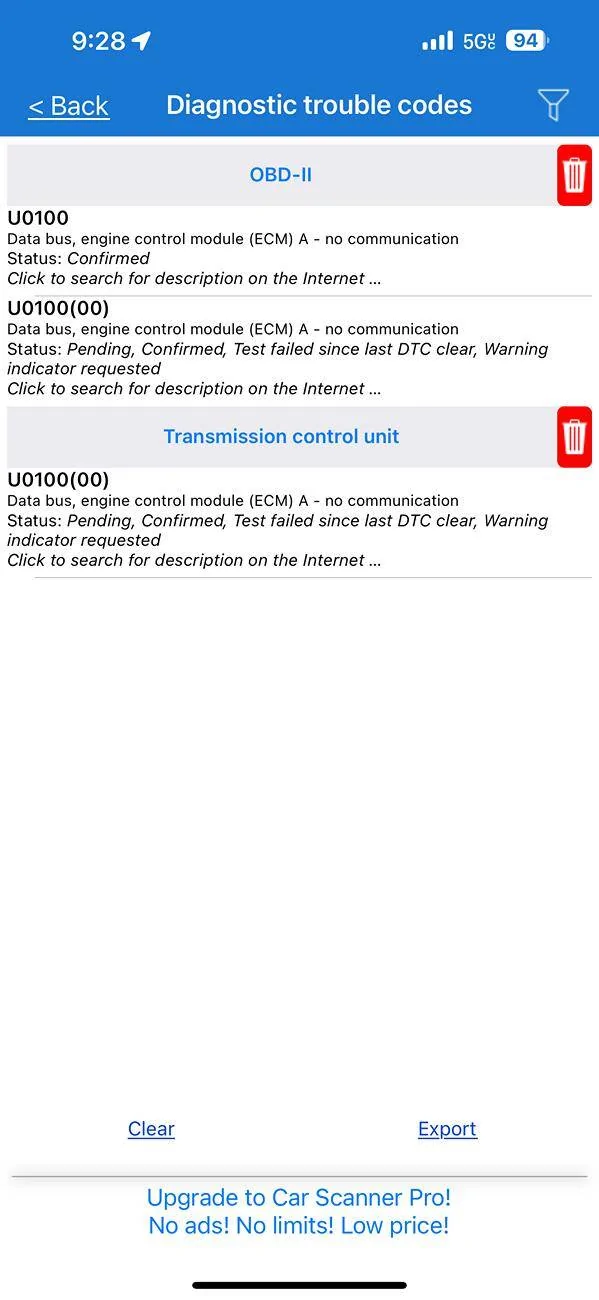

Badkarma
James
Jan 2, 2024
Phx
2018 jlu
Wife went to start the Jeep this morning. She said “brake pedal wouldn’t budge” and it made a clicking noise.
I came home and assumed it was a dead battery and used the noco to jump the battery. It started right up. After the fact I checked the engine codes and found the U0100 code several times. Haven’t had an issue since the jump. I also checked the can-bus and pushed everything down. Nothing jumped at me as needing re-seating though.
