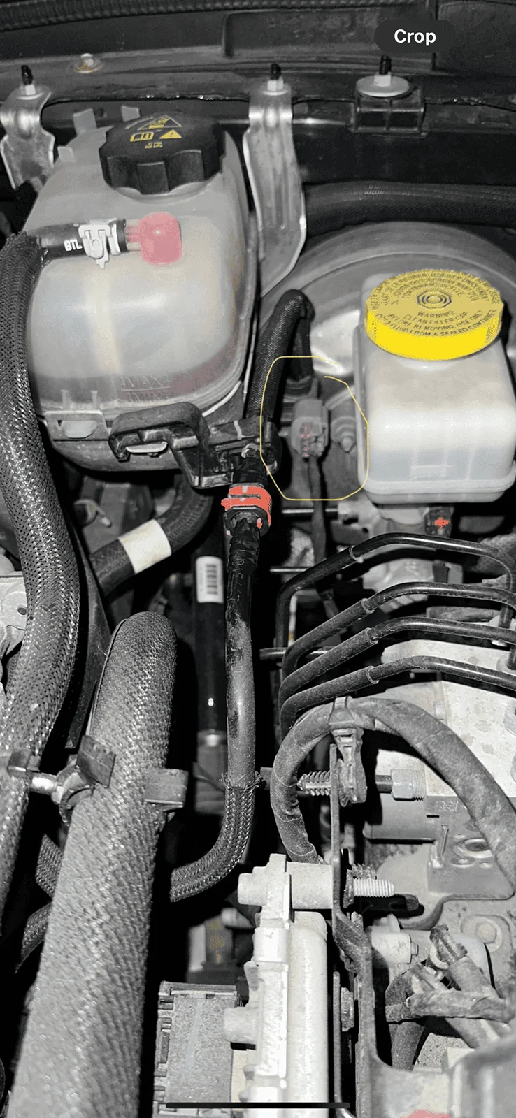

Replaced the first vacuum line and did not solve the problem. Now looking to replace the second vacuum line next to the coolant. Does anyone know how to take off this sensor from the hose? Dont want to break it. Would appreciate the help.

Just thought to share how I was able to fix the issue. I first replaced the vacuum hose but that did not fix the problem. The problem was fuse F35. Replaced it and issue fixed.
