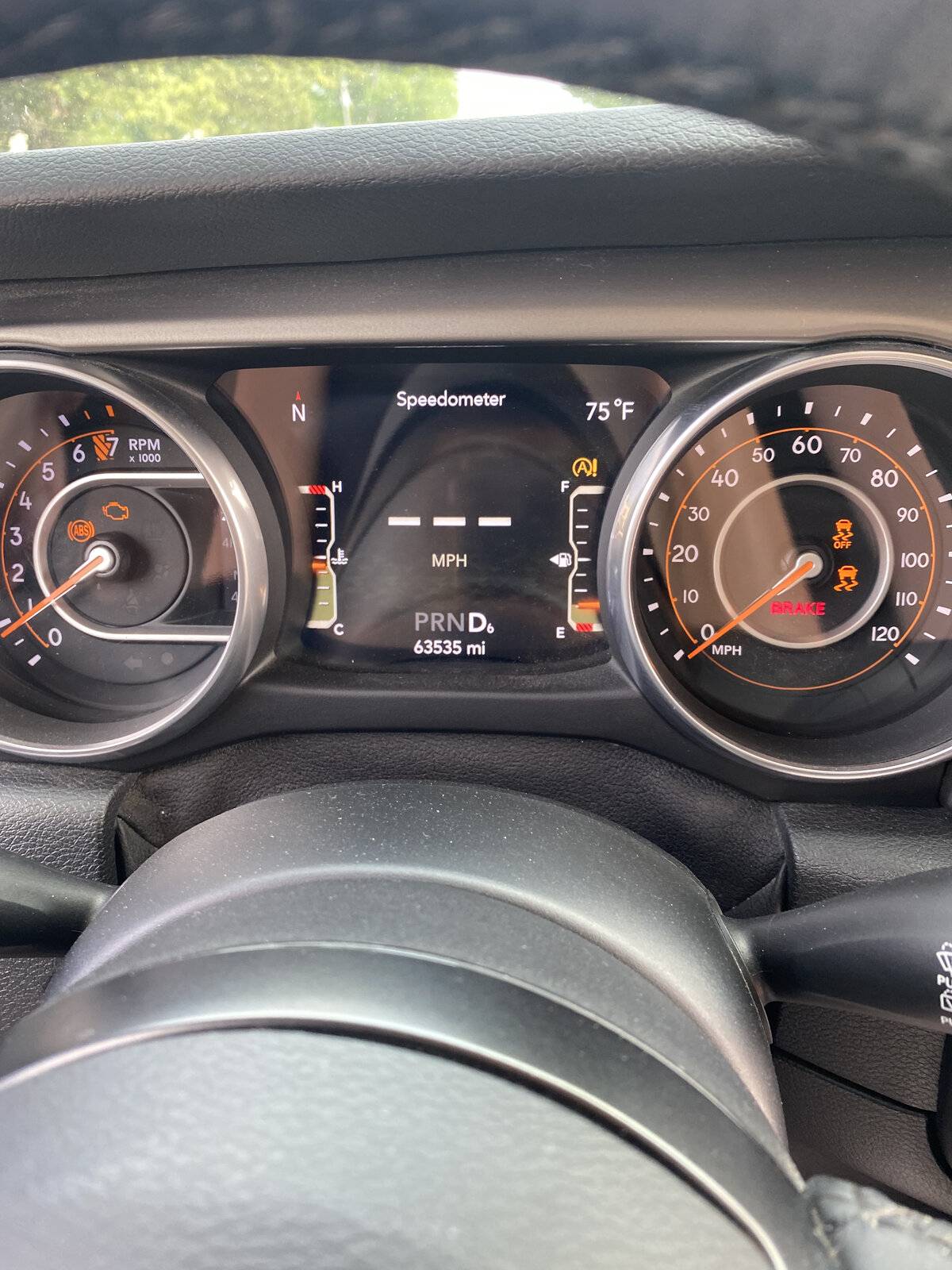

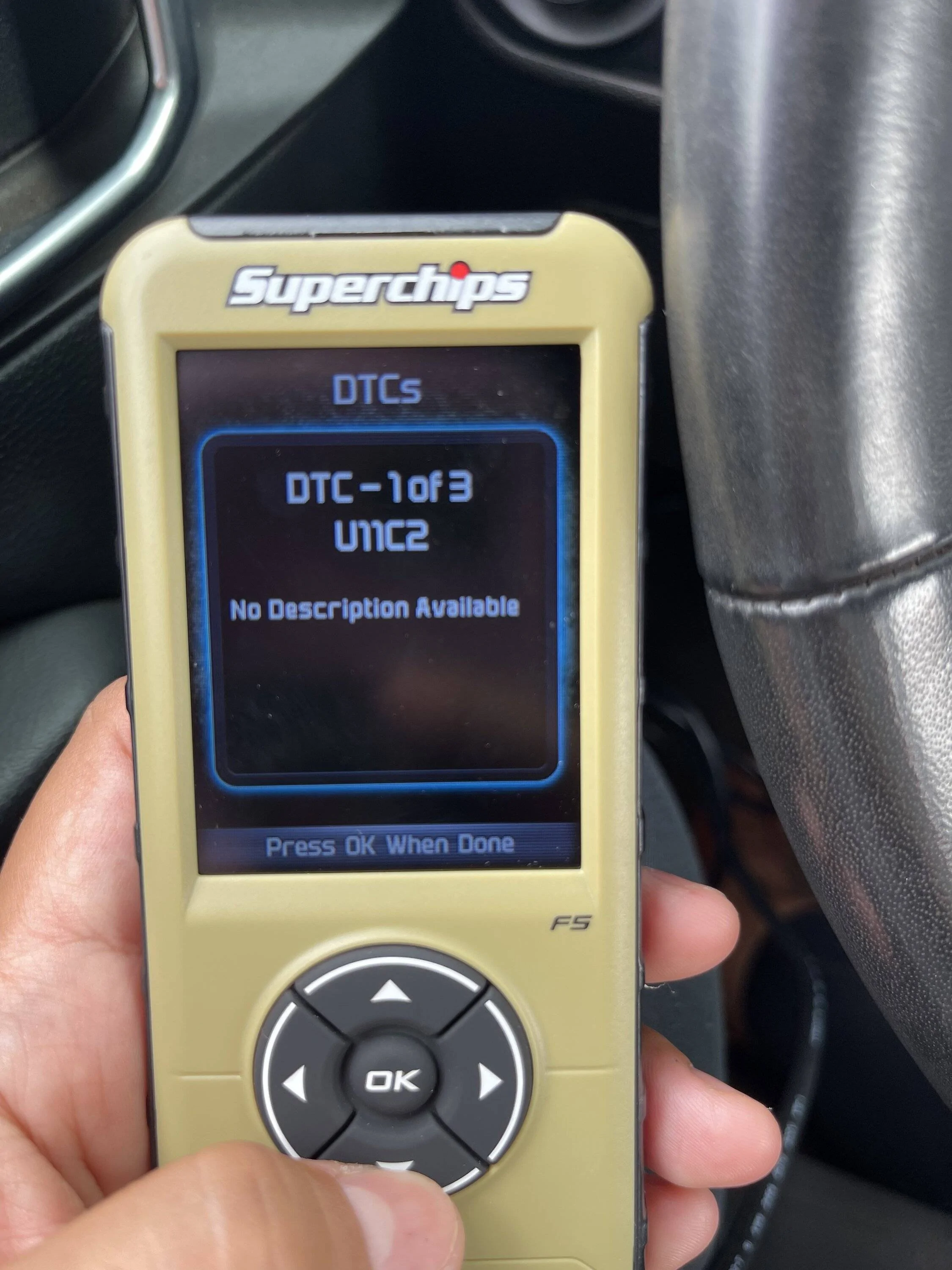

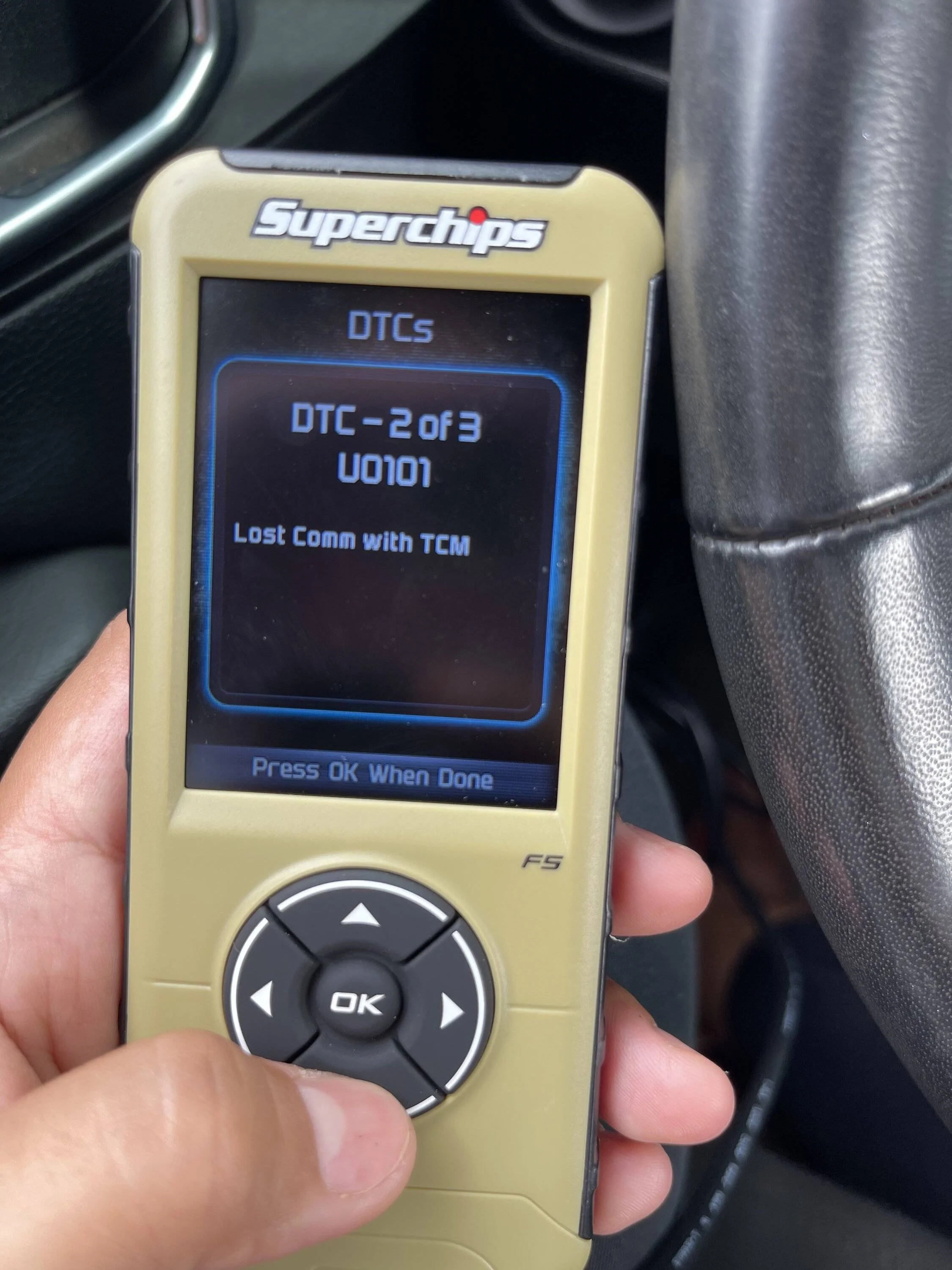

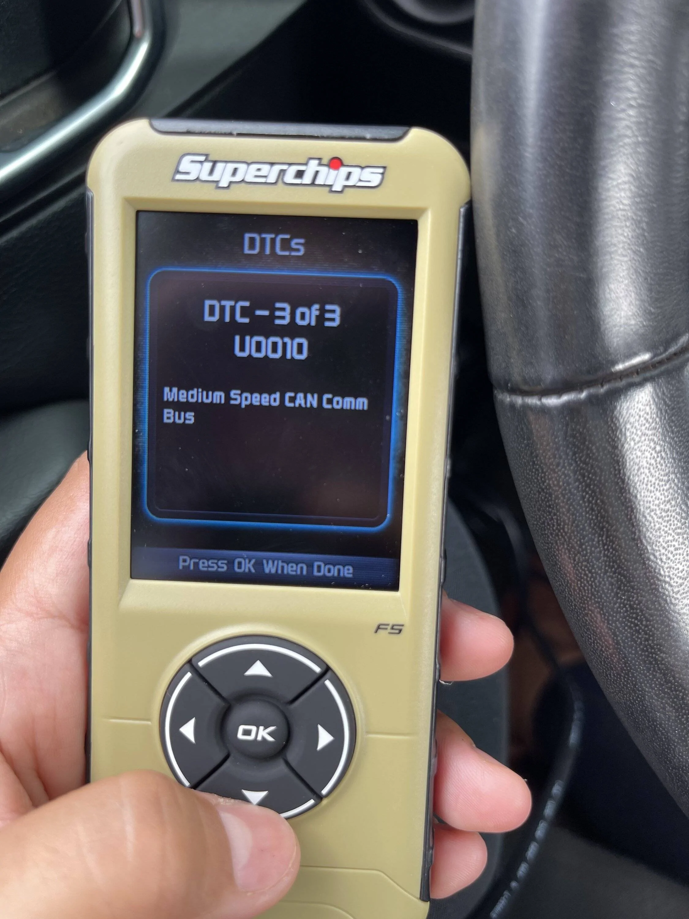

I just drove the jeep agin and it did the same thing. This time I had my super chips flashcal and read the dtc codes. U11C2 is a lost transmission message so I’m assuming it might be something wrong with the wiring from the PCM to transmission. What do you think?

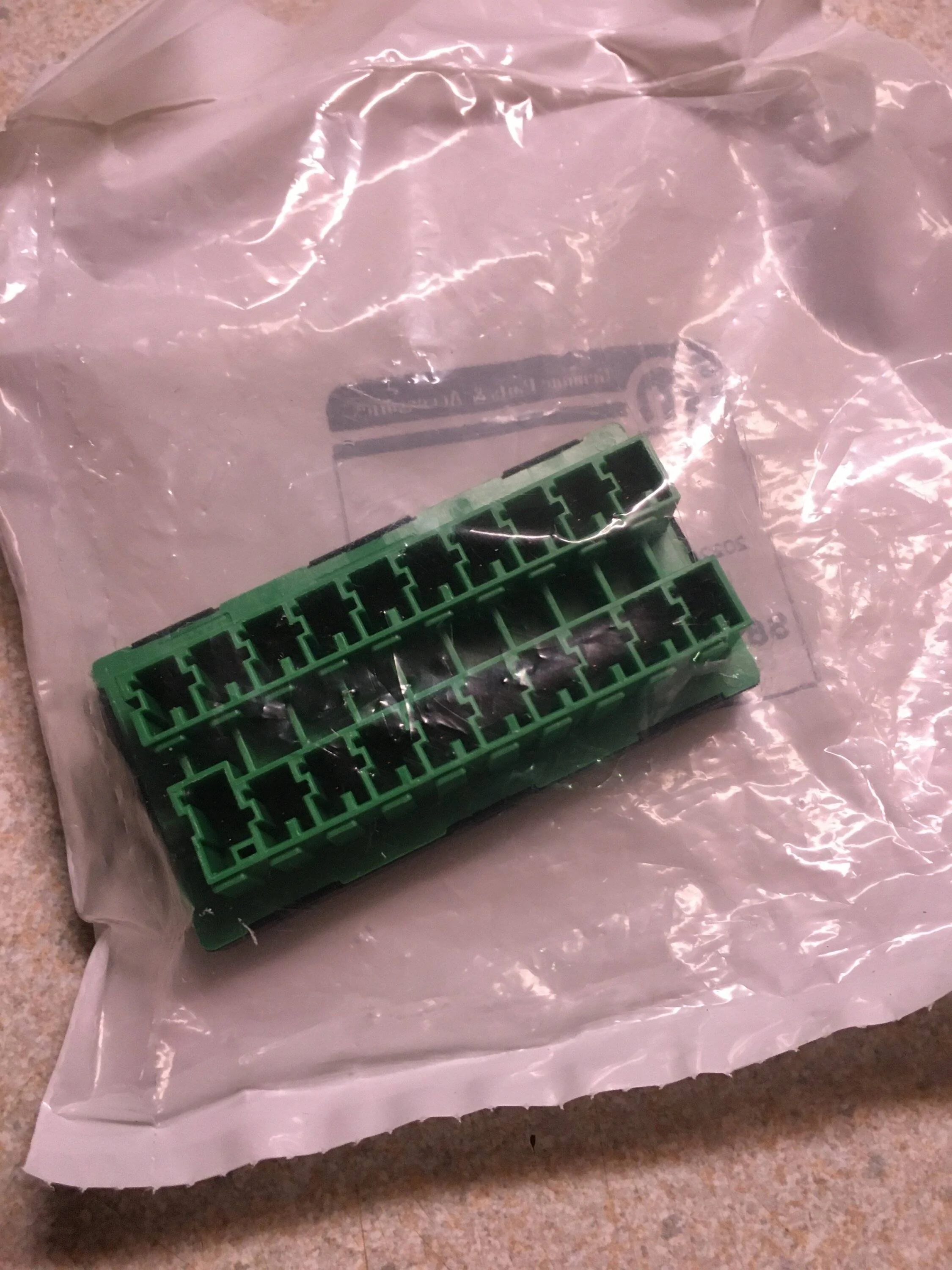

I think you need a valve body, or you have a bad connection between the two.
Seems like a bad canbus connector has been relatively common on the JL. They're cheap.
