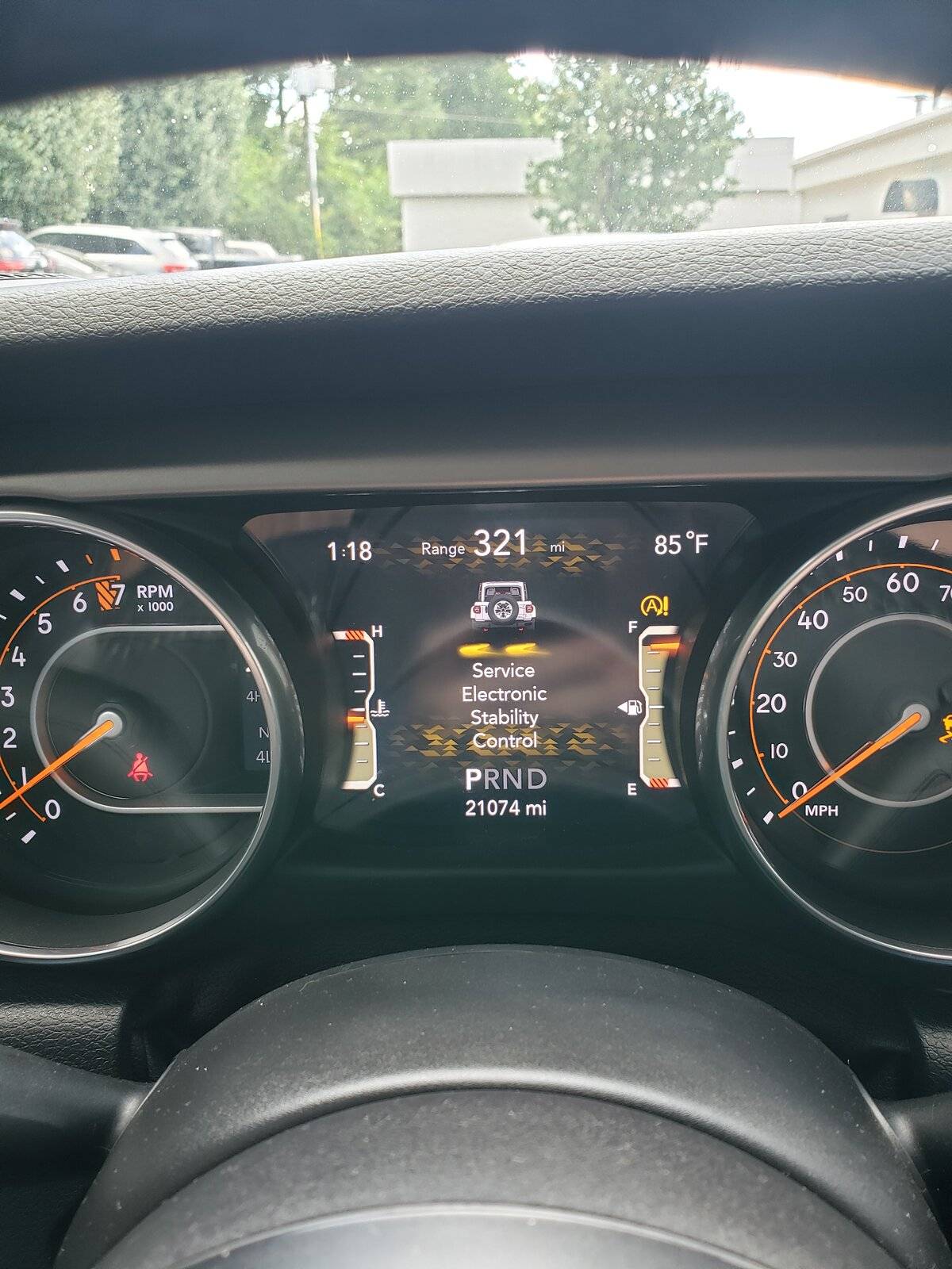

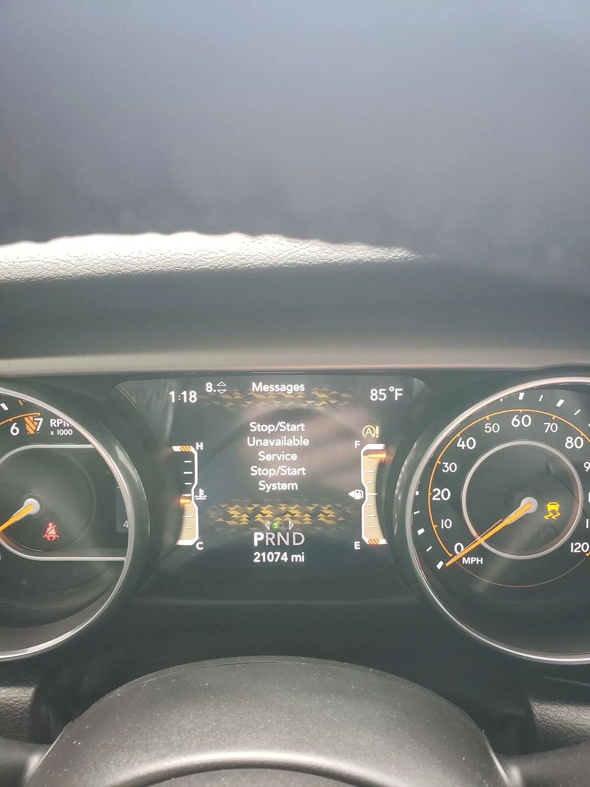

I guess I'm joining the service electronic stability control, start /stop error club.
Dealer replaced the ABS module and start stop battery yesterday. Both errors popped up today. Brought it in today so the dealer could read the codes, and they said it gave a vacuum error. Couldn't leave it with them today since they couldn't give a loaner and I had my son with me. Back to the dealer first thing tomorrow morning. .. I'll show them the TSB
(2018 JLU with 21k miles)

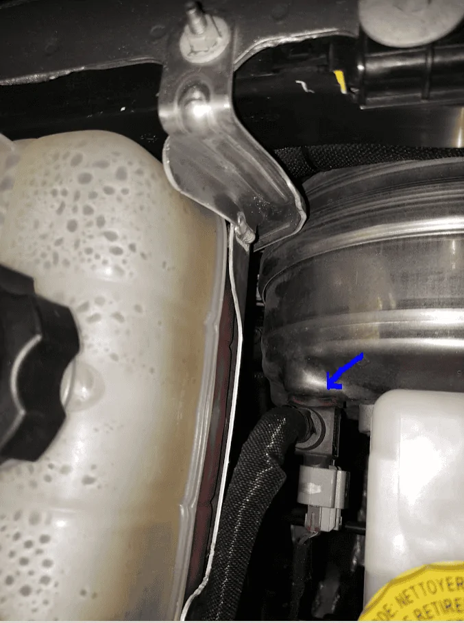

Hello, Can anyone let me know if its normal for the rubber seal on the brake booster to leak when you gently move the vacuum hose or touch the seal?
Brief timeline of my ESS & ESC issues on my 2018 JLU:
• Sept 1st, Intermittent ECS and ESS dash lights. Was told that it was a ABS code. and the ABS module was ordered.
• Sept 13th, the ABS module and AUX battery were replaced.
• Sept 14th. Both Service ESS and ESC came on again. The dealer was able to pull the codes and said it showed a Vacuum issue.
• Sept 15th. I provided the TSP that was mentioned by several people with the same issue on the forum. The Dealer said they updated the ECU, nothing was mentioned about the vacuum error code, or the TSB concerning the front vacuum pump etc.
• Five days later the code for the Service ESC is back.
• Wanted to drive my Jeep for a while, so I waited until Oct 18th to leave my Jeep at the Dealer. They said that the front vacuum pump had failed. 21920, C1252 found in the pcm. Jeep was at the dealer for 5 days. Picked it up and noticed that the new vacuum pump was cycling on and off constantly. About a mile down the road, both the service ESS and ESC lights came back on. Brought it back to the dealer the next day and the tech said that they would need to order an ECU. 5 days later the part arrived, but it was the ABS module again. The dealer said that the tech had said ECU.. but actually meant ABS.... I have another appointment on Monday to have the ABS module replaced again??
Both codes and the constant vacuum pump cycling have been happening on daily since the new vacuum pump was installed. Prior to that it was once every 3 days or so.
The strange part is that over the past two days, we’ve had temps drop down into the 40-50’s and since the weather has cooled down, I can sometime drive for 20-30 minutes without hearing the pump cycle or have the codes?? Today I decided to follow the vacuum lines running from the new pump and noticed that the slightest movement of the line leading into the Brake booster would hiss air if I touched it. Right at the rubber seal. Is this normal?? At this point grasping at straws trying to find out what is causing the codes and the constant cycling of the pump. Its pretty clear that the dealership doesn’t know what is going on either… Any help appreciated. I am working with Jeep Cares and they seem to be as frustrated with the issue as I am.. They have followed up with the service department and had questioned the ABS being replaced twice in the past 30 days as well..
