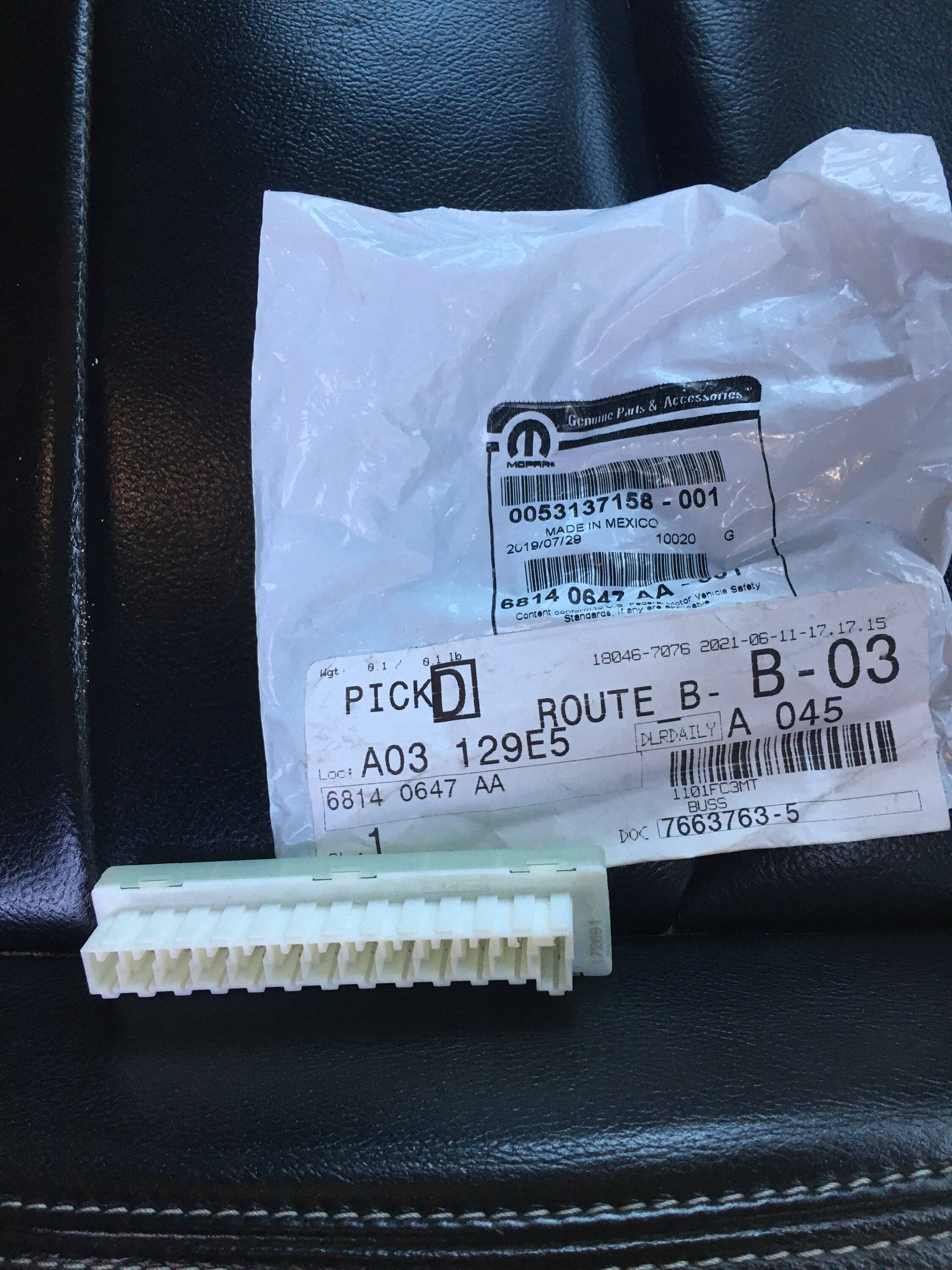

Replaced this, I’ve also heard it called a star connector.
Jeep Wrangler JL Electrical issues image
The connections are solid but did not apply any grease. I’ve not run without fender liners. As the alternator fix didn’t work for sumner409 I believe it’s an electrical connection, short or possibly programming (as it started after a Steering TSB update / flash).

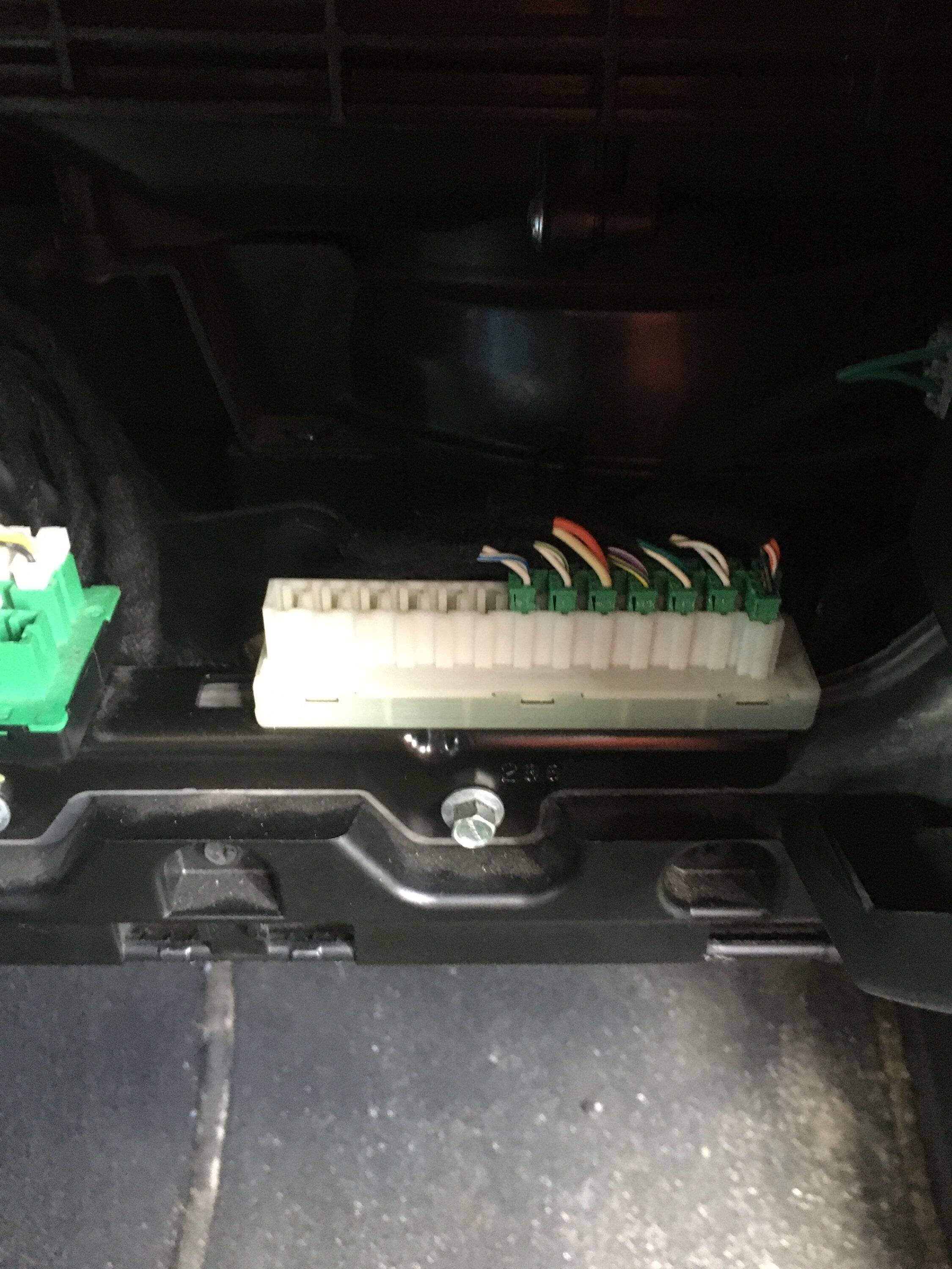

Hey JBW, the white star connector is behind the glove box as shown, when the issue happens I reach over and push the 1st 3 green connectors, the alarms stop, stopping & restarting resets the power steering / takes it out of limp mode.
Some have been applying dielectric grease to the connectors. I assume it keeps the plugs seated but I don’t like that isn’t conductive. I feel like there should be a better fix but I’m probably just being stubborn.
Dielectric grease will help prevent small particulates (i.e. dirt, dust, salt, etc.) and liquid intrusion in the connectors.
The connector will still have plenty of contact for conducting electricity.
It's not a bad thing to have in a repair kit, and generally a decent thing to put into a plug exposed to the elements if you're already performing maintenance on it, etc.
