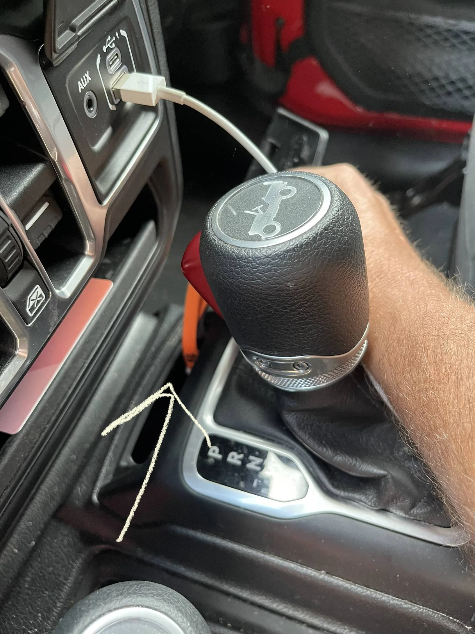

If it is stuck in park there is a fix. This strap is located under a plastic cover at the front of your shifter. Make sure your brake is on; if you pop off the cover and pull the strap it will disengage your Shifter/trans. I was told this feature is so you can have you jeep towed. Once you pull the strap the "P" on the shifter will flash. Pull this strap again and it will lock back in place once you let it go. Now you should be able to restart and shift into gear. I have had to do this a few times while we figure this mess out!

Videos are in the wrong order
Thank you Sir, I learned that from the previous tow truck driver lol but not funny really…
