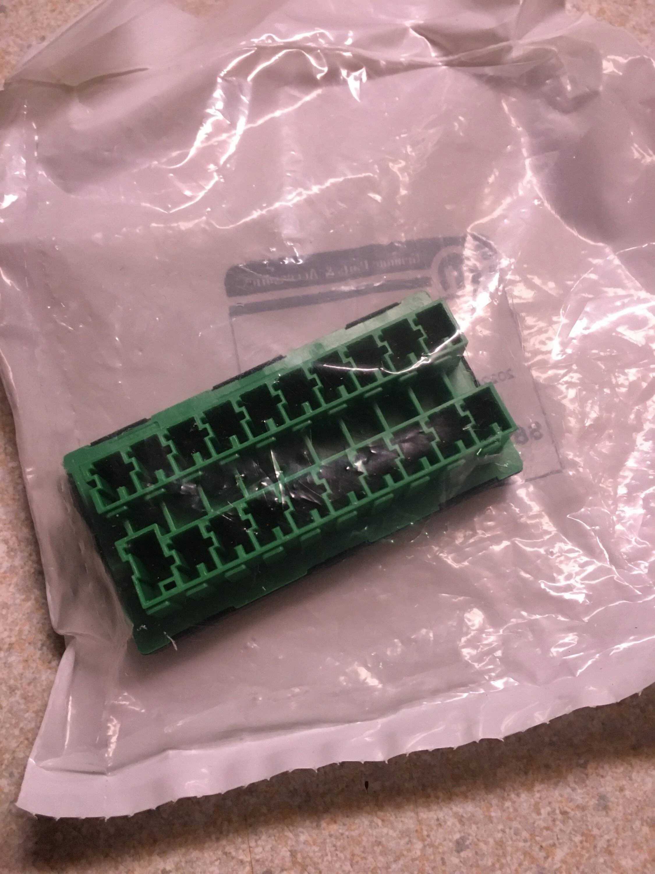

Hi it’s not the smaller clear bus closer to the passenger door, thats for the infotainment and the control panel under it. I replaced the green and black bus beside it. Try going up to 2022 and above models, in one of those years it started selling separate from the harness, that’s what I’ve come to believe. My local dealer parts guy found it that way.

I had a green double-row can bus with 10 inputs on each row for a total of 20. Gave them the VIN# and said it was wrong and gave me a 13-input single-row unit. So I demanded the double row and showed them a pic of mine. So identifying what they actually put in our Jeeps is a guessing game.

If you go to post #56 it shows the part # for the green/black high speed bus. It seems some dealers can’t find the part# on the earlier JL models, some can. I think you have to go to a 2022? To find this part. Give it a try.
